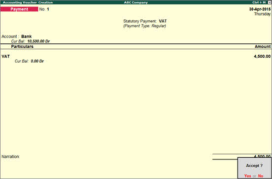

9. Enter the relevant details in the Bank Allocations screen. The payment voucher appears as shown below:
10. Press Enter to accept and save.
