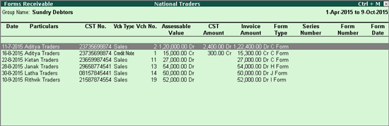

Forms Receivable report displays the date of transaction, CST Sales ledger used, gross amount inclusive of CST, form types, and also contains three additional fields, form's Series Number , Form Number and Form Date , which have to be filled when the prescribed forms are received from the purchasing dealer or the customer.
Usually, this report is generated at the end of a financial year or month end (in specific cases). However, Tally.ERP 9 facilitates the generation of this report at any point of time.

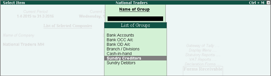

1. Select Group in the Forms Receivable menu as shown below:
2. Select the required group from the List of Groups as shown below:
The Forms Receivable screen for the selected group appears as shown below:

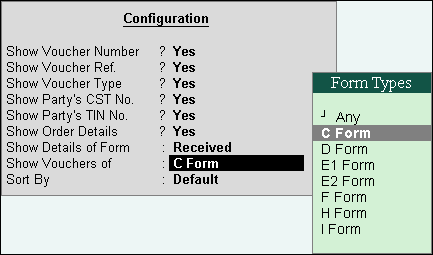

3. Click F12: Configure and enable the required options as shown below:

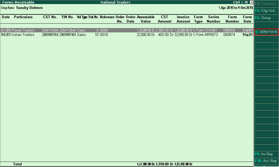

The Forms Receivables report now displays details as per the specified configurations. If it is required to enter or alter form series number, form number and form date, a button S : Set/Alter Form No is provided as shown below:
Note: In Group-Wise Forms Receivables report, the form's Series Number , Form Number and Form Date s for all the inter-state sales made to all the Sundry Debtors can be entered in a single screen. In case of ledger-wise report, the required party ledger can be selected and the details pertaining to F orm Series Number , Form Number and Date can be specified.

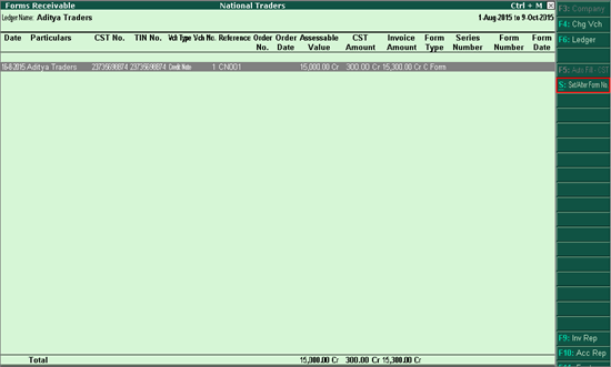

Ledger-Wise Forms Receivables Report
1. Press Enter on Ledger in the Forms Receivables menu to view the list of Ledgers as shown below:
2. Select the required Ledger .

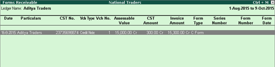

The Forms to be received for the selected ledger are displayed in the Forms Receivable screen.

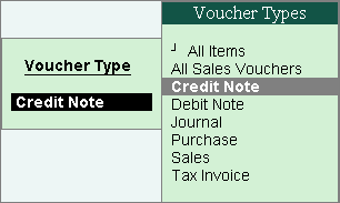

Change Voucher
In the Ledger-wise Forms Receivable screen, F4: Chg Vch button is provided to view vouchers of a particular voucher type.
● Click F4: Chg Vch to view a list of voucher types and select the required voucher type.
The Forms Receivable screen of the selected voucher type appears as shown below:
● Click F12: Configure and enable the options as required.
Set Form Number
To enter the form's series number, form number and form date
1. Click S : Set/Alter Form No. in the buttons bar.
2. Enter the form details.
3. Press Ctrl+A to save.
Similarly, select the other required ledgers to specify the form number along with date and accept the details.
