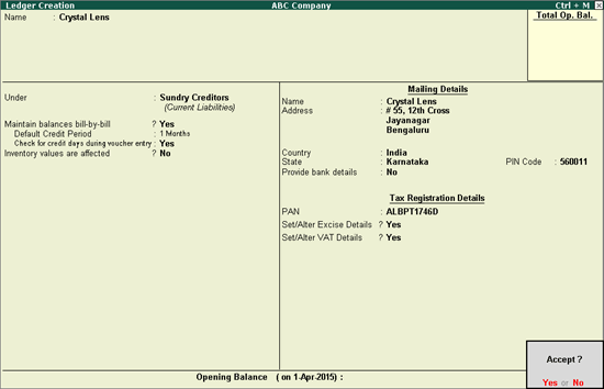

You can create a party ledger by entering the excise details.

The ledger appears as shown below:
16. Accept the Ledger Creation screen.
