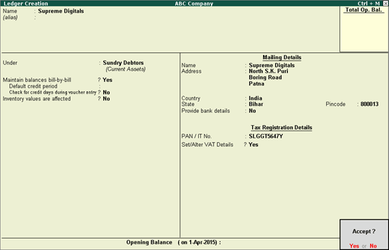

Customer Ledger
2. Enter the Name of the customer ledger.
3. Select Sundry Debtors as the group name in the Under field.
4. Set Maintain balances bill-by-bill? to Yes .
5. Enter the Default credit period , if any.
6. Set Check for credit days during voucher entry? to Yes , if required.
7. Set Inventory values are affected? to Yes , if required.
8. Enter the Mailing Details .
9. Select the required Country .
10. Select the required State .
11. Enter the Pincode .
12. Set the option Provide bank details to Yes to select the Transaction Type , if required.
13. Enter the PAN or IT number.
14. Enable the option Set/Alter VAT Details? . In the VAT Details screen,
● Select the Type of Dealer from the Type of Dealer list as shown below:
Note: If the Type of Dealer is selected as Regular and VAT TIN No. field is left blank, the warning message TIN is blank . is displayed.
● Enter the VAT TIN No. and CST No.
● Press Enter to save.
15. Press Enter to save.
Note: For interstate transactions, you can create ledgers for suppliers and customers belonging to other states.
