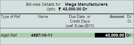

5. In Bill-wise details screen select the bill towards which the payment is made.

The completed Payment Voucher appears as shown:
8. Press Enter to save
