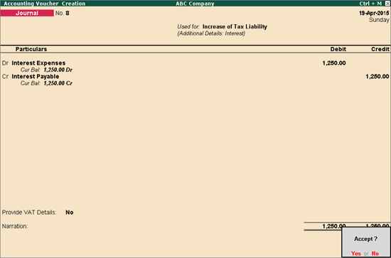

7. Enter Narration , if required. The journal voucher appears as shown below:
