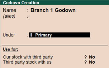

Create Godowns/Locations
When you create a Godown/Location in Tally.ERP 9 for the first time, you are prompted to alter the existing internal godown ( Main Location ), where all your inventory is stored by default.
1. Gateway of Tally > Inventory Info. > Godown > Single Godown > Create .
Note: If you do not see the Godown option in Gateway of Tally, press F11 (Features) > Inventory Features > and set Maintain multiple Godowns: Yes .
2. Name & alias : As in other masters, you can specify multiple aliases for the godown name.
3. Under : Select Primary or an existing godown.
What you see on the screen can vary based on your choices. Press F12 (Configure) to change the options.
Note: As in the case of other ledgers and groups, Primary is the root folder under which you can create a godown. The Main Location under Primary is an internal godown where Tally.ERP 9 maintains all your inventory by default. If you create a godown under Primary, it is created at the same level as that of Main Location. If you select Main Location, it becomes the parent godown for the godown you create.
Click to see the F12 configurations for godowns .
4. Accept the Godown master. As always, you can use Ctrl + A to save.
As in all other masters, you can create godowns on the fly by using Alt + C or move back and forth using Page Up and Page Down . See more >>

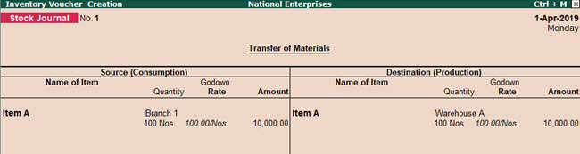

Transfer Inventory Between Godowns/Locations
You can move your stock from one Godown/Location to another using Stock Journals. In case you are into manufacturing or job work, Tally.ERP 9 provides the flexibility to use specific voucher entry modes of Stock Journal to record transfer of materials between godowns.
1. Gateway of Tally > Inventory Vouchers > Alt + F7 (Stock Journal).
2. Under Source (Consumption) , specify details of the stock items that you want to transfer.
â—Ź Select the stock item and the godown from where you want to transfer.
As always, you can create stock items and godowns on the fly by pressing Alt + C .
â—Ź Enter the Quantity if the stock item has UoM defined. Rate will be auto-filled from the stock item master, if available. However, you may choose to enter the Rate or Amount .
You will need to enter the Amount if the stock item has no UoM defined.
3. Under Destination (Production) , specify details of the stock items.
â—Ź Select the stock item and the destination godown. For inter-godown transfers, select the same stock item as in the Source .
â—Ź Provide Quantity , Rate , or Amount , as needed.
Note: You can also select a different stock item as finished goods in case the source stock item is changing form, especially in case of manufacturing. For more information, refer to Manufacturing Journal Voucher .
What you see on the screen can vary based on your choices. Press F12 (Configure) to change the options and F11 (Features) to enable or disable features.
4. Accept the voucher. As always, you can use Ctrl + A to save.
