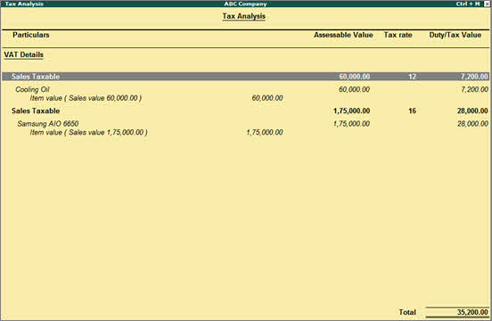

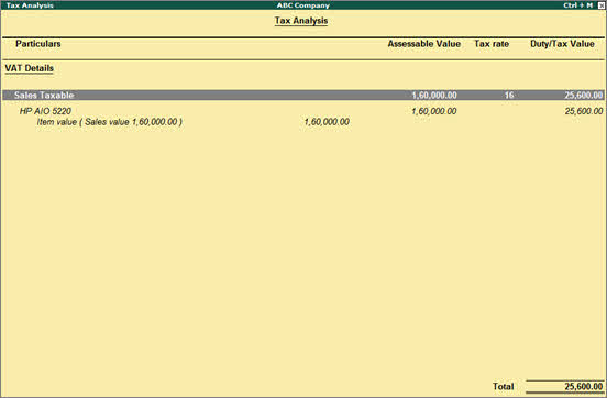

7. Click A : Tax Analysis button to display the Tax Analysis screen. Click F1 : Detailed button to view the name of stock item. The Tax Analysis screen in detailed mode appears as shown below:
8. Press Esc to return to sales invoice.

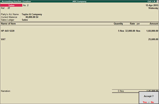

9. Press Enter . The sales invoice appears as shown below:
10. Press Enter to save.

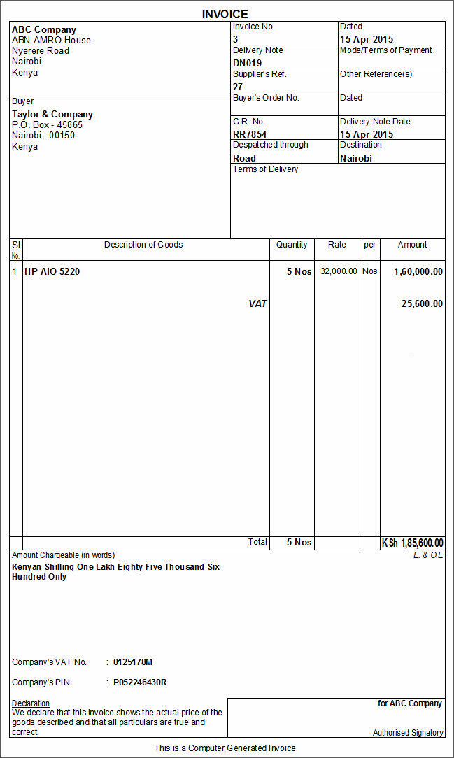

Printing Sales Invoice
To print sales invoice
1. Press Page Up after saving the sales invoice to open the invoice in alteration mode.
2. Click P : Print to display the Voucher Printing screen.
3. Press Enter to print. The print preview of sales invoice appears as shown:
Note: Click I : With Preview in the Voucher Printing screen to view the preview before printing.

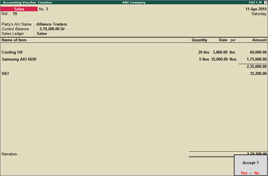

Sales with multiple tax rates
While using a common VAT ledger in sales invoice, the tax amount for each item is calculated based on the rate of the respective item as shown below:
The sales invoice with multiple items attracting different tax rates and commom VAT ledger appears as shown below:
