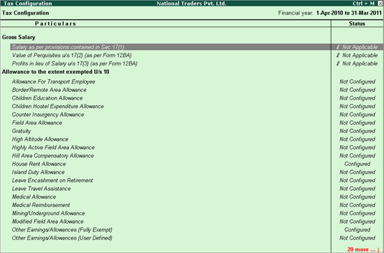

To view the Tax Configuration screen
● Go to Gateway of Tally > Payroll Info. > Income Tax Details > Tax Configurations .
You can drill down into each component, and make the required changes.

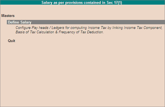

Salary as per provisions contained in Sec 17(1)
1. Select Salary as per Provisions contained in Sec 17(1) , and press Enter.
2. Press Enter on Define Salary.
You can configure the pay heads and ledgers to select the appropriate Income Tax Component, Tax Calculation Basis and Deduct TDS Across Period(s) as explained in the Pay Head Configuration screen.

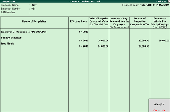

Details of Perquisites
1. Select Value of Perquisites U/s 17(2) (as per Form 12BA) in Tax Configuration screen, and press Enter
2. Select Single Employee or Multi Employee to define perquisite details for a single employee or all employees respectively.
Single Employee
1. Select Single Employee from above screen, and press Enter.
2. Select an e mployee from the List of Employees , and press Enter.
3. In the Perquisites screen,
● Select the required allowances in the Nature of Perquisites field.
● Specify the date from when the perquisites are applicable, in Effective From field.
● Enter the perquisite amount in the Value of Perquisites Computed Value field.
● Specify the Amount If Any Recovered From the Employee . If nothing is recovered, leave this field empty.
● The Amount of Perquisite Chargeable to Tax is displayed, by default.
● Specify the Amount on which Tax is Paid by Employer .
4. Press Enter to save.

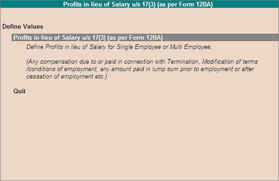

Details of Profits in lieu of Salary
1. Bring cursor, on Profits in lieu of Salary u/s 17(3) (as per Form 12BA) in Tax Configuration screen, and press Enter .
2. Select the required e mployee or All Employees.
3. In Effective From field, specify the date from when the Profits in Lieu of Salary is applicable.
4. In Amount Chargeable To Tax , specify the value which is paid to the employee as profit on which tax has be paid by the employee.
5. Press Enter to save.

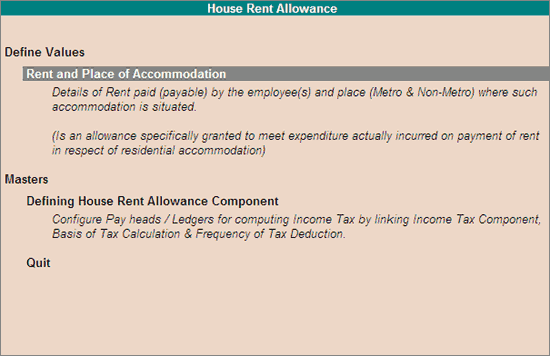

Details of Allowances U/s 10
1. Select the required allowance under Allowances U/s 10 in Tax Configuration screen, and press Enter .
2. Drill down on Define Values to enter the declaration details for selected allowance, as explained in Declarations menu.
3. Drill down on Masters to configure pay heads for the required income tax component, as explained in the Pay Head Configuration menu.

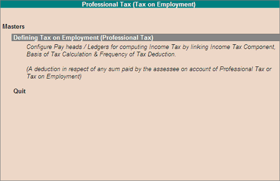

Deductions U/s 16
1. Select Entertainment Allowance or Professional Tax under Allowances U/s 10 in Tax Configuration screen, and press Enter.
2. Press Enter to configure the pay head/ledger for the selected allowance or tax. This is similar to Pay Head Configurations discussed earlier.

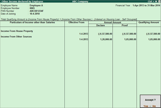

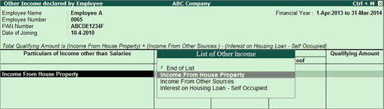

Other Income Declared by Employees

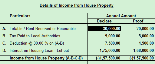

1. Select either Other Income (House Property / Other Sources) under Other Income declared by Employee in Tax Configuration screen, and press Enter
2. Select the required employee from the List of Employees.
3. Select the Particulars of Income Other than Salary - Income from House Property from the list.
4. Specify the Effective From date.
5. Specify the Details of Income from House Property . Based on the details provided the income from house property is calculated.
6. Follow a similar process for the other incomes that are applicable.
7. Press Enter to save.

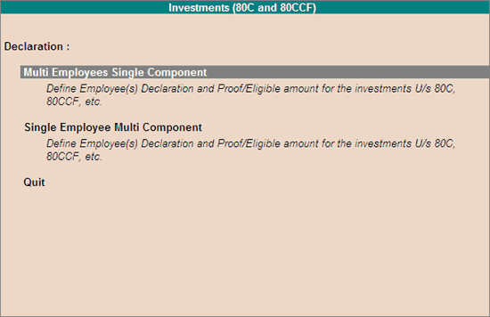

Deductions Under Chapter VI-A
1. Investments
1. Select either Investments (80C and 80CCF) under Deductions under Chapter VI-A in Tax Configuration screen, and press Enter .
2. To add investment declarations for all employees, select Multi Employee Single Component and follow the process explained in Investments - Multi Employee Single Component .
3. To add investment declarations employees one by one, select Single Employee Multi Component , and follow the process explained in Investments - Single Employee Multi Component .

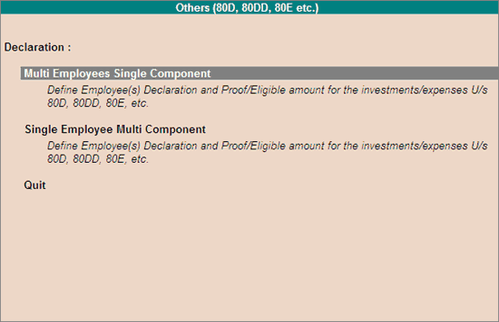

Other Deductions
1. Select either Others (80D, 80DD and 80E etc.) under Deductions under Chapter VI-A in Tax Configuration screen, and press Enter.
2. To add Others declaration for all employees, select Multi Employee Single Component , and follow the process explained in Investments - Multi Employee Single Component .
3. To add Others declaration for employees one by one, select Single Employee Multi Component, and follow the process explained in Investments - Single Employee Multi Component .

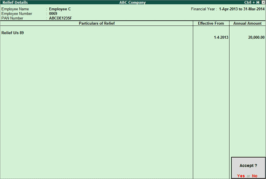

Details of Relief's granted
1. Select Relief (U/s 89, 90 & 91) in Tax Configuration screen, and press Enter.
2. Select the required employee from the List of Employees , and press Enter.
3. Select the required Section from Relief list under the Particulars of Relief.
4. Enter the start date in the Effective From field.
5. Specify the relief amount in the Annual Amount field.
6. Press Enter to save.

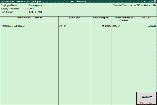

1. Advanced Tax Declared by Employee
1. Select Advanced Tax Declared by Employee in Tax Configuration screen, and press Enter
2. Select the required employee, and press Enter .
3. Specify the details of the advance tax paid.

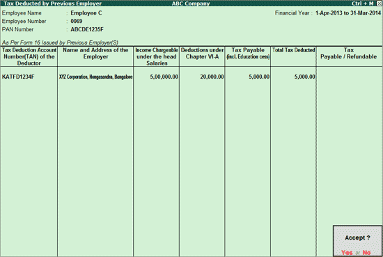

Tax Deducted by Previous Employer
1. Bring cursor, on Tax Deducted by Previous Employer in Tax Configuration screen, and press Enter.
3. Specify the details of the Tax Deducted by Previous Employer .

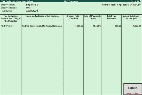

Tax Deducted Other than Salary
1. Select Tax Deducted Other than Salary in Tax Configuration screen, and press Enter
3. Specify the details of deductor, as shown below.

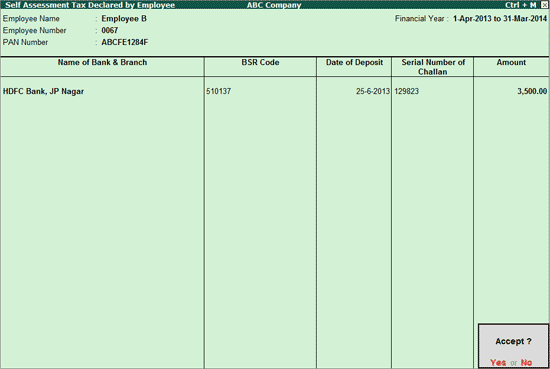

Self Assessment Tax Declared by Employee
1. Bring cursor, on Self Assessment Tax Declared by Employee in Tax Configuration screen, and press Enter .
3. Press Enter to save.
