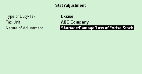

2. Click J : Stat Adjustment button. The Stat Adjustment Details screen is displayed.
3. Select the Type of Duty/Tax as Excise .
4. Select the Tax Unit from the list.
5. Select the Nature of Adjustment as Shortage/Damage/Loss of Excise Stock .

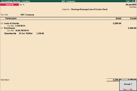

8. Press Enter to view Inventory Allocations screen. In the Inventory Allocations screen, select the name of the item and press Enter to view the Supplier Details screen and provide the details.
9. Provide details in Stock Item Allocations screen and accept the screen. The item details are displayed in Inventory Allocations screen.
10. Accept the journal voucher.
