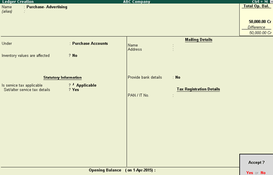

Creating Purchase Ledger
Click the image below to view the step-by-step procedure of creating a purchase ledger:

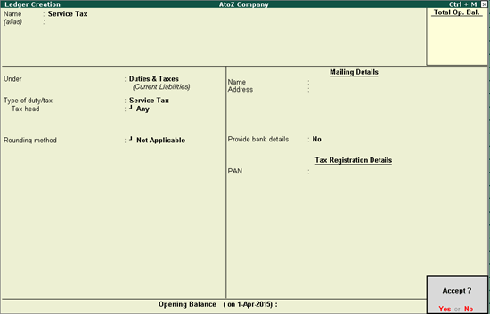

Creating Service Tax Ledger
Create a service tax ledger as shown below:

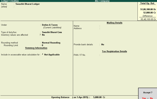

Creating Swachh Bharat Cess Ledger
Create a Swachh Bharat cess ledger as shown below:
Note: If you have created a Swachh Bharat cess ledger with the Type of duty/tax as Others , you can change the same to Swachh Bharat cess .

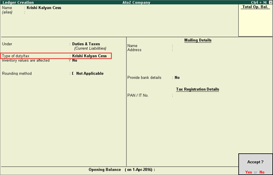

Creating Krishi Kalyan Cess Ledger
Create a Krishi Kalyan cess ledger as shown below:
Press Enter to save.

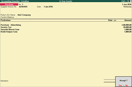

Recording purchases using tax rates defined in ledger
On selecting the service tax, Swachh Bharat cess, and Krishi Kalyan cess ledgers in the transaction, the service tax, Swachh Bharat cess, and Krishi Kalyan cess values are calculated as shown below. Click the image below to view the step-by-step procedure for recording a service tax purchase transaction:
