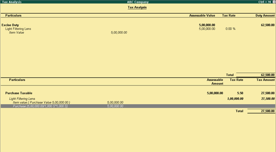

On 02 April 2015, ABC Company purchased light filtering lens from Crystal Lens. The stock items were delivered to a godown, which is linked to the excise tax unit ABC Company II.
The stock item details are as below:
Stock Item
Quantity
Rate
Light filtering lens
Rs. 2000/ S
To record the purchase transaction
1. Go to Gateway of Tally > Accounting Vouchers > F9: Purchases
2. Enter Supplier Invoice No . and Date .
3. Select ABC Company II as the Tax Unit .
4. Select the party ledger and purchase ledger.
5. Select the stock item (principal unit), and enter the quantity and rate.
6. Select the ledger Excise Duty .
7. Select the ledger Input VAT .
8. Click A : Tax Analysis .
9. Press Esc .
The completed purchase invoice appears as shown below:
10. Press Enter to save.
