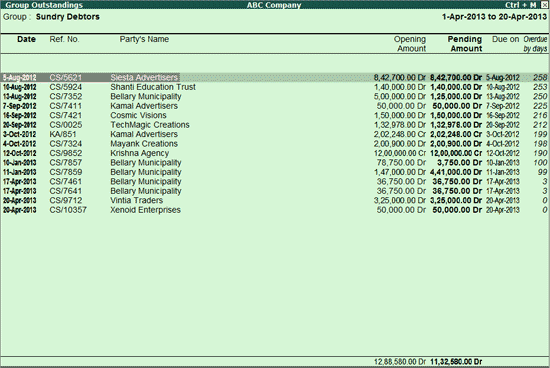

This report displays the outstanding receivables or payables during a specified period for an entire group - Sundry Creditors or Sundry Debtors .
To view the Group wise receivables Report
1. Go to Gateway of Tally > Display > Statements of Accounts > Outstandings > Group .
2. Select the Group from the list. The Group Outstanding report is displayed as shown below:
