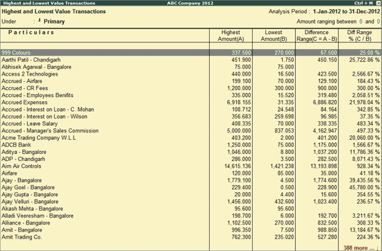

The Highest and Lowest Value Transactions report provides ledger-wise Highest and Lowest amount transactions along with the Difference Range and Difference Range Percentage.
View Highest and Lowest Value Transactions report
1. Go to Gateway of Tally > Analysis & Verification > Data Analysis > Highest and Lowest Value Transactions .
Note:
1. Difference Range: It is arrived by considering the Highest and Lowest Value Transaction of each ledger. Example: For ABC Bank Ledger,
* Highest Value Transaction is 1000
* Lowest value transaction is 200
Difference Range of ABC Bank (800) = Highest Value (1000) - Lowest Value (200)
2. Difference Range Percentage: It is arrived by dividing the Difference Range by Lowest value of a Ledger. Example: For ABC Bank Ledger,
* Difference Range is 800
Difference Range Percentage of ABC Bank (400%) = Difference Range (800)/ Lowest Value (200)
The report displays the Highest Transaction Amount , Lowest Transaction Amount , Difference Range and Difference Range Percentage of all Ledgers. Users can drill down from the above report to view ledger-wise Highest and Lowest Value Transactions.
2. Select a Ledger and press Enter to view the Ledger-wise Highest and Lowest Value Transactions report .
The basis for display of Highest and Lowest transactions for a ledger is also displayed on top of the screen.
Note: To display the Highest and Lowest Value Transactions for a ledger, by default 5 Highest value and 5 Lowest value transactions has been set.

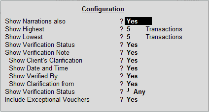

Users can configure the display of Highest and Lowest Transactions by clicking on F12: Configure and alter the numbers to show highest and lowest transactions.

Configuration Options
Click F12: Configure or press F12 to change the default view for the above report.
● Show Narrations also : Set this option to Yes to display the Narration entered by the Client during the Voucher entry.
● Show Highest : Define the Number of Highest Value Transactions to be considered for displaying in the report.
● Show Lowest : Define the Number of Lowest Value Transactions to be considered for displaying in the report.
● Show Verification Status : Set this option to Yes to display the Verification Status as selected by the user during the analysis. This option is set to Yes by default.
● Show Verification Note : Set this option to Yes to display the Verification Note as entered by the user during the analysis. This option is set to Yes by default.
● Show Client's Clarification : Set this option to Yes to display the Clarification Note entered by the user for the Vouchers marked as Need Clarification by the user.
● Show Date and Time : Set this option to Yes to view the date on which, and time at which, clarification was provided for the listed Vouchers.
● Show Verified By : Set this option to Yes to view the person who has performed verification on the Vouchers.
● Show Clarification from : Set this option to Yes to view the user who has provided clarification, if any, for the Vouchers.
● Show Verification Status : Select a Verification Status and the Vouchers that have been marked with the chosen Verification Status will be filtered and displayed.
● Include Exceptional Vouchers : Set this option to Yes to include Vouchers marked as Optional in this report.
