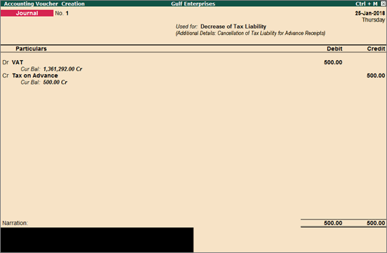

Decrease tax liability

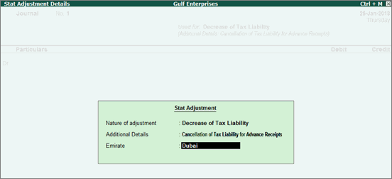

2. Click J : Stat Adjustment .
o Select Decrease of Tax Liability as the Nature of adjustment .
o In the Additional Details field, select the option Cancellation of Tax Liability for Advance Receipts .
o Select the location of the party, with reference to whom the tax liability is being cancelled, in the Emirate field.
o Press Enter to return to the journal voucher.
3. Debit the VAT ledger for decreasing the tax liability. Enter the VAT Rate and Taxable Value in the VAT Details screen.
4. Enter the amount under the Debit column.
5. Credit the current assets ledger grouped under Current Assets .
6. Press Ctrl+A to accept the voucher.

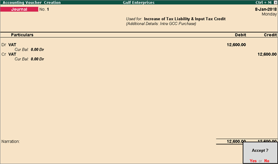

Increase tax liability and input tax credit
o Select Increase of Tax Liability & Input Tax Credit as the Nature of adjustment .
o In the Additional Details field, select the option Intra GCC Purchase .
3. Debit the VAT ledger. Enter the Rate and Taxable Value .
4. Credit the VAT ledger. Enter the Rate and Taxable Value .
5. Press Ctrl+A to accept the voucher.
You can record journal vouchers for increase of tax liability and input tax credit on imports and purchases from designated zones with the following details:
Nature of Adjustment
Additional Details
Ledgers to be used
Imports
Debit - VAT ledger.
Credit - VAT ledger.
Purchase from Designated Zone
Debit - VAT ledger.
