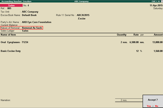

To record the sale of returned goods
2. Click F12: Configure .
3. Enable the options Allow modification of nature of removal and Track Excise Credit Note
4. Select ABC Company as the Tax Unit .
5. Select the Party's A/c Name .
6. Select the Nature of Removal as Removal as Such .
7. Select the stock item.
8. Select the Excise Credit Note No . from the List of Credit Note Vouchers .
9. Press Enter to go to the sales invoice.
10. Select the duty ledger in the sales invoice.
The completed sales invoice appears as shown below:
11. Press Enter to save.
