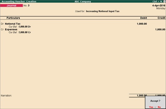

4. Credit the expense ledger grouped under Indirect Expenses . The journal voucher appears as shown below:
5. Press Enter to save.
