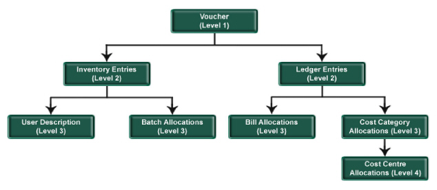

The Structure of a Voucher Object
A Voucher Object stores two types of information: Base Information and Actual Entries.
Base Information consists of base methods like Voucher Number, Date, Reference, Narration and so on, which are common to all the voucher types.
Actual Entries are the entries pertaining to Accounts and Inventory.
The following six collections have been introduced to handle transactions based on the three types of vouchers explained earlier. They are:
● Ledger Entries
● Inventory Entries
● All Ledger Entries
● All Inventory Entries
● Inventory Entries In
● Inventory Entries Out
The hierarchy of Voucher Objects is as shown below:
The base entries of a Voucher are Date, Voucher Type, Voucher Number, etc.
The first level consists of two basic collections, namely Ledger Entries and Inventory Entries. Each Ledger Entry Object has its own Base Methods like Ledger Name, Amount, Bill Allocation Collection and Cost Category Allocation Collection. Each Cost Category Allocation Object in turn, contains its own Methods, which are Name, Amount and a Cost Centre Allocation Collection.
Accounting Vouchers use collections of the following type:
● Ledger Entries
Inventory Vouchers use collections of the following type:
● Inventory Entries
Accounting-cum-Inventory Vouchers use collections of the following type:
● Ledger Entries
● Inven t ory Entries
● All Inventory Entri e s

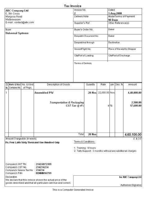

Invoice Customisation – Modifications to default format
There may be a requirement in an Invoice customisation which is similar to the default Tally format with some minor changes. In such cases, one can just alter the default definitions as required.
Case 1
Problem Statement
A Company ABC Company Ltd. requires an Invoice with its Terms and Conditions as shown:
Solution
Step 1: The default configuration Part IPCFG Right is altered to add the Line.
[#Part : IPCFG Right]
Add : Lines : GlobalWithTerms
Step 2: The default Part EXPINV ExciseDetails is altered to cater to the requirement.
[#Part : EXPINV ExciseDetails]
Delete : Lines : EXPINV ExciseRange, EXPINV ExciseRangeAddr, EXPINV ExciseDiv, EXPINV ExciseDivAddr, +
EXPINV ExciseSerial, EXPINV InvoiceTime, EXPINV RemovalTime
Add : Lines : EXPINV SubTitle, EXPINV ExciseDetails
Repeat : EXPINV ExciseDetails : Global Terms
Local : Field : EXPINV SubTitle : Info : "Terms & Conditions :"
Local : Field : EXPINV SubTitle : Border : Thin Bottom
Local : Line : EXPINV SubTitle : Space Bottom : 1
Invisible : NOT @@IsInvoice OR NOT ##ShowWithTerms
