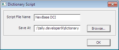

3. Enter the script file name in the field Script File Name .
4. Enter the location to save the script file in the field Save At as shown below:
5. Click OK to complete the automation process.
6. The .ds file (script file) will be saved at the specified location.

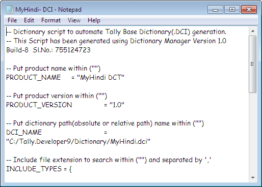

Editing the Script File
The script file once created, can be edited to modify the values of the parameters like Product Name , Product Version , and so on.

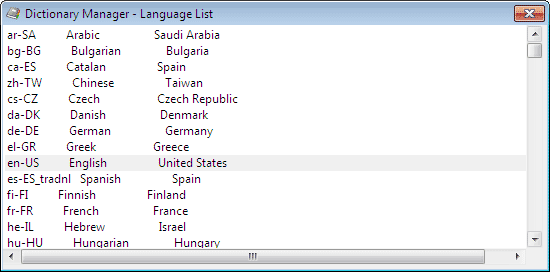

Dctmgr - l
The command dctmgr - l displays all the language IDs, language names, and the country name in the Language List message box.
The Dictionary Manager - Language List appears as shown below:
