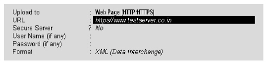

https URL support in Tally
Https client capability has been enhanced in Tally to exchange data with other applications securely. Https sites can be used for ftp upload, post request and receiving the data in collection. Now, data can be uploaded to https site, or request to the https site can be sent, using the action HTTP Post. The URL for the https site can be specified while gathering data in a collection.
Example: Upload
In the upload configuration screen, the URL for https site can be given as shown:
