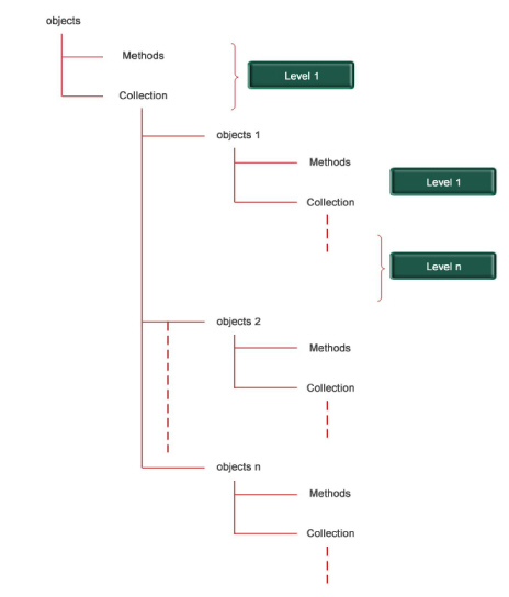

The Tally data base is hierarchical in nature, in which the objects are stored in a tree-like structure. Each node in the tree can be a tree in itself. An object in Tally is composed of methods and collections. Method is used to retrieve data from the database. A collection is a group of objects. Each object in the collection can further have methods and collections. The structure is as shown below:
Everything in TDL is an Object. As mentioned in the earlier chapters, Report, Menu, Company, Ledger, etc., all are objects in TDL. The properties of objects in TDL are called Attributes. For example, the attributes Object, Title, Form are all properties that define the Report object.
An object can have Methods and Collections, as mentioned earlier. For example, the Object β€˜Ledger’ contains the Methods Name, Parent, etc., and the collections Address and BillwiseDetails.
As shown in the image the Objects available at Level 1 are referred to as Primary objects and objects which are at Level 2-n are referred to as Secondary objects.

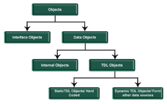

Two different types of objects are available in TDL. The following section describes the classification of objects in TDL.
Tally Objects Types
Objects in TDL are classified into two types, based on the their usage and behaviour, as follows:
● Interface Objects
● Data Objects
Interface objects define the user interface while Data objects store the value in the Tally Primary or Secondary database. Any data manipulation operation on the data object is performed through Interface objects only. Figure 6.2 shows the classification of objects in TDL.

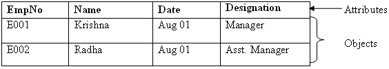

As discussed earlier, a user can create Static TDL Objects for which the data is hard coded. Consider the following examples of Employee Details.
Employee Details
In TDL, two objects have to be created such that EmpNo, Name, Date and Designation become the attributes of the object. The code snippet to create these objects is as shown:
[Object : E mp 1]
EmpNo : E001
Name Β : β€œKrishna”
Date Β : Aug 01 Designation : Manager
[Object : E mp 2]
EmpNo : E002
Name Β : β€œRadha”
Date Β : Aug 01
Designation : β€œAsst. Manager”

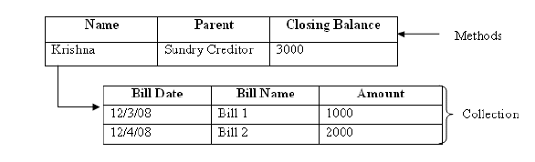

Consider the data for a ledger object which has multiple bill details associated with it.
Ledger D e t ails
This hierarchical structure shows that the ledger Krishna is created under the group Sundry Creditors. It further contains multiple bill details. The Ledger Name is Krishna, the parent group is Sundry Creditors and the closing amount is 3000. The two bills Bill 1 for the amount 1000 and Bill 2, for the amount 2000, are associated with the ledger Krishna.

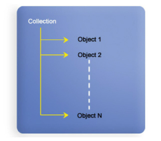

A Collection is termed as a group of objects. It refers to a collection of zero or more objects. The objects in the collection can be obtained either from the Tally database, or from external data sources, e.g., XML file.
In default TDL, many collections are defined which are referred to as Internal Collections. The collections created by a user are called user defined collections. Object in a collection follow the Tally object structure, i.e., each object of the collection can contain Methods, Collections, and so on.

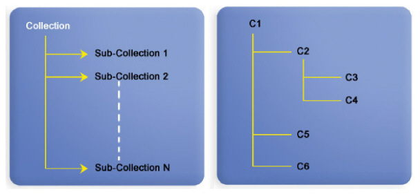

A collection can be a collection of objects or a collection of collections. Figure 6.3 shows the collection of objects.
The collection of collections is referred to as a Union of collection. This capability will be discussed in detail in the section Collection capabilities. In TDL, the collections are of two types: Simple collection and Compound collections.
Types of Collection
Collections can have multiple Methods and Collection. They are classified as Simple Collection and Compound Collection based on the constituents of the collection.
Simple Collections
Simple collections contain only a single method which is repeatable. Simple Collections cannot have sub-collections. The Name and Address are examples of Simple Collections.
Compound Collections
The collections which have sub-collections and multiple methods are called Compound Collection. Any Internal or External Collections of Primary or Secondary or user defined objects is an example of a Compound Collection. In both Simple and Compound Collections, the index can be used to fetch user-defined or internal methods of the Object. The Index can be either First or Last.

Collection Capabilities
Having understood the concept of Objects, Collection, Methods and Object association, let us now concentrate on understanding the concept of Collection as a Data Processing Artefact in TDL.
In previous sections, we saw that a Collection can contain objects from Tally Database or populate objects from external data sources as well. In further sections, we will discuss the capabilities of collection from the data processing perspective. Let’s segregate the capabilities into:
● Bas i c Ca p abilities
o Union
o Filtering
o Sorting
o Searching
● Adv a nced Ca p abilities
o Extraction
o Aggregation
o Usage As Tables
o Integration Capabilities using HTTP XML Collection
o Dynamic Object Support
o Collection Capabilities for Remoting
We will be covering the Basic capabilities in detail with all the relevant attributes and functions for achieving the same. Some portions of Advanced capabilities which were available prior to Tally.ERP 9 will be covered here. The latest developments pertaining to this, will be covered in our training program β€˜TDL Enhancements for Tally.ERP 9’.

Union
β€˜Union’ refers to creation of a Collection by combining multiple Collections. The total number of objects in the resultant Collection will be the sum of objects in all the Collections. The following figure shows a Collection of sub-collections, which can further be unions of collections, and so on.
This example shows that Collection C1 contains Collection C2 and Collection C3. Likewise, Collection C2 further contains Collection C4 and Collection C5. The attribute Collection is used to create a Union as follows:
Attribute - Collection
The attribute β€˜Collection’ is used to specify a Collection under the main Collection. All the objects belonging to the Sub collections are available in the resultant Collection.
Syntax
Collection : <List of Collections>
Where,
<List of Collections> is a comma-separated list of collections. The Collections that are used can be of different types.
Example
[Collection : Groupandledger]
Collections : Group, Ledger
Here, the collections β€˜Group’ and β€˜Ledger’ are used, under the main collection GroupandLedger.
