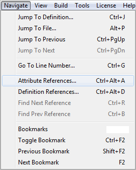

1. Go to Navigate > Attribute References .

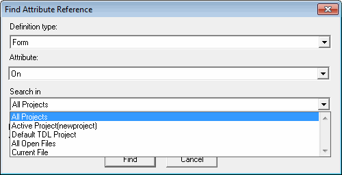

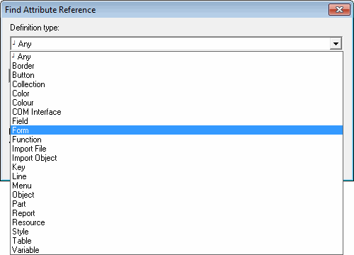

2. Select the required Definition type in the Find Attribute Reference window.

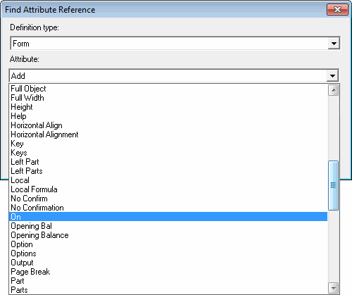

3. Select the required Attribute within the selected Definition type to be searched.
4. Specify the Scope of search by selecting one of the options from the Search in drop-down menu.
5. Click Find to get all the matching results in the Reference tab of Output window.
The meaning of the various scopes are as follows:
● The All Projects option is the default option and is used to search for the string in all the loaded projects.
● The Active project option is used to search for the string in the currently active project.
● The Default TDL Project optionΒ is used to search for the string in the default TDL files.
● The All Open Files optionΒ is used to search in files that are currently open in the project.
● The Current File option is used to search in the current File.

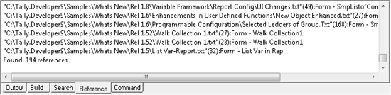

Reference tab displays all the Form definitions having the attribute On . Attribute On is used in multiple definition types and their purpose varies. The search has narrowed down to attributes under Form definition, thereby shortlisting the search results as required by the TDL programmer.
