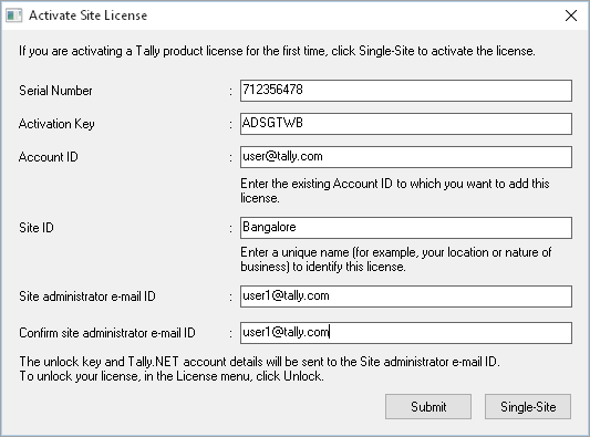

3. Click Multi-Site in the License Activation screen, to activate the Site license.
4. E nter the Serial Number and Activation Key .
5. Enter the Account ID to which you want to add this license. Contact your administrator for this information.
6. Enter the Site ID . The Site ID should be a unique name to help you to identify this license.
7. Enter the Site administrator e-mail ID . The Site administrator is authorised Β to perform all licensing operations for this Site. The Activate Site License screen appears as shown below:
