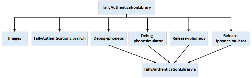

Tally Authentication Library Directory Structure
The directory structure of the Tally Authentication Library for iOS is shown below:
The library for iOS is contained in the TallyAuthenticationLibrary directory. This directory will further contain one file and five subdirectories. To support a specific mode (debug/release) and specific environment of execution (device/simulator), there are four subdirectories. Each subdirectory contains a specific TallyAuthenticationLibrary.a file.
Directory
Features
Description
Images
It contains all the images required by the Tally Authentication Library.
Add these images to the application project.
TallyAuthenticationLibrary.h
Add this .h file to the application project.
Debug-iphoneos
Use this .a file in the application which is running on a physical device in debug mode.
Debug-iphonesimulator
Use this .a file in the application running on a simulator (simulating iPhone 4 and above) in debug mode.
Release-iphoneos
Use this .a file in the application running on a physical device in release mode.
Release-iphonesimulator
Use this .a file in the application running on a simulator (simulating iPhone 4 and above) in release mode.
