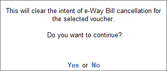

In the e-Way Bill report, drill down from the relevant section; for example, the Pending for e-Way Bill cancellation section.
Select the voucher and press Alt+F10 (Undo Cancellation).
- Press Enter to proceed.
This will remove details of the cancellation (such as the Reason for cancellation and Remarks), and the voucher will move to its original section.
