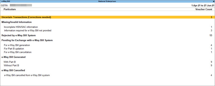

  • Press Alt+G (Go To) > type or select e-Way Bill, and press Enter.
    EWB-Report-1
You can see different sections in the report depending on the status of your e-Way Bill transactions.
e-Way Bill Register
  • In this section, you can check the e-Way Bill status and other transaction details for a selected period.
  • If needed, you can remove e-Way Bill information from specific vouchers by pressing Alt+V (Remove EWB Info).
Uncertain Transactions (Corrections needed)
  • This section lists the transactions where there is mismatch or incomplete information in the voucher, ledger, or stock item.
  • You can drill down from the transactions to resolve uncertainties, or accept them as is and recompute values.
Missing/Invalid Information
This section lists the transactions that have missing or invalid Information, which needs to be corrected before the e-Way Bill can be generated.
This section also comes with the following sub-sections, where you can quickly find and correct the transactions:
  • Incomplete HSN/SAC information
  • Information required for e-Way Bill not provided
    Once you resolve the transactions under these buckets, they will appear under Pending for Exchange with e-Way Bill System > For e-Way Bill Generation.
Moreover, if e-Invoice is enabled in your company, then the following sub-sections will appear:
  • Information required for e-Invoice not provided
  • Mismatch in e-Invoice Details
Rejected by e-Way Bill System
This section lists the transactions where e-Way Bill generation/cancellation requests were rejected by the portal, due to reasons such as duplicate e-Way Bill number, invalid HSN code, and so on.
After drilling down, you can see the reasons for rejection (as per the portal) in the e-Way Bill Details screen. Subsequently, you can drill down to the voucher and re-generate the e-Way Bill.
This section displays transactions that are ready to be sent to the portal, as they have no missing or uncertain information.
  • It includes transactions ready for:
    • e-Way Bill generation
    • e-Way Bill cancellation
    • e-Way Bill extension
    • Updation of Part B/Transporter ID
  • You can proceed to the Exchange menu (Alt+Z (Exchange) > Send for e-Way Bill), and send the transactions to the portal.
Exported
After the transactions are successfully exported for e-Way Bill generation or updation of Part B/Transporter ID, they will appear in the Exported section.
e-Way Bill Generated
This section lists the transactions where the e-Way Bill is generated (with or without Part B) from the portal, or manually updated in the offline mode using TallyPrime or other software.
You can further update e-Way Bill information for the required transaction by pressing Alt+Q (Manually Update EWB Info).
e-Way Bill Cancelled
This section lists all the transactions where the e-Way Bill is cancelled from the portal, or manually marked as cancelled in the offline mode in TallyPrime or other software.
User-Excluded Transactions
This section lists the transactions that you have chosen to exclude from the e-Way Bill process. However, if you want to include certain transactions from this list for e-Way Bill activity, then you can select the transactions and press Alt+H (Include).
