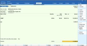

Let’s consider a GST Sales transaction to generate e-Way Bill.
  1. Specify the required voucher details, such as the Party A/c name, Sales ledger, Name of Item, GST ledger, and so on.
  2. Set the option Provide GST/e-Way Bill details to Yes.

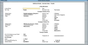

  3. In the Statutory Details screen, update the additional details.
    interstate-sales-taxable
    1. e-Way Bill Details: After the exchange of e-Way Bill with the portal, the e-Way Bill No. and Date will get updated automatically.
    2. Consignor Details (From): Check the details such as Mailing Name, GSTIN/UIN, Address and Pincode which will be prefilled as per your Company details.
    3. Consignee Details (To): Check the details such as Mailing Name, GSTIN/UIN, Address and Pincode which will be prefilled as per your Ledger details.
    4. Transport Details: Fill in the Pin to Pin Distance, Transporter Name, and Transporter ID. If you don’t have a Transporter ID, updating the Part B Details is mandatory. After the exchange of e-Way Bill with the portal, the Pin to Pin Distance will get updated automatically.

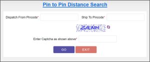

      • Pin to Pin Distance as per Portal: To calculate Pin to Pin Distance as per Portal, press Alt+L (Calculate Distance on Portal).
        Pin to pin Distance
        You will be redirected to the NIC website and the Pin to Pin Distance Search screen will appear, as shown below:
        pin-to-pin-distance

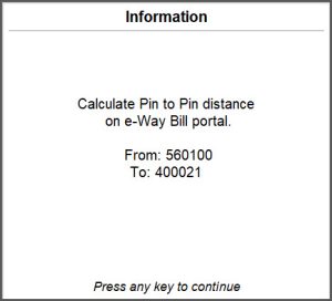

        From and To pin codes will be displayed as an Information message in TallyPrime, as shown below:
        You can enter the pincodes in the Pin to Pin Distance Search screen to calculate the distance.

      • Transporter Name: Select the Transporter Name. You can set it as None if you are transporting the goods using your own or hired vehicle, or if you are using a different mode of transport such as Rail, Air, or Ship.
      • Transporter ID: Enter the Transporter ID provided by the transporter.
        If Part B Details are available, then you can enter the following details.
      • Mode: Select the mode of transport, such as Road, Rail, Air, or Ship. You can also create a New Mode, if required.
      • Doc/Lading/RR/AirWay No.: You can fill in this option as an acknowledgment that your goods will be transported by rail, ship, or airway.
      • Vehicle Number: Specify the number of the vehicle used for transporting the goods.
      • Vehicle Type: Specify the size of the vehicle, such as Regular, Over Dimensional Cargo, and so on. You can also create a New Vehicle Type, if required.

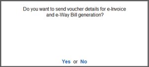

  4. Press Ctrl+A to save and generate the e-Way Bill.
    A confirmation screen for e-Way Bill generation will appear.
  5. Press Enter to proceed.

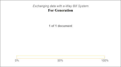

    TallyPrime will start exchanging information with the e-Way Bill system.
    After the exchange of information, a confirmation message will appear.
