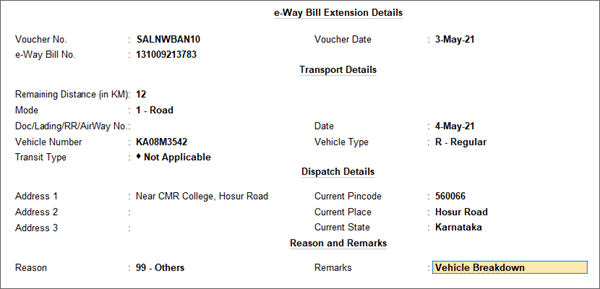

  1. In the e-Way Bill report, drill down from the relevant section in the e-Way Bill report; for example, the With Part B or Without Part B section under e-Way Bill Generated.
  2. Select the transaction and press F9 (Extend EWB).
  3. In the e-Way Bill Extension Details screen, enter the Remaining Distance (in KM).
    The validity of e-Way Bill will depend on the value entered here.
    If you are on TallyPrime Release 3.0 or later, then press Alt+L (Calculate Distance on Portal) and TallyPrime and you will be redirected to the link on the portal on which you can calculate the distance by providing the pin of both the places.
  4. Press Ctrl+A to save.
