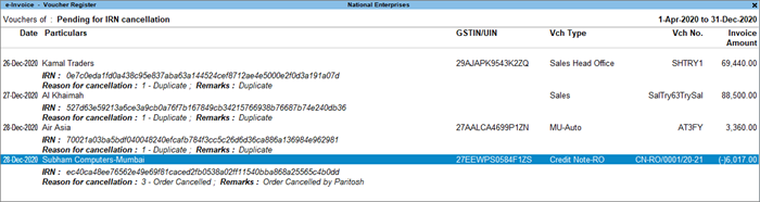

  2. Drill down from the required section, which can be either Pending for IRN Cancellation, Exported for IRN Cancellation, or Marked as IRN Cancelled.
  3. Press Alt+F5 for more details. You can see details of the cancellation, such as Reason for Cancellation and Remarks.
  4. Select the voucher for which you want to undo IRN cancellation.

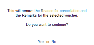

  5. Press Alt+F10 (Undo IRN Cancellation).
    A message will appear to confirm the removal of Reason for cancellation and Remarks for the voucher.
  6. Press Enter to proceed.
This will remove details of the cancellation (Reason for cancellation and Remarks), and the voucher will be moved to its original section.
