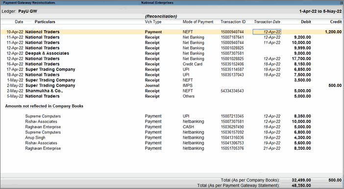

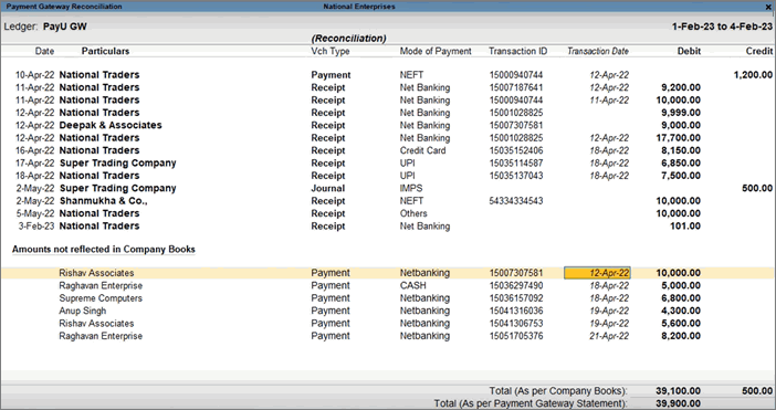

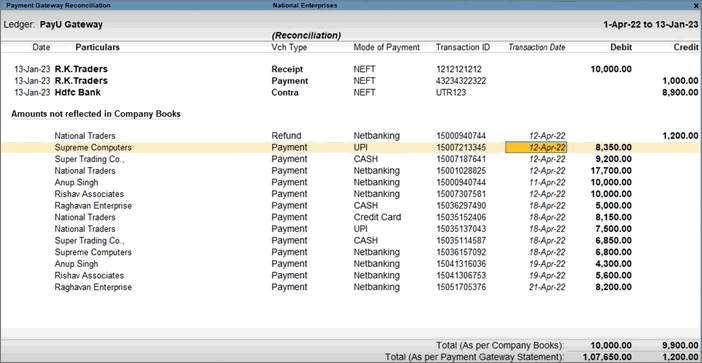

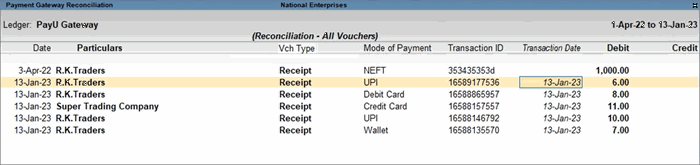

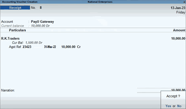

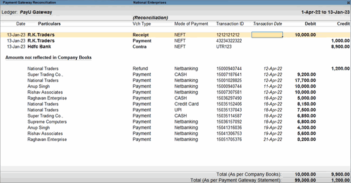

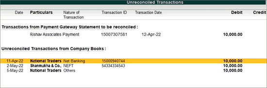

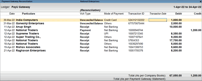

Seamless reconciliation of payments
TallyPrime provides the icing on the cake by facilitating a smooth reconciliation of all your Payment Requests. The Payment Reconciliation report will provide you with a neat summary of the unreconciled as well as reconciled transactions.
What’s more, the Payment Reconciliation report will help you figure out if the relevant transactions have been recorded in your books. If any transactions have not been recorded, then the report will help you in recording Receipt entries against the bill and settling the accounts with the customer. Moreover, you can also easily record the settlements and refunds that had occurred during the course of your business.

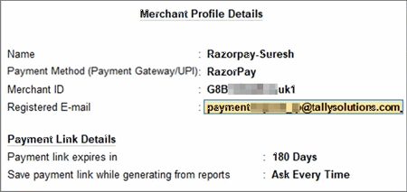

      The Merchant Profile Details screen will appear, where you can set up your Merchant Profile.
  2. Set up the Merchant Profile:
    1. Under Name, enter the username with which you want to maintain this profile.
    2. Under Payment Method (Payment Gateway/UPI), specify the Payment Gateway with which you have registered this particular profile.
    3. Enter the Merchant ID, as registered on the Payment Gateway portal.
    4. Enter the Registered E-mail and/or Registered Mobile.
      One or both of these fields will appear as per the Payment Gateway selected.
    5. Under Payment link expires in, set the expiry period after which your payment link will be considered as invalid.
      The default period will be pre-filled as per the Payment Gateway selected; for example, 180 days for Razorpay and 365 days for PayU. You can update this, if needed.
      The options in steps e and f will appear only if they are enabled in F12 (Configure) or Ctrl+I (More Details).

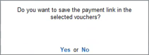

    6. Under Save payment link while generating from reports, select:
      1. Yes, to directly save the link in the voucher every time.
      2. No, to never save the link in the voucher during link generation.
      3. Ask Every Time, to select your preference every time the link is generated.
  3. Press Ctrl+A to save the Merchant Profile with the necessary details.

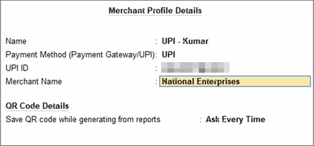

Create Merchant Profile using UPI
Once you have registered with the UPI service provider of your choice, you can easily set up your profile in TallyPrime using the same details, such as the registered UPI ID and Merchant Name.
For a seamless Payment Request experience with TallyPrime, you have to make sure that you are entering the valid details while setting up your profile.
  1. Open TallyPrime and enable the Payment Request feature:
    1. Pres F11 > Show more features > Yes.
    2. Set the Enable Payment Request to share payment link/QR code option to Yes.
    2. Select UPI Under Payment Method (Payment Gateway/UPI).
    3. Enter the UPI ID, as registered with the UPI service provider.
      You can find out the exact UPI ID by referring to your account or profile details in the UPI application.
    4. Under Merchant Name, the Company Name will be filled in by default. However, you have the flexibility to update this name, if needed.
    5. Under Save QR code while generating from reports, select:
      1. Yes, to directly save the QR code in the voucher every time.
      2. No, to never save the QR code in the voucher during link generation.
        If this option is set to No, then you will not be able to generate the QR code from reports, as no voucher will be available to save the QR code details. Similarly, if Ask Every Time is selected, and if you opted not to save the QR code details during link/QR code generation, then you will not be able to generate the QR code.
      3. Ask Every Time, to select your preference every time the QR code is generated.
        This option will appear only if it is enabled in F12 (Configure) or Ctrl+I (More Details).
What’s more, you also have the flexibility to create or alter the Merchant Profile from Gateway of Tally > Create/Alter Master > Merchant Profile, or by pressing Alt+G (Go To) > Create/Alter Master > Merchant Profile.

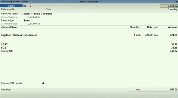

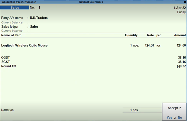

  2. Record your GST sales transaction, as usual
  3. Press Ctrl+A to save the transaction.

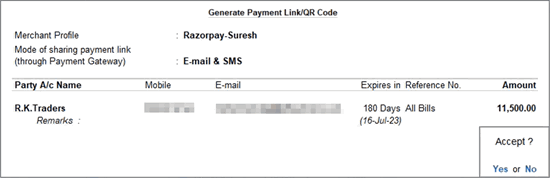

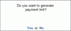

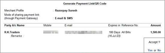

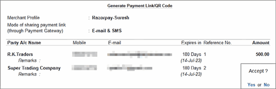

    A following prompt for link generation appears:
  4. Press Enter to proceed.
    The Generate Payment Link/QR Code screen appears.
  5. Update the details for link generation:
    1. Under Merchant Profile, select the relevant Payment Gateway.
      Once you select a particular Merchant Profile, it will be selected as the default profile for all your subsequent transactions.
    2. Specify the Mode of sharing payment link, such as e-mail, SMS, or both, in which the link has to be shared with your party.
    3. Specify the details of the party, such as the Party A/c Name, Mobile, and E-mail.
      The above party details
      will be filled in by default, as per the party ledger. For the Party A/c Name, you also have the option to directly enter a new party, or create a party ledger on the fly.
    4. Under Expires in, specify the expiry period after which your payment link will be considered as invalid.
      The expiry period is filled in by default from the Merchant Profile master. However, you can update this value as per your requirements for a specific party.

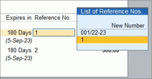

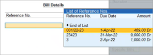

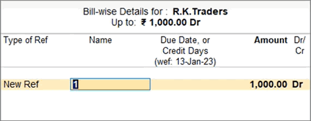

    5. Under Reference No., the Invoice No. will be prefilled by default. You can update this value as needed.
      Based on the details available, the List of Reference Nos. may also list the voucher Reference No., the bill Reference No. (if it is different from the Invoice No.), or a New Number. You can select any of these numbers, as needed. The New Number option will automatically appear as you start entering a new Reference No.
    6. Enter the Amount for which you want to request the payment.
    7. Under Remarks, enter any message that you want to convey to the party regarding the transaction.
      The options in steps d, e, and g will appear only if they are enabled in F12 (Configure).

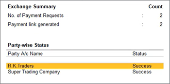

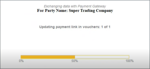

  6. Press Ctrl+A to save the details and generate the payment link.
    If you are not logged in to your Merchant Profile, then you will be asked to log in using the OTP sent to your registered e-mail address or mobile number.
  7. Enter the OTP and press Enter to continue.

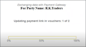

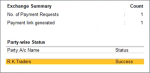

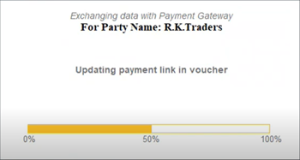

    The details of the transaction will be exchanged with the Payment Gateway.
    Once the payment link is generated and shared with the selected parties, you will receive the following message:

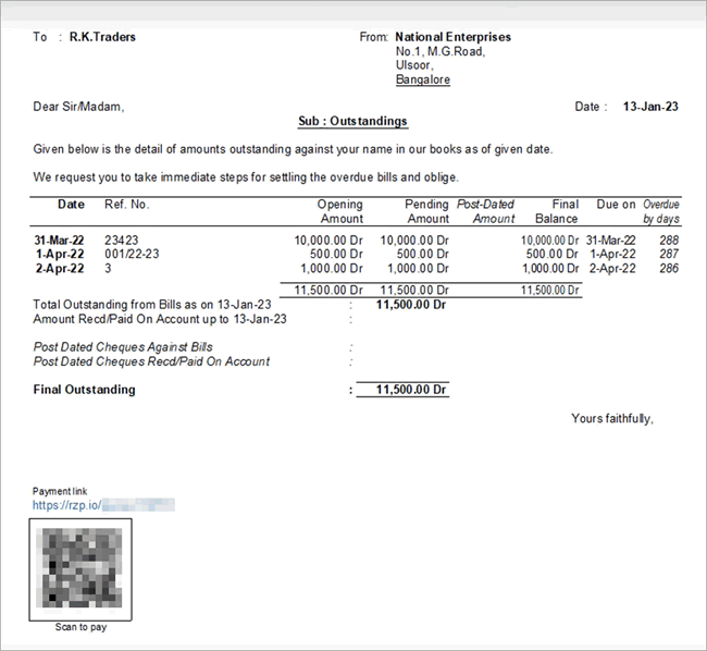

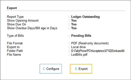

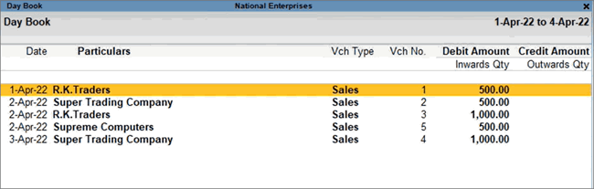

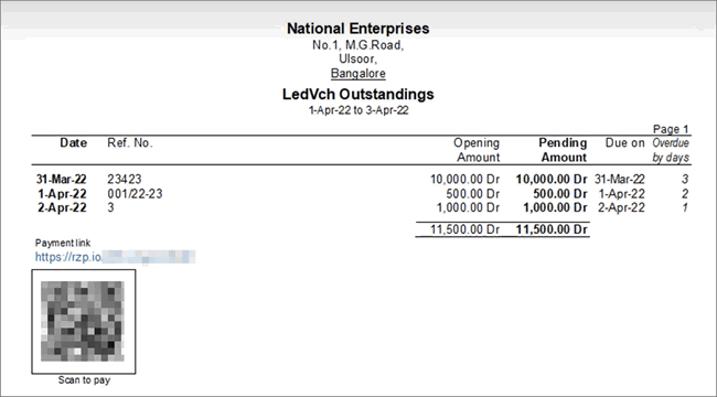

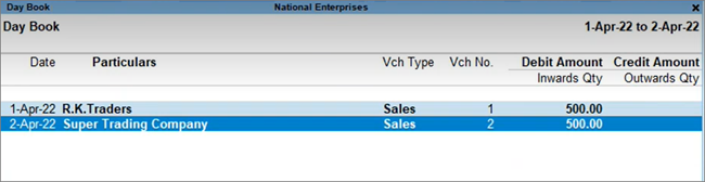

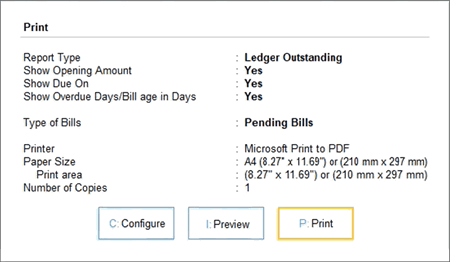

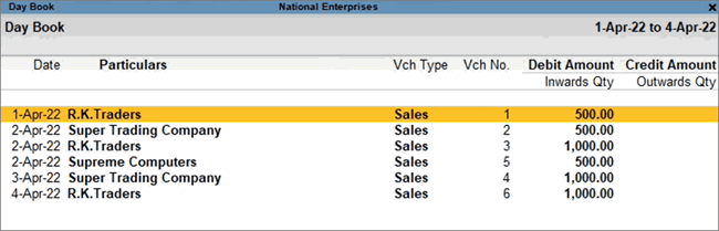

    Similarly, you can also generate payment link/QR code from the relevant reports such as Day Book or Ledger Voucher/Ledger Outstandings.

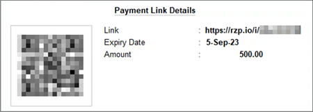

View the generated payment link/QR code details
Once you generate the payment link/QR code from the transaction or report, the details will be saved in the individual transactions. You can view the link/QR code details whenever needed, and also copy the link and share it with the relevant parties through various modes.
  1. Open the relevant transaction.
  2. Press Ctrl+O (Related Reports) > Payment Link/QR Code.
    The Payment Link Details screen appears as shown below.

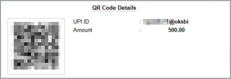

    For UPI-based payments, the QR Code Details screen will appear as shown below:
  3. Press Ctrl+C (Copy Link), if you want to copy the payment link and share it directly with the relevant party through various modes.

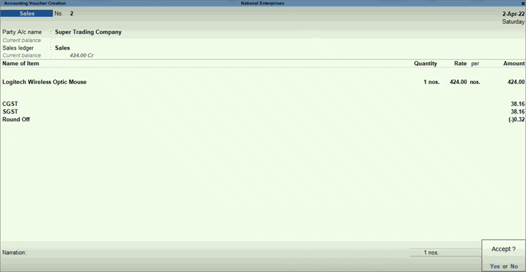

  2. Record your GST sales transaction, as usual.

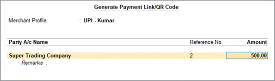

    1. Under Merchant Profile, select the relevant UPI username.
    2. Specify the Party A/c Name.
      The Party A/c Name will be filled in by default, as per the party ledger. You also have the option to directly enter a new party, or create a party ledger on the fly.
    3. Under Reference No., the Invoice No. will be prefilled by default. You can update this value as needed.
      Based on the details available, the List of Reference Nos. may also list the voucher Reference No., the bill Reference No. (if it is different from the Invoice No.), or a New Number. You can select any of these numbers, as needed. The New Number option will automatically appear as you start entering a new Reference No..
    4. Enter the Amount for which you want to request the payment.
    5. Under Remarks, enter any message that you want to convey to the party regarding the transaction.
      For UPI-based payments, ensure that the Remarks does not contain any special characters (such as &, #, and /), as they are not allowed by the UPI payment service providers.

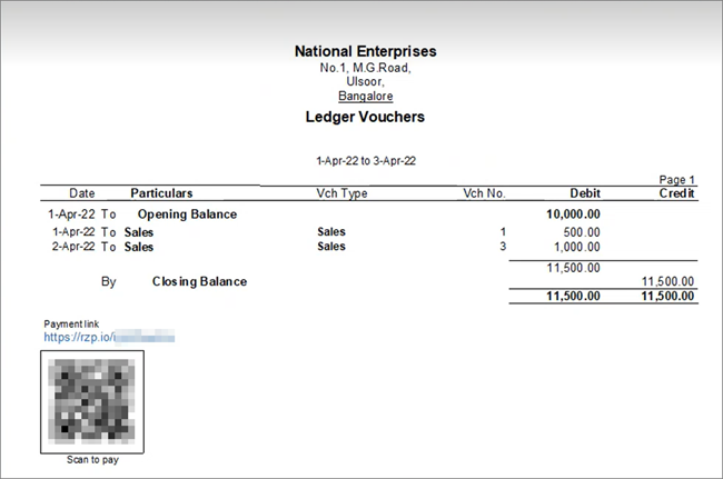

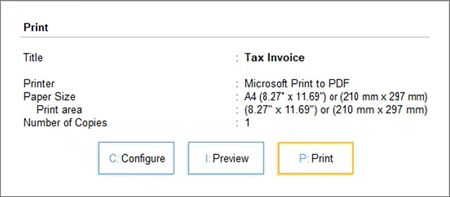

    If you print or export the invoice with the QR code, then it will appear as shown below:

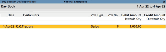

Generate payment link/QR code after recording a transaction
If you don’t want the payment link/QR code to be directly or automatically generated, then you can also choose to generate it after recording the transaction.
  1. Disable the payment link option in the voucher type:
    1. Press Alt+G (Go To) > Create/Alter > Voucher Type, and select or create the required voucher type for your sales transaction.
    2. Set the Generate payment link/QR code after saving voucher option to No.
    3. Press Ctrl+A to save the voucher type.

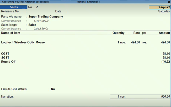

  4. Press PgUp to open the same transaction in the alteration mode.
  5. Press Alt+Z (Exchange) > Generate Payment Link/QR Code > Current.
    The Generate Payment Link/QR code screen appears.
  6. Update the details for link generation:
    1. Under Merchant Profile, select the relevant Payment Gateway or UPI user.
      The above party details will be filled in by default, as per the party ledger. For the Party A/c Name, you also have the option to directly enter a new party, or create a party ledger on the fly.
  7. Press Ctrl+A to save the details and generate the payment link/QR code.
    If a UPI user was selected under Merchant Profile, then a few fields, such as Mode of sharing payment link, Mobile, E-mail, and Expires in, will not appear in the Generate Payment Link/QR Code screen.

Generate payment link/QR code for one or more transactions | Generate payment link/QR code from Day Book
TallyPrime provides you with the flexibility to generate payment links and QR code at any time for one or many transactions.
You can do so by opening the Day Book, selecting the required transactions, and generating the payment link. That’s it! The payment links and QR codes will be instantly generated and shared with your parties.
  1. Press Alt+G (Go To) > Day Book.
  2. Press Spacebar and select the required transactions.
  3. Press Alt+Z (Exchange) > Generate Payment Link/QR Code > Current.
  4. Update the details for link generation:
    5. Under Reference No., the Invoice No. will be prefilled by default. However, if you have selected multiple vouchers or bills, then Multiple Ref will appear. You can update this field as needed.
      Based on the details available, the List of Reference Nos. may also list the bill Reference No. (if it is different from the Invoice No.) or a New Number. You can select any of these numbers, as needed.
  5. Press Ctrl+A to save the details and generate the payment link/QR code.
    The following prompt will appear, if you had enabled the corresponding option in the Merchant Profile.
    For QR code generation using UPI: If the above option is set to No, then you will not be able to generate the QR code from reports, as no voucher will be available to save the QR code details.
  6. Press Enter, if you want to save the payment link in the respective vouchers.

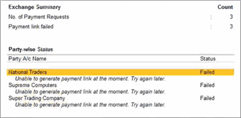

    Once the payment link is generated and shared with the selected parties, the following Exchange Summary will appear, where you can see the count of payments requests and payment links generated. You can also see the status against individual parties.
    However, if the payment link generation has failed for some reason, then the following Exchange Summary will appear, where you can see the number of failed requests and the details of the issue for each party.
    The payment link/QR code will be saved in the individual transactions, and you can view it at your convenience.
    Similarly, you can generate a QR code by selecting UPI as the Merchant Profile in the Generate Payment Link/QR Code screen.

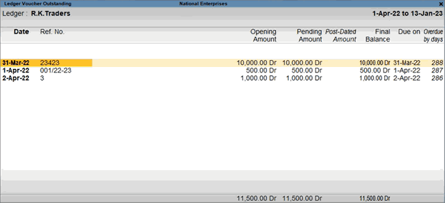

Generate payment link/QR code for multiple transactions of a single party | Generate payment link/QR code from Ledger Voucher/Ledger Outstandings
TallyPrime also provides you with the option to generate and share the payment link of the entire report for a particular party. You only have to open the Ledger Voucher or Ledger Outstandings report for the party, and then generate your payment link as usual.

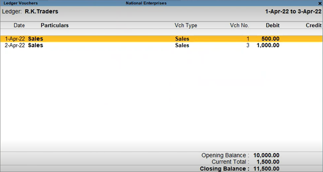

  1. Press Alt+G (Go To) > Ledger Voucher or Ledger Outstandings, and select the party ledger.
    The Ledger Voucher/Ledger Outstandings report will appear, where you can see the transaction or bill details of the selected party.
  2. Press Spacebar and select the required transactions. Accordingly, the consolidated Amount will be considered for the selected transactions.
    If you do not select any transactions, then the entire Closing Balance for the party will be considered for generating payment link or QR code.
    5. Under Reference No., Multiple Ref will appear by default, as you have selected multiple vouchers or bills. You can update this field as needed.
      All Bills will appear under Reference No., if you have not selected any vouchers or bills.
      If you have selected specific bills, then the Amount will appear accordingly. Otherwise, the entire Closing Balance for the party will appear in the Amount. Depending on your requirements or understanding with the party, you can update the Amount as needed.
    Once the payment link is generated and shared with the selected party, the following Exchange Summary will appear, where you can see the count of payments requests and payment links generated.

TallyPrime also provides you with the flexibility to print the payment link/QR code in the invoice. This will help your parties to refer to the details in the invoice and conveniently make the payment by clicking the link or scanning the QR code.
  1. Record your GST sales transaction, as usual.
    If you want to print an existing transaction, then you can open it from a report such as Day Book or Ledger Voucher.
  2. Press Ctrl+P to print the current transaction.
    The Print screen appears.
  3. Configure the details for printing by pressing C (Configure):
    1. Set the Printer as Microsoft Print to PDF, if you want to save a PDF file of your invoice, or select the required printer, if you want to print a hard copy.
    2. Update other print options, as needed.
    3. Under Payment Request Details, set the Method of Payment Request as either Link, QR Code, or Link & QR Code, as per your business needs.
      For UPI-based payments, set the Method of Payment Request as QR Code.
    4. Press Ctrl+A to save and return to the Print screen.
  4. Press P (Print) to continue printing.
    Depending on your configuration, the printout will appear as shown below, along with the payment link/QR code.
Now, as per your preference, you can share the PDF or printout with your party, and they can conveniently make the payment.
Print Ledger Accounts with payment link/QR code

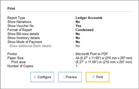

TallyPrime also provides you with the flexibility to print the payment link/QR code directly in your Ledger Accounts. This will help your parties to refer to the details in the PDF file or printout and conveniently make the payment by clicking the link or scanning the QR code.
  1. Press Alt+G (Go To) > Ledger Voucher, and select the party ledger.
    The Ledger Voucher report will appear, where you can see the transaction details of the selected party.

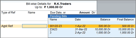

    5. Reference No.: The following values will appear, based on your selection:
      1. All Bills: The value in Reference No will appear as All Bills, by default, if bill-wise entries have been enabled.
      2. Specify Bills: If you want to generate the link for specific bills, then select Specify Bills instead of All Bills.
        The Bill Details sub-screen will appear, where you can select the required bills from the list.
  6. Press Ctrl+A to save the details and generate the payment link/QR code.

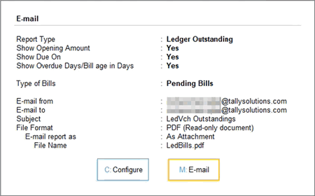

Print Ledger Outstandings/Reminder Letter with payment link/QR code
TallyPrime also provides you with the flexibility to print the payment link/QR code directly in your Ledger Outstandings. This will help your parties to refer to the details in the PDF file or printout and conveniently make the payment by clicking the link or scanning the QR code.
You also have the added advantage of printing your Ledger Outstandings as a Reminder Letter, along with the Payment link and QR code.
  1. Press Alt+G (Go To) > Ledger Outstandings, and select the party ledger.
    The Ledger Voucher Outstandings report will appear, where you can see the transaction details of the selected party.
    1. Set the Report Type as Ledger Outstandings or Reminder Letter, depending on your requirement.
    2. Set the Printer as Microsoft Print to PDF, if you want to save a PDF file of your invoice, or select the required printer, if you want to print a hard copy.
    4. Set the Include Post-dated Vouchers option to Yes, if you want to print the details of post-dated cheques in the invoice.
    5. Update other print options, as needed.
    6. Press Ctrl+A to save and return to the Print screen.
    5. Reference No.: The following values will appear, based on your selection.
  7. Press Enter, if you want to save the payment link in the respective vouchers.
    If you had selected Reminder Letter, then the printout will appear as shown below:
    The details for post-dated cheques will appear if you had enabled the Include Post-dated Vouchers option in print configuration.
Now you can share the PDF or printout with your party, and they can conveniently make the payment. You can also export or e-mail the printout, as per your convenience.

  1. Press Ctrl+E to export the transaction or report (Ledger Voucher, Ledger Outstandings, or Reminder Letter).
    The Export screen appears.
  2. Configure the details for export by pressing C (Configure):
    1. Set the File Format as JPEG (Image) or PDF (Read-only document).
      The payment link will be clickable only in the PDF file, so you have to select the File Format accordingly.
    2. Under Payment Request Details, set the Method of Payment Request as either Link, QR Code, or Link & QR Code, as per your business needs.
    3. Update other export options, as needed.
    4. Press Ctrl+A to save and return to the Export screen.
  3. Press E (Send) to continue exporting.

  1. Press Ctrl+M to e-mail the transaction or report (Ledger Voucher, Ledger Outstandings, or Reminder Letter).
    The E-mail screen appears.
  2. Specify the E-mail from and E-mail to addresses and other options, as needed.
  3. Press Ctrl+A to save the details.
    The E-mail screen appears, where you can further explore the e-mail options.

  1. Press Alt+G (Go To) > Day Book, and set the required Date (F2) or Period (Alt+F2).
    The transactions will be listed for the selected period.
  2. Press Ctrl+B (Basis of Values) > Status of Vouchers > With Payment Link/QR Code.
  3. Press Ctr+A to save the details.
    You can see the transactions for which the payment links/QR codes have been generated.

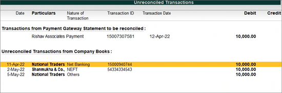

Reconcile Payment Gateway Transactions
Once your parties make the payments against the payment request shared by you, then you can record the corresponding receipt entries to ensure that the accounts are settled and up to date. However, sometimes you might not be aware of a few crucial details, such as the Transaction ID or the Transaction Date, and you might have recorded your receipt entries without these details.
Now you might be worried about keeping a track of all such transactions related to your payment requests. The Payment Reconciliation report will help you in this regard by listing all such entries where the crucial details are missing, so that you can easily update the details directly in the report.
Further, if there are any transactions that are recorded on the Payment Gateway, but not on in your books, then you can easily record the corresponding transactions in your books directly from the Payment Reconciliation report. At the click of a button, all the available details of the transaction will be filled in automatically. You only have to select the party and save the transaction.
What’s more, the Payment Reconciliation report also keeps a track of all your transactions that have been reconciled already, so that you can get a holistic view of all your activities related to payment requests.

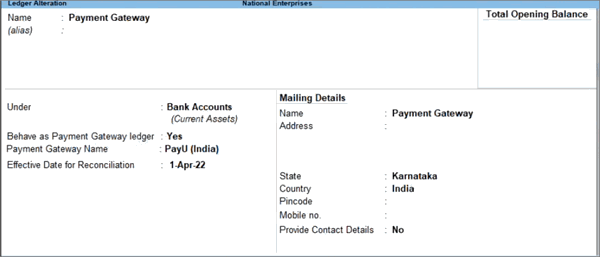

Create Payment Gateway ledger
A Payment Gateway ledger will help you in easily maintaining payment request transactions against specific Payment Gateways. Accordingly, the recorded transactions will appear in the Payment Reconciliation report as per the Payment Gateway selected, and help in easy reconciliation.
  1. Press Alt+G (Go To) > Create/Alter Master > Ledger.
    The Ledger Creation or Ledger Alteration screen will open, depending on your earlier selection.
  2. Enter the Name of the Payment Gateway.
  3. Select the group as either Bank Accounts or Current Assets.
    If you select Bank Accounts, then you will be able to record the Payment Request transactions using payment, receipt, or contra vouchers, as needed. However, if you select Current Assets, then you will have to record all the Payment Request transactions using journal vouchers.
  4. Set the Behave as Payment Gateway option to Yes.
    This will ensure that this ledger is treated as a Payment Gateway for tracking your Payment Request transactions. Moreover, it will help you in capturing the details in Transaction Allocations while recording the transactions.
  5. Select the Payment Gateway Name from the List of Payment Gateways.
  6. Update the Effective Date of Reconciliation, if needed.
    If this option is not visible, then press F12 (Configure) > Show more configurations, and enable Provide Effective Date of Reconciliation. You can also enable this option by pressing Ctrl+I (More Details).
    If this option is already enabled, then the Effective Date of Reconciliation will be set to the Financial Year Beginning from date, by default. Accordingly, the Payment Reconciliation report will display the transactions that are recorded after the Effective Date of Reconciliation.
  7. Specify other details, as needed.
  8. Press Ctrl+A to save the details.

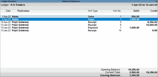

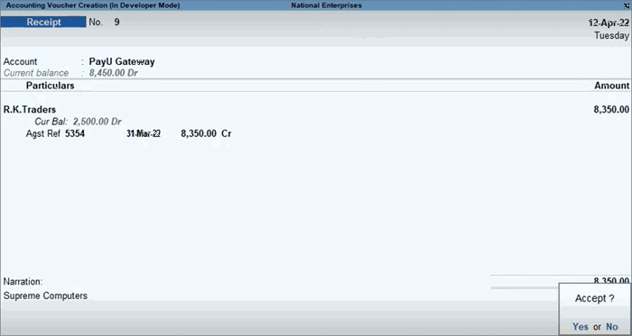

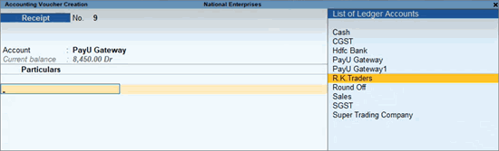

Record receipts against Payment Requests using receipt voucher
Once your parties have processed the payments against your Payment Request, you can record the corresponding entries in your books using receipt vouchers.
  1. Press Alt+G (Go To) > Create Voucher, and press F6 (Receipt).
    The Accounting Voucher Creation appears.
  2. Under Account, select the relevant Payment Gateway.
  3. Select the party under Particulars, and enter the relevant Amount.
  4. Specify the Bill-wise Details for the party, if applicable.

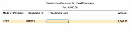

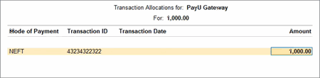

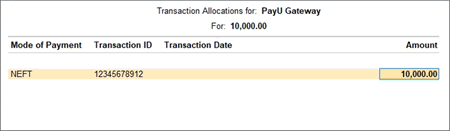

    The Transaction Allocations for screen appears for the selected party.

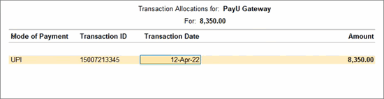

  5. Specify the Transaction Allocation details, such as Mode of Payment, Transaction ID, Transaction Date, and Amount.
    If the Transaction Date is provided, then the transaction will appear as Reconciled in the Payment Reconciliation report. You can view such transactions by enabling the Include Reconciled Transactions option in Basis of Values (Ctrl+B).
  6. Press Ctrl+A to save the details.
  7. Press Ctrl+A to save the voucher.

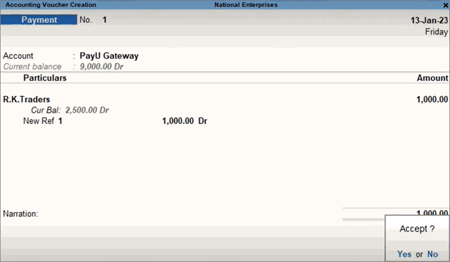

Record refund amount using payment voucher
In some cases, the Payment Gateway might have refunded the amount to your party against some of your Payment Requests. You can record the corresponding entries in your books using payment vouchers.
  1. Press Alt+G (Go To) > Create Voucher, and press F5 (Payment).
    You can specify the reference number of the refund in the Transaction ID field.
    Moreover, if the Transaction Date is provided, then the transaction will appear as Reconciled in the Payment Reconciliation report. You can view such transactions by enabling the Include Reconciled Transactions option in Basis of Values (Ctrl+B).

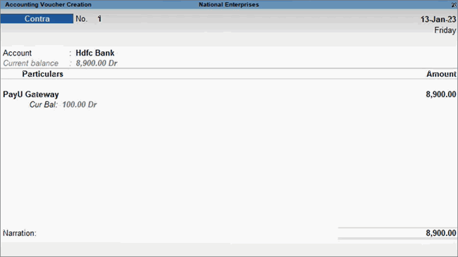

Record bank settlement using contra voucher
Once the Payment Gateway processes the payment to your bank account, you can use a contra voucher to record this settlement of payment.
Based on your needs and business practices, you can track the Payment Gateway charges directly in the transactions, or record them separately using journal vouchers.
  1. Press Alt+G (Go To) > Create Voucher, and press F4 (Contra).
  2. Under Account, select the relevant bank account.
  3. Select the Payment Gateway under Particulars, and enter the relevant Amount.
    The Transaction Allocations for screen appears for the selected Payment Gateway.
  4. Specify the Transaction Allocation details, such as Mode of Payment, Transaction ID, Transaction Date, and Amount.
  5. Press Ctrl+A to save the details.

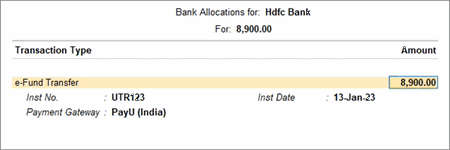

    The Bank Allocations for screen appears for the selected bank account.
  6. Specify the Bank Allocation details, such as Transaction Type, Instrument No., and Instrument Date.
    The Transaction ID from Transaction Allocations will be prefilled as the bank Instrument No..
  7. Press Ctrl+A to save the details.
  8. Press Ctrl+A to save the voucher.

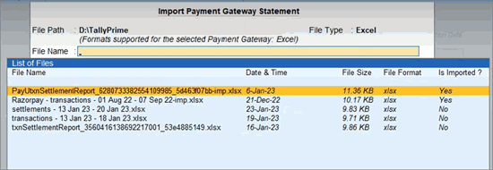

  5. Specify the File Path and the File Type.
    Ensure that you have selected the File Type that is supported by the selected Payment Gateway.
  6. Select the required file from the List of Files.
    After successful import, the following summary message appears, where you can see the transaction details, such as the Total Entries in Payment Gateway Statement and the number of transactions reconciled after import.

Once you have imported the Payment Gateway statement from the portal, you can get a clear view of how all your payment requests are recorded on the portal as well as in your books. Any discrepancies or missing details will be clearly highlighted, so that you can take the necessary action.

Reconcile Unlinked Transactions (Manual reconciliation)
Sometimes, the transactions from the portal and the transactions in your books might not get automatically reconciled. This might happen when a detail such as the Transaction ID is missing in one of your transactions. You can easily reconcile such cases manually.
  1. Press Alt+G (Go To) > Payment Reconciliation, and select the Payment Gateway ledger for which you want to view the report.
  2. Import the Payment Gateway statement, as explained in the previous section.
    The Payment Reconciliation report will appear, listing the unreconciled transactions.
  3. Under the Amounts not reflected in Company Books section, select the transactions that you want to reconcile, and press Alt+Q (Reconcile Unlinked).
    The Unreconciled Transactions screen appears.
    If there are any matching transactions in your books, then they will be listed under the Unreconciled Transactions from Company Books section.
  4. Select the required transaction and press Enter to proceed with reconciliation.
    The transaction will be reconciled and no longer appear under Amounts not reflected in Company Books.
Reconcile All Unlinked Transactions
Sometimes, the transactions from the portal and the transactions in your books might not get automatically reconciled, due to some missing details. If you do not want to reconcile such cases manually, then you can opt for Reconcile All Unlinked. In this option, the Payment Reconciliation report will help you in finding the matching transactions from company books for all the transactions from the imported statement, one by one.
  3. Press Alt+R (Reconcile All Unlinked), without selecting any particular entry.
    Similarly, you can press Enter to reconcile all the transactions, one by one.
Record transactions directly from Payment Reconciliation report
After importing the Payment Gateway statement, you may find that a few of your transactions are appearing on the portal but are yet to be recorded in your books. For such transactions, the Payment Reconciliation report provides you with the wonderful flexibility to record the corresponding entries in your books, at the click of a button!
  2. Import the Payment Gateway statement.
    The Payment Reconciliation report will appear as shown below.
    The transactions that are yet to be recorded in your books will appear under Amounts not reflected in Company Books.
  3. Select the entry for which you want to create a corresponding voucher in your books, and press Alt+J (Create Voucher).
    The Accounting Voucher Creation screen appears, where the details such as the Payment Gateway (under Account) and Amount will be prefilled.
  4. Select the relevant party under Particulars.
    The relevant details, such as the Mode of Payment, Transaction ID, and Transaction Date, will be filled in automatically, as shown below.
  5. Check the necessary details and save the transaction.
    The reconciled transaction will now no longer appear under Amounts not reflected in Company Books.
    Similarly, you can create the corresponding vouchers for all the entries that are not present in your books.

Set Unreconciled Balance
Set Unreconciled Balance is a versatile feature that you can use to add any pending unreconciled transactions that were recorded before the Effective Date of Reconciliation specified in the Payment Gateway ledger.
    The Payment Reconciliation report appears as shown below:
  2. Press Alt+H (Basis of Values) > Set Unreconciled Balance > Yes.
    The Unreconciled Details for screen appears for the selected Payment Gateway ledger.
  3. Specify the following details for the transactions that you want to add.
    1. Under Date, specify the date of the transaction. This date must be earlier than the Effective Date of Reconciliation, which you can see below the heading of the screen.
    2. Enter the Party A/c Name in Particulars.
    3. Enter the Nature of Transaction, such as Payment, Refund, and Settlement.
    4. Enter the Mode of Payment, such as Net Banking, Debit or Credit Card, and so on.
    5. Enter the Debit or Credit amount, as relevant.
      If you are splitting the company data, then the Unreconciled Details will be automatically prefilled as per the transactions. You can verify the details and update, if needed.
      The Payment Gateway Reconciliation screen appears, where you can see the above transactions marked as Unreconciled Balance.
      Now you can proceed to reconcile the transactions, as per your convenience.
