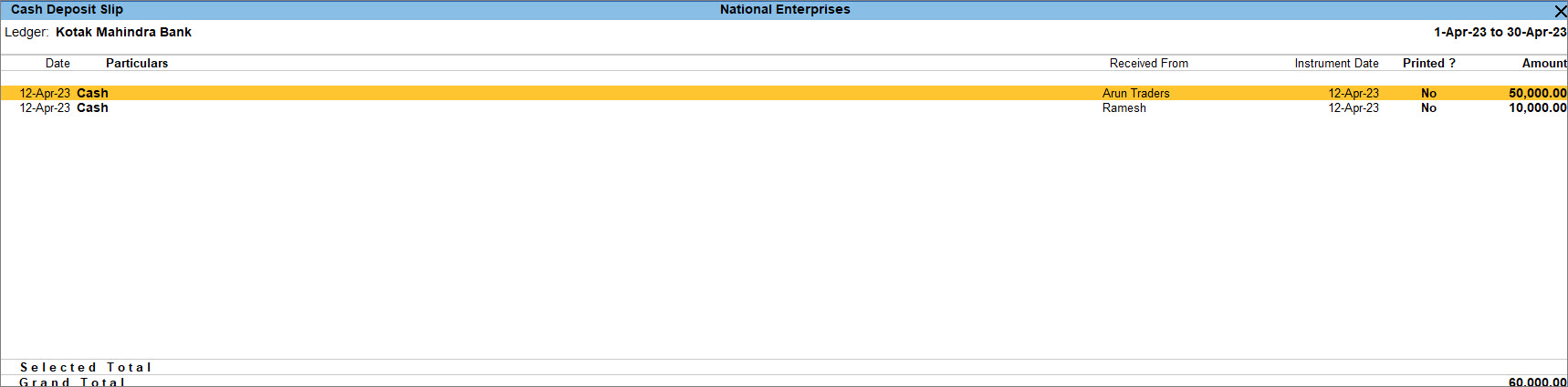

  1. Open the Cash Deposit Slip.
    1. Press Alt+G (Go To) > type or select Cash Deposit Slip, and press Enter.
    2. Select the required Bank account from the list for whose transaction you want to print Cash Deposit Slip and press Enter.
    3. Press F5 (Cash) to view the Cash Deposit Slip.
      Cash deposit slip
  2. Print the Cash Deposit Slip.
    1. To include selected receipts in the Cash Deposit Slip, press Spacebar on the required receipt rows, and press Ctrl+P to print.
    2. To include all the receipts in the Cash Deposit Slip, press Ctrl+P to Print.

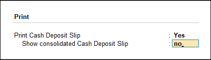

    3. Select the options to print the Cash Deposit Slip separately or consolidated.
      1. Print Cash Deposit Slip: Set this option to Yes to print the Cash Deposit Slip for the selected transaction.
      2. Show consolidated Cash Deposit Slip: Enable this option, to print one consolidated Cash Deposit Slip for all selected transactions. By default, this is set to No.

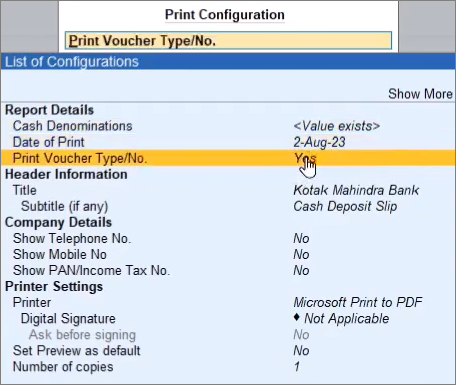

    4. In the Cash Deposit Slip Details screen, press C (Configure) to configure the report before printing.
      1. Date of Print: The date that has to be printed on the Cash Deposit Slip has to be specified in this field. By default, the current system date is displayed. Usually, this date will be the date on which the actual deposit of the cash into the bank will be made.
      2. Print Voucher Type/No.: Enable to print the voucher type and number.
        Cash and Deposit Slips Print Configuration

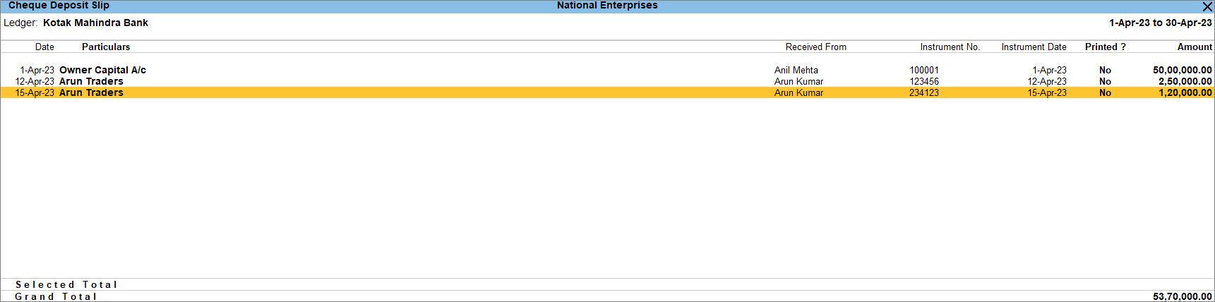

The Cheque Deposit Slip contains the name of the company or person from whom you have received the cheque along with other details such as Account Holder’s Name, Bank Name, Branch Name (as available in the bank ledger), Cheque Date, Cheque No., and Amount.
  1. Open the Cheque Deposit Slip.
    1. Press Alt+G (Go To) > type or select Cheque Deposit Slip, and press Enter.
    2. Select the required Bank account from the list for whose transaction you want to print Cheque Deposit Slip and press Enter.
      cheque deposit slip

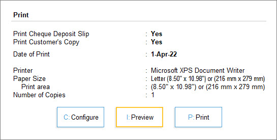

    1. To include all the receipts in the Cheque Deposit Slip, press Ctrl+P to Print.
    2. To include selected receipts in the Cheque Deposit Slip, press Spacebar on the required receipt rows, and press Ctrl+P (Print) to print.
      cheque deposit slip print
    3. Press C (Configure) to configure the report before printing.
