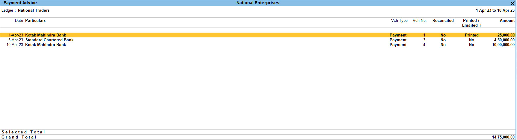

  1. Press Alt+G (Go To) > type or select Payment Advice and press Enter.
  2. Select the required ledger and press Enter.
    If the option All Items is selected, the payment advice for all transactions will be displayed.
    Payment Advice
  3. Select the required row and press Enter to open the voucher in Alteration mode.

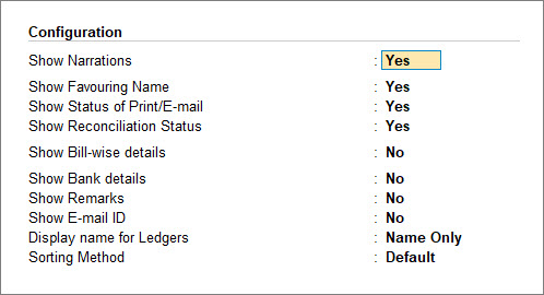

You can also configure the report by pressing F12 (Configuration).

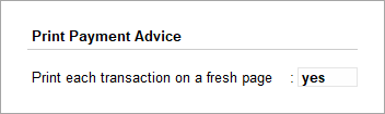

  2. Print each transaction or Payment Advice on a separate page.
    1. Press Spacebar to select more than one payment advice from the Payment Advice screen.
    2. Press Ctrl+P (Print).
    3. Set the option Print each transaction on a fresh page to Yes.
      payment-advise-on-fresh-page-tally
      If you want to print all the Payment Advice together, then disable Print each transaction on a fresh page.
    4. Press Ctrl+A to save.

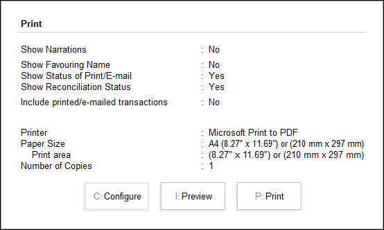

  3. Configure the print for payment advice.
    1.  Press Ctrl+P (Print) and press C (Configure).
    2. Payment Advice Date: By default, it displays the current date. Provide the required date.
    3. Show Bill-wise details: Enable this option to include the bill details in the payment advice. You can print the bill reference type as well.
    4. Show Party’s Contact details: Enable to include the party’s address and contact details in the payment advice.
    5. Show Transferred to: Enable to show the transferred information like A/c No, IFS code, and Bank Name which is applicable for Inter & Same Bank Transfer.
    6. Show instrument date: Enable to print the instrument number entered in the Bank Allocations screen.
    7. Show Due Date:  Enable to print the due date in the payment advice.
    8. Show Company’s PAN/Income Tax No.: Enable to print the PAN/IT No of the company.
    9. Payment Advice Configurations: To edit the content in Payment Advice such as Salutation, Signature.
    10. Press Ctrl+A to save the configurations.
  4. Press P (Print) to print the Payment Advice.
