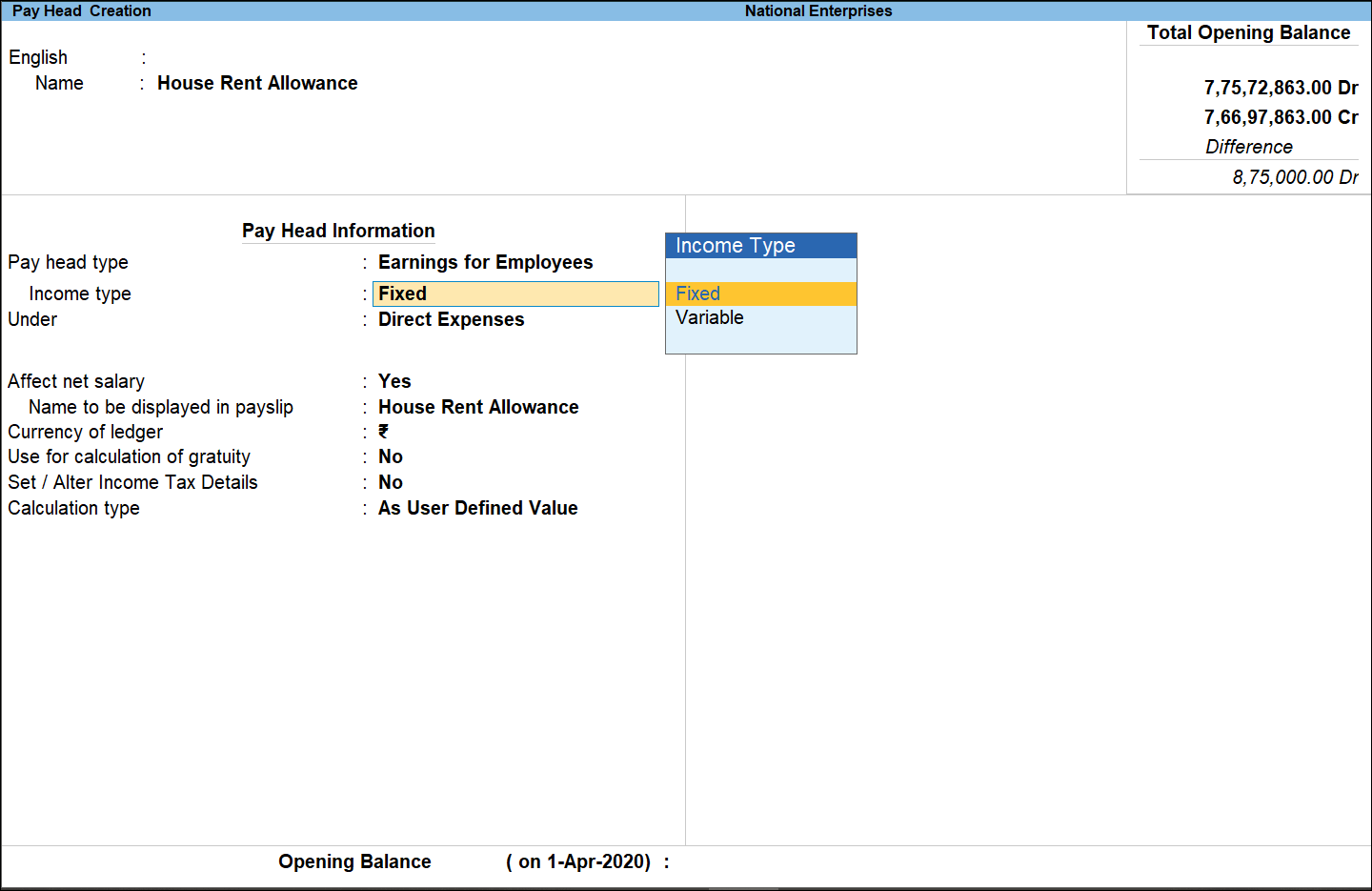

  3. Enter the pay head name in the Name field.
  4. Select Earnings for Employees from the List of Pay Head Types, in the Pay head type field.
  5. Select Income type for the pay head as:
    • Fixed: This forms a part of the employee’s Total Gross Salary. For example, Basic Pay.
    • Variable: This forms a part of the employee’s Total Earnings only. For example, Overtime Wages.
  6. Select Indirect Expenses from the List of Groups in the Under field.
  7. Set Affect Net Salary to Yes, if you want the pay head to affect the net salary. If you do not want this component to be included in the Pay Slip, type No.

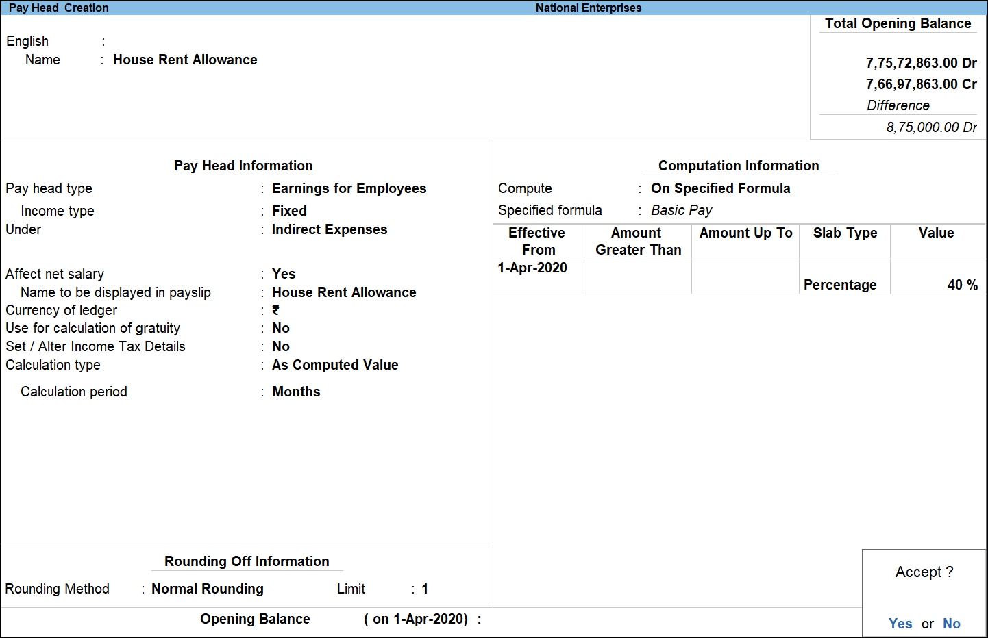

  14. Select As Computed Value from the List of Calculations in the Calculation type field. A new field Calculation period will appear, which is set to Months by default.
  15. Select the Rounding Method, if applicable. Enter the desired rounding limit.
  16. Select On Specified Formula from the Computation On list in the Compute field. The Compute sub-screen appears.
  17. Select Basic Pay from the List of Pay Heads in the Pay Head column.
  18. Select End of List to return to Pay Head Creation screen.
  19. Enter the desired date in the Effective Date field when the House Rent Allowance becomes applicable.
  20. Select Percentage from the List of slabs in the Slab Type field.
  21. Specify the required percentage for the Pay Head calculation in the Value field.
    Note: You can change the percentage calculation on the Salary Details creation screen for specific employees. To do this, In the F12 (Configure) Configurations screen, set Allow Override Slab Percentage to Yes.
  22. Accept the screen. As always, you can press Ctrl+A to save.
