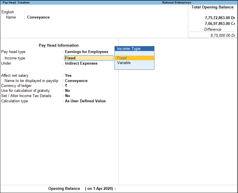

  4. Select Income type for the pay head.
    The Income type can be one of the following:
    • Fixed, which forms a part of the employee’s Total Gross Salary. For example, Basic Pay.
    • Variable, which forms a part of the employee’s Total Earnings only. For example, Overtime Wages.

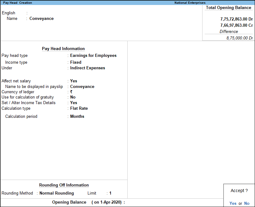

  13. Calculation type: Select the required method of calculation from the List of Calculation.
  14. Calculation Periods: Select the required calculation period from the List of Calculation Periods.
  15. In the Calculation period field, select the required calculation period from the List of Calculation Periods.
  16. Rounding Methods: Select the required Rounding off method from the Rounding Methods list and enter the required rounding limit in the Limit field.
  17. Accept the screen. As always, you can press Ctrl+A to save.
