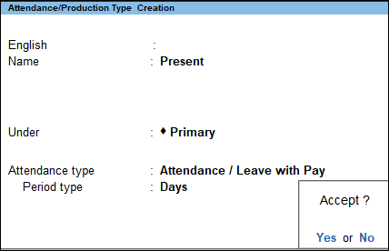

Attendance Type
You can define Attendance/Production Types with or without pay.
  • Attendance/Leave with Pay: Use this to record the positive attendance and leave with pay (For example, Present, Sick Leave, and so on.)
  • Leave without Pay: Use this to record negative attendance (For example, Absent, Leave Without Pay, and so on.)
Record positive attendance type
  1. Gateway of Tally > Create > type or select Attendance/Production Types > and press Enter.
    Alternatively, press Alt+G (Go To) > Create Master > Attendance/Production Types > and press Enter.
  2. Enter the Name of the attendance type.
  3. Select Primary from the list for the field Under.
  4. Select the Attendance type as Attendance/Leave with Pay. The Period type appears automatically.
  5. Accept the screen. As always, you can press Ctrl+A to save.
    You can create the Attendance Type Absent as Leave without Pay for recording negative attendance in the same manner.
    Note: You can maintain and process both the Negative (no. of Absent days) and Positive (no. of Present days) attendances for an employee to compute the salary.

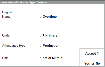

Production Types
Using the production type option, you can record the production details (for example, Piece Production, Overtime Hours, and so on).
  2. Enter the Name of the Production Type.
  3. Select Primary from the list, for the field Under.
  4. Select Production as the Attendance Type.
  5. Select the appropriate type of unit from the list, in the Unit field.
  6. Accept the screen. As always, you can press Ctrl+A to save.
    Similarly, you can create other production types according to your business requirements.
