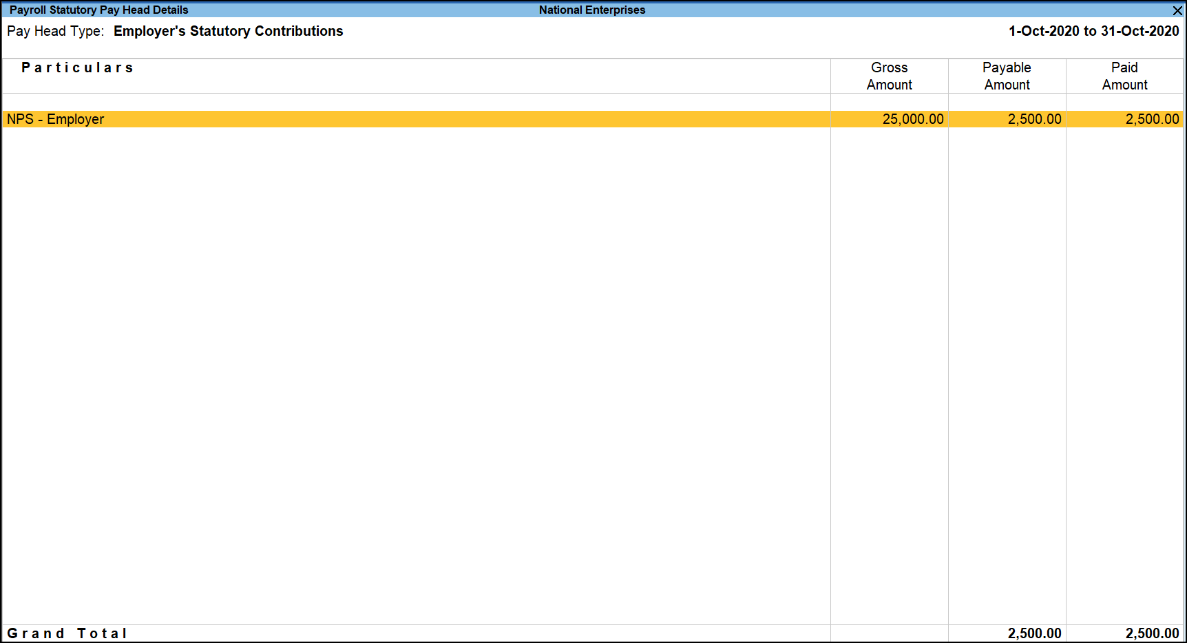

  2. Press Enter on the required Pay Head Type.
    The above report provides the Pay Head level Computation breakup for the required Pay Head Type.
    You can drill down to the Employee Breakup of Pay Head reports for the respective Pay Heads.

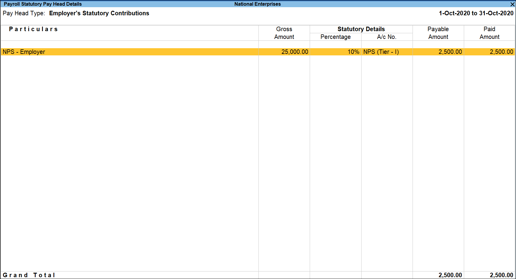

Button Options in the Payroll Statutory Pay Head Details
  • Press Alt+F5 (Detailed/Condensed): To view the Pay Head details with respective values.
    The above report displays the Percentage as specified in the Pay head, A/c No. in case of Provident Fund, Pay Head wise calculation details are also displayed in the detailed view.
    Press Alt+F5 again to return to the normal mode.
