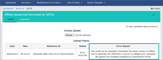

This error may appear while uploading the JSON file to the GST portal. Below are the possible solutions.

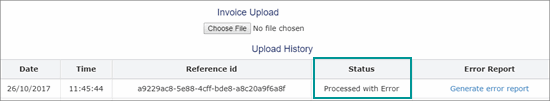

If the error appears again, and the Status is Processed with Error, then error report is generated in the GST portal.
generate-error-report
To know the cause, under the Error Report column click Generate error report.

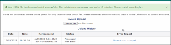

  1. Download the error report from the GST portal.
    1. On GST portal > Downloads > Offline Tools > Returns Offline Tool.
    2. Click Download to download the error report.
  2. Open the downloaded error report file. Refer to the Use the GST Offline Tool.

    Error in JSON structure validation. Cause: The GSTN portal cannot recognize the uploaded JSON file, or there are structural errors in the uploaded JSON file.
    Solution: Follow the steps below to resolve the error:
    • Ensure that the GSTIN is specified on the JSON file. If the same is blank or not available,
      1. Gateway of Tally > press F11 > set Enable Goods and Services Tax (GST) as Yes.
      2. Check whether the Company GSTIN is provided, if not provide the same and re-export the JSON file.
    • Secondly, ensure that the uploaded JSON file is the latest and has been exported from the latest TallyPrime Release.

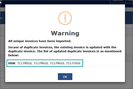

This issue may occur when multiple UQCs are being used for a single HSN, and HSN Code – HSN Description combination is not unique for each UQC for a given HSN code.
Workaround: If you have used multiple UQCs for a single HSN, you have to modify the descriptions and keep the HSN Code – HSN Description combination unique for each UQC for a given HSN code. You can do this by importing the Excel sheet or CSV file in the offline tool.
