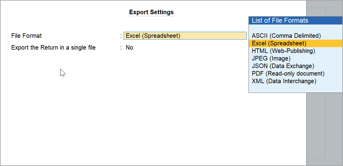

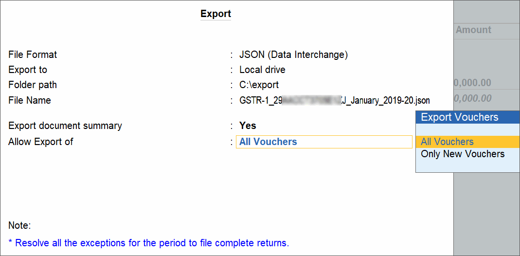

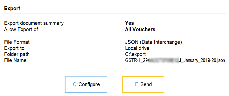

Once your GSTR-1 details are final, you can easily export them to a JSON, CSV, or MS Excel file, and sign your return. In this way, you can easily keep a tab on your finalised return and prevent any tampering. If your signed transactions are modified, then you can easily spot them in Uncertain Transactions.

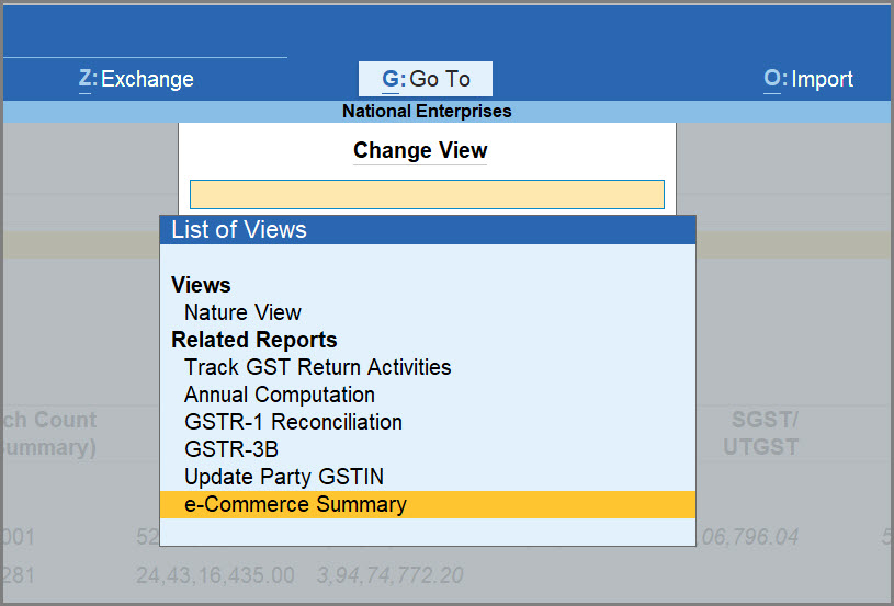

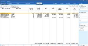

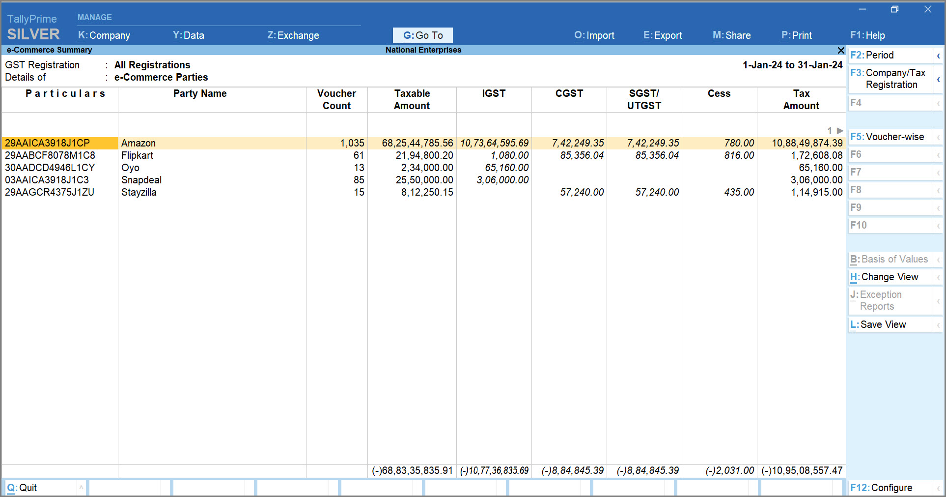

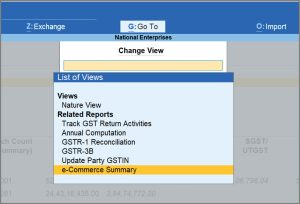

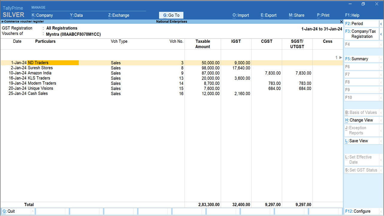

e-Commerce summary report
TallyPrime Release 4.1 has come up with an e-Commerce Summary to highlight taxable values and tax values, such as IGST, CGST, SGST, and Cess. Apart from that, the report will also contain information about GSTIN of the e-Commerce operators (e-TIN) and GSTIN-wise sales for the e-Commerce operators.
Thereby, you can enter the relevant details on the GST portal by referring to the e-Commerce Summary.

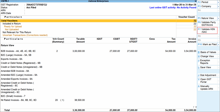

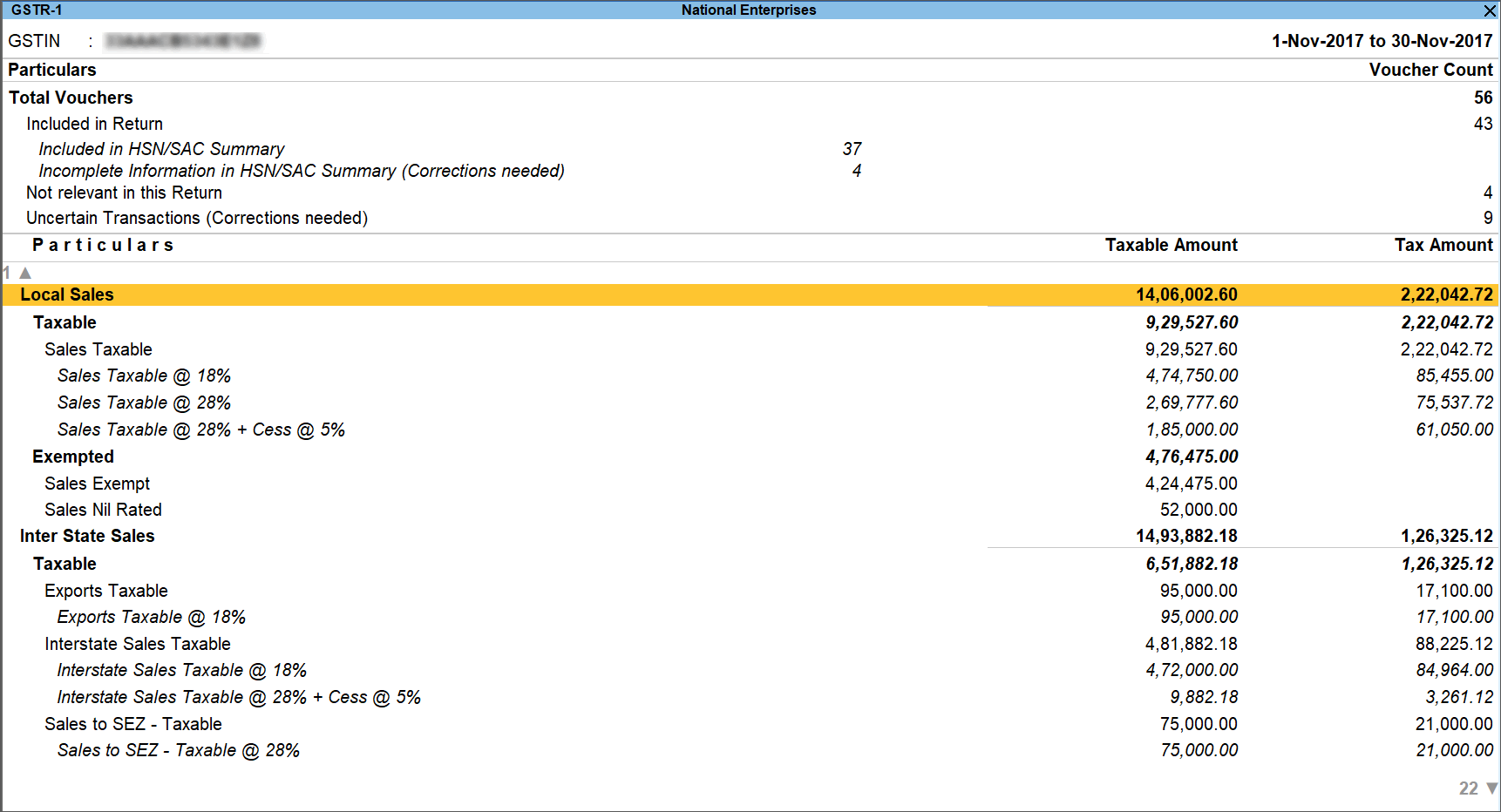

Total Vouchers | View Statistics & Verify Details

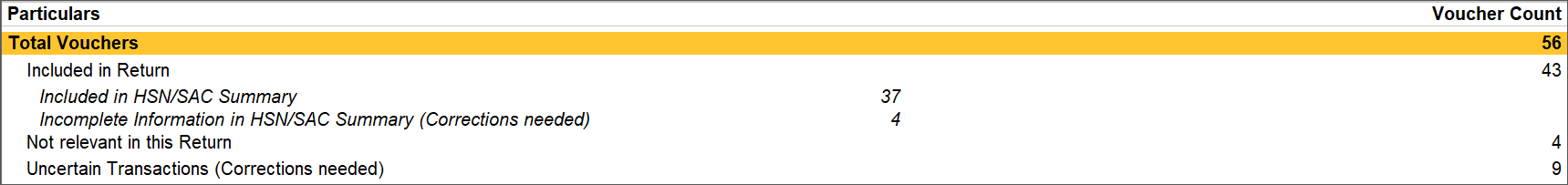

The Total Vouchers section gives you a bird’s eye view of the key numbers and details across your GST transactions. You will get a clear picture of the number of transactions included in the return, the transactions that are ready for export, the transactions where corrections are needed, and so on. You can drill down from each of these sub-sections to take a closer look at the transaction details.
The best part is that the Total Vouchers section evolves according to your actions in certain transactions. For example, after you export your transactions for GSTR-1 filing, the transactions will automatically appear in a new sub-section called No action Required. Similarly, if you are modifying certain GST details in a transaction that has been already exported, then it will be automatically listed under Modified in Books After Export.
What’s more, you also have the option to see if any actions are pending in other return periods. Depending on your choice (set in Basis of Values), the Total Vouchers section will include an extra column (such as Vouchers with Pending Actions of Earlier or Future Periods), which will give you a clear view of the vouchers pending in different periods.
The Total Vouchers section will display the following sections, based on your actions and transactions.

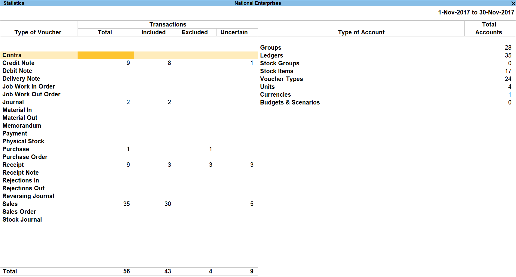

Total Vouchers
Total Vouchers gives you an overall count of the vouchers involved in GSTR-1. You can drill down to the Statistics screen for a detailed breakup of the type of vouchers involved. For example, you can see how many journal vouchers are included in the return, and how many are not relevant or uncertain. The best part is that you can further drill down to see the full list of journal vouchers that have been recorded during the return period.

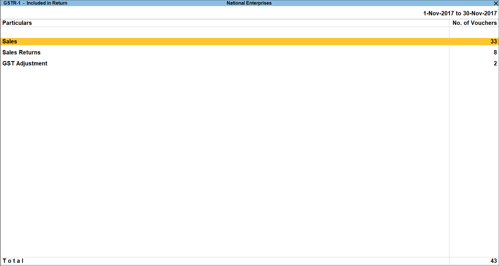

Included in Return
Included in Return gives you an overall count of the vouchers included in GSTR-1. You can further drill down for a detailed breakup of the type of vouchers involved. For example, you can see how many sales returns are included in the return. The best part is that you can further drill down to see the full list of sales returns that have been recorded during the specified period, and also set the Effective Date and GST Status, as needed.
Ready for Export
Ready for Export gives you an overall count of the vouchers that are ready to be exported to the portal for filing GSTR-1. This includes transactions that have not yet been exported, or were modified in your books after being exported.
You can further drill down for a detailed breakup of the type of vouchers involved. For example, you can see how many sales transactions are all set to be exported. The best part is that you can further drill down to see the full list of sales transactions that have been recorded during the specified period, and also set the Effective Date and GST Status, as needed.

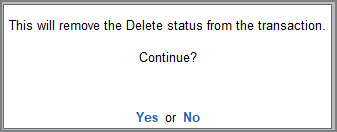

Reset Delete Request allows you to remove the delete request for a voucher that is valid in the current Return period but was uploaded to the portal with a delete request in the earlier period.
  1. Press Alt+G (Go To) > GSTR-1 > Marked for Deletion on Portal > select the transactions
  2. Press Alt+Q (Reset Delete Request).
    A confirmation message appears on the screen, as shown below:
    reset-delete-request
  3. Select Yes to remove the delete status from the transaction.
The transaction no longer appears under Marked for Deletion on Portal in the GST report.

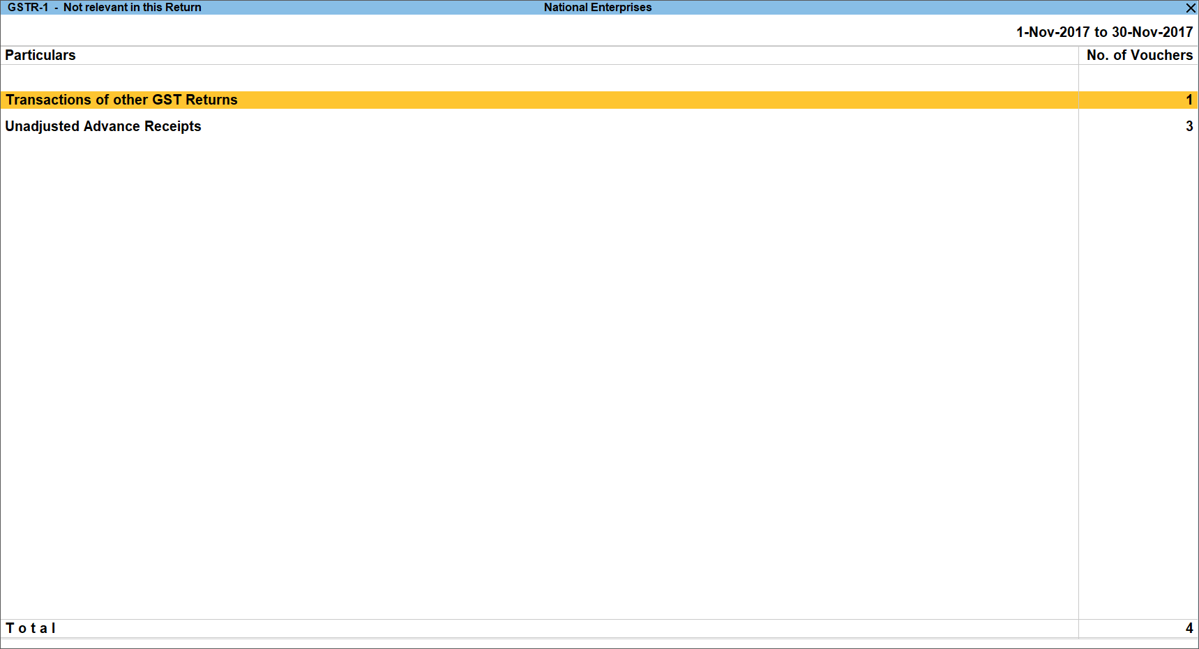

Not Relevant for this Return
Not Relevant for this Return gives you an overall count of the vouchers that are not required to be filed in GSTR-1 in the selected period. This includes transactions of other registrations, returns, or return periods, and also includes non-GST transactions (such as payroll, inventory, and order vouchers) and transactions that were consciously excluded by you.
You can further drill down to view the different categories of transactions. For example, you can see how many non-GST transactions are present. The best part is that you can further drill down to see the full list of voucher types, such as credit notes, journals, payments, and receipts.

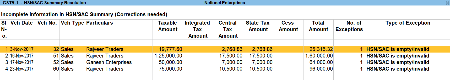

Uncertain Transactions (Corrections needed)
Uncertain Transactions gives you an overall count of the vouchers with GST-related errors. You can drill down further from the section to view all such uncertain details and correct them. Even if you have hundreds of transactions, you can easily find and fix a particular error. Refer to the Resolve Uncertain Transactions section to know more.

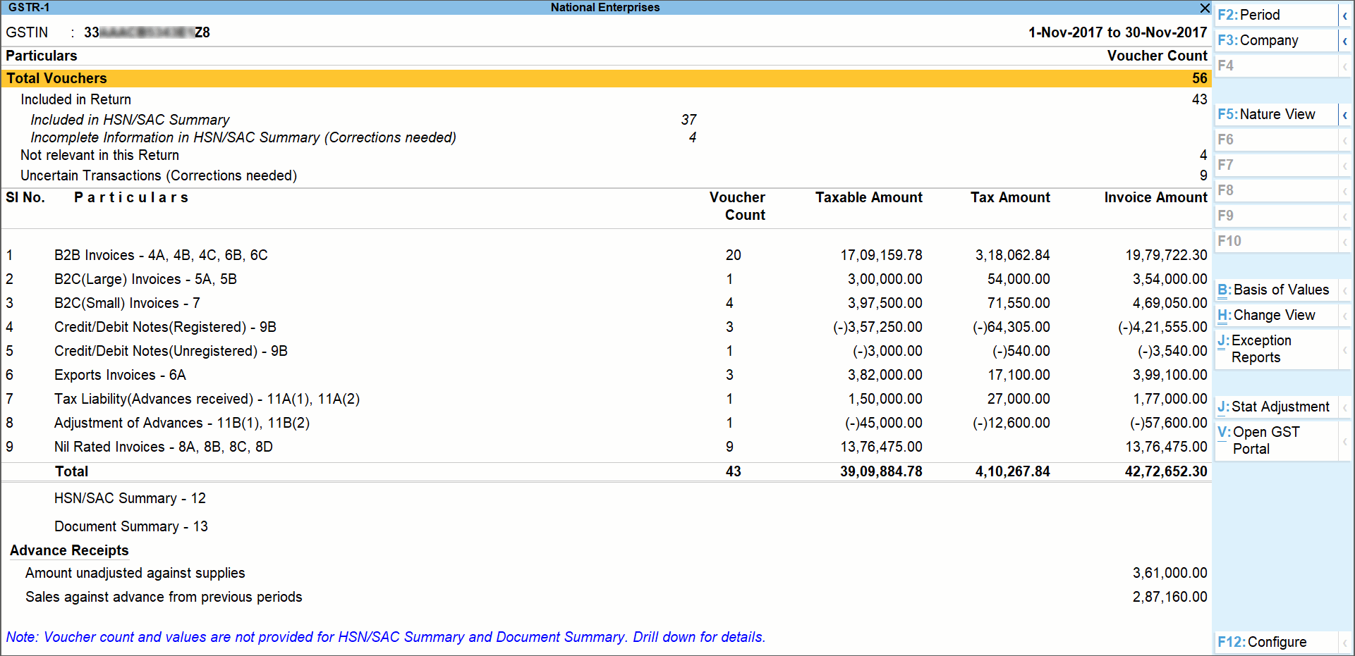

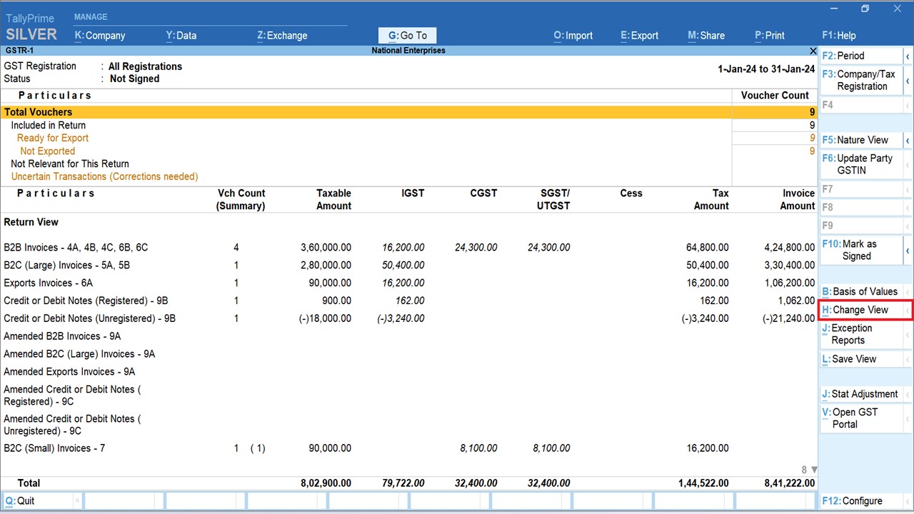

Return View | View GST Details in the Portal Format

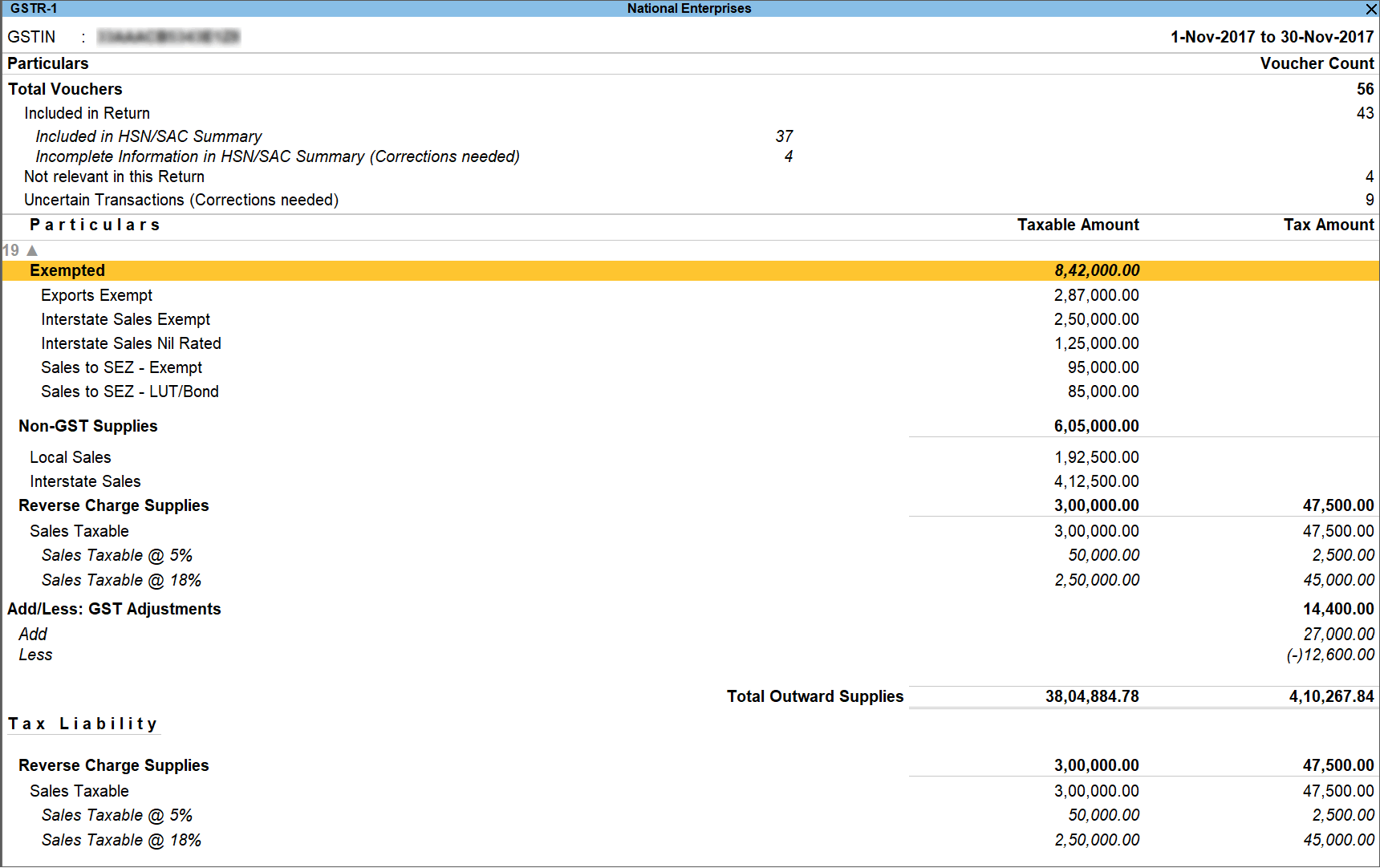

The Return View section is your personal map of the GSTN portal. Every section or table on the portal is faithfully represented in this section, so that you can conveniently share the data with the tax department. The best part is that you don’t have to do anything extra from your end. Depending on the nature of a particular transaction, TallyPrime will capture all your transaction in the respective sections or tables. For example, all your sales to registered parties will be captured under B2B Invoices – 4A, 4B, 4C, 6B, 6C.

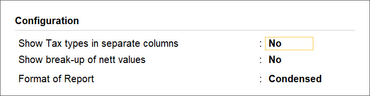

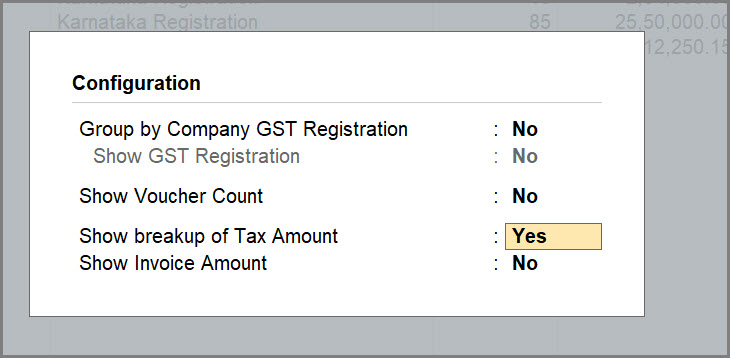

Moreover, you also have the option (in F12 (Configure)) to hide the sections that have no transaction value during a certain period. This way you will have a clean view of only the sections that are necessary for reporting to the portal.
The Return View section will display the following sections, based on your transactions during the period.

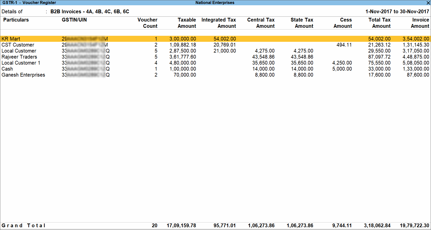

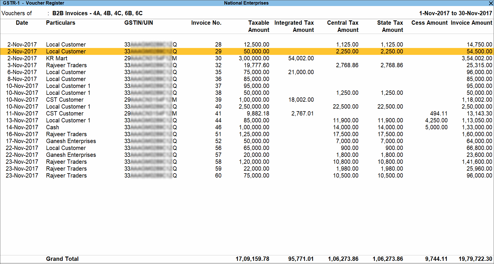

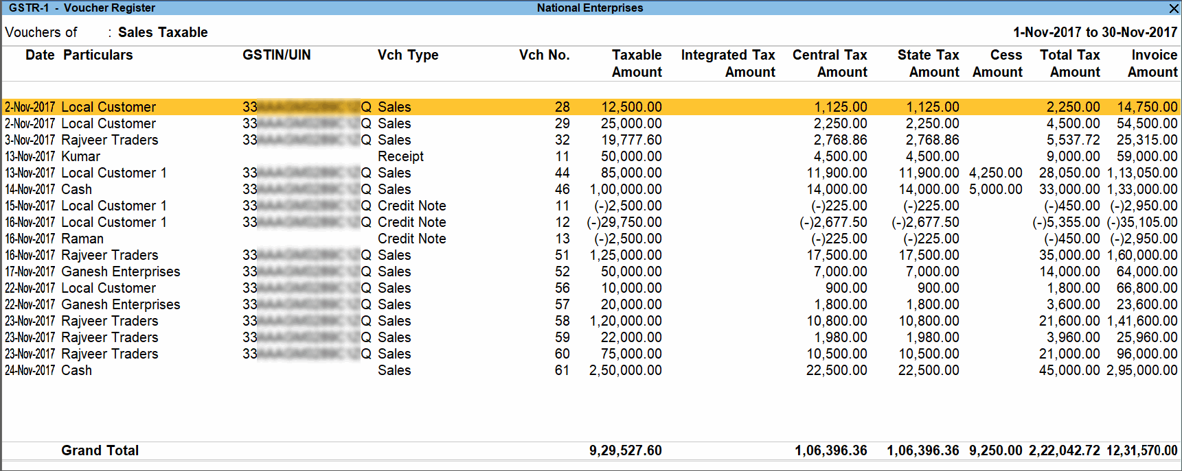

This section will capture all your taxable sales that were made to regular and composite dealers. If your tax invoice has exempt and nil-rated items along with taxable items, then the total invoice value will be captured here.
However, if you want to capture the values of only the taxable items as a B2B invoice, then, as per GST rules, you have to record separate invoices for the taxable items. Furthermore, you have to use separate invoices (bill of supply) for the sale of exempt or nil-rated items.
You can further drill down to view the full list of B2B invoices that were recorded during this period, along with relevant details such as party name, GSTIN/UIN, tax amount, and so on.

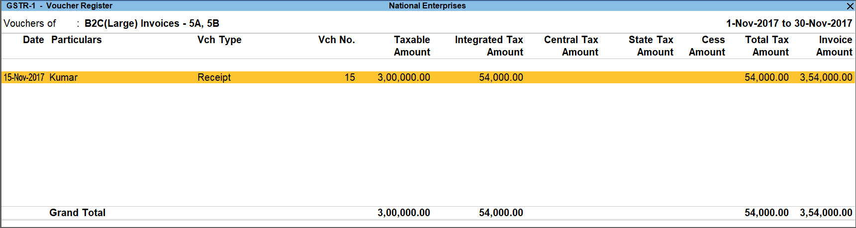

B2C (Large) Invoices – 5A, 5B
This section will capture all your large sales (exceeding Rs 2.5 lakh) that were made to unregistered dealers and consumers. You can drill down from this section to view the full list of B2C invoices that were recorded during this period, along with relevant details such as party name, tax amount, and so on.

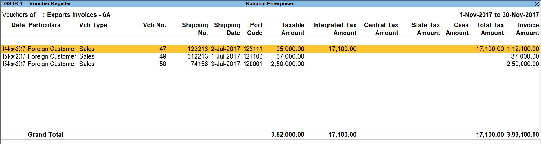

Exports Invoices – 6A
This section will capture the values of export sales recorded during a certain return period. Export sales transactions includes transactions such as Exports Taxable, Exports – LUT/Bond, Exports Exempt, and Exports Nil Rated. You can drill down from this section to view the full list of export invoices, along with relevant details such as shipping number, shipping date, and port code.
If the shipping number, shipping date, and port code are not visible in this drill-down report, then you have to enable the relevant options by pressing F12 (Configure).

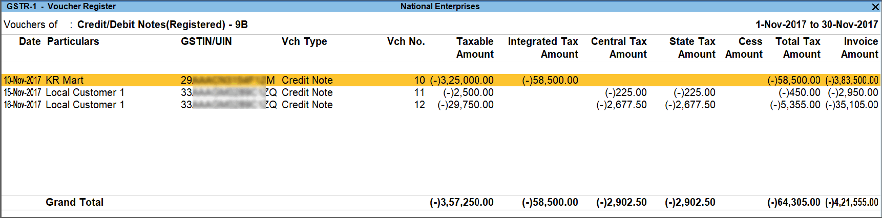

Credit or Debit Notes (Registered) – 9B
This section will capture all your credit or debit notes that were issued to regular and composite dealers. You can further drill down to view the number of credit or debit notes issued to each party, along with other relevant details such as GSTIN/UIN, tax amount, and so on.

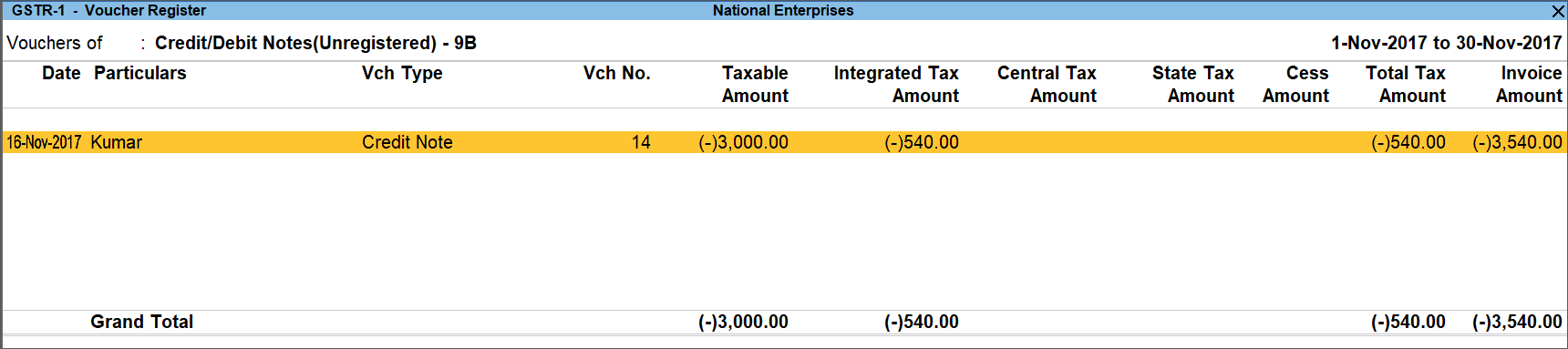

Credit or Debit Notes (Unregistered) – 9B
This section will capture all your credit or debit notes that were issued to unregistered dealers and consumers. You can further drill down to view the number of credit or debit notes issued to each party, along with other relevant details such as tax amount, invoice amount, and so on.

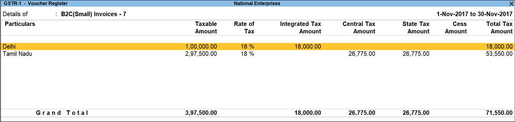

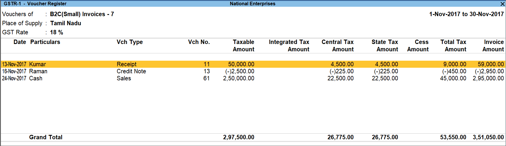

B2C (Small) Invoices – 7
This section will capture all your small sales (below Rs 2.5 lakh) that were made to unregistered dealers and consumers. You can drill down from this section to view the full list of B2C invoices that were recorded during this period, along with relevant details such as party name, tax amount, and so on.

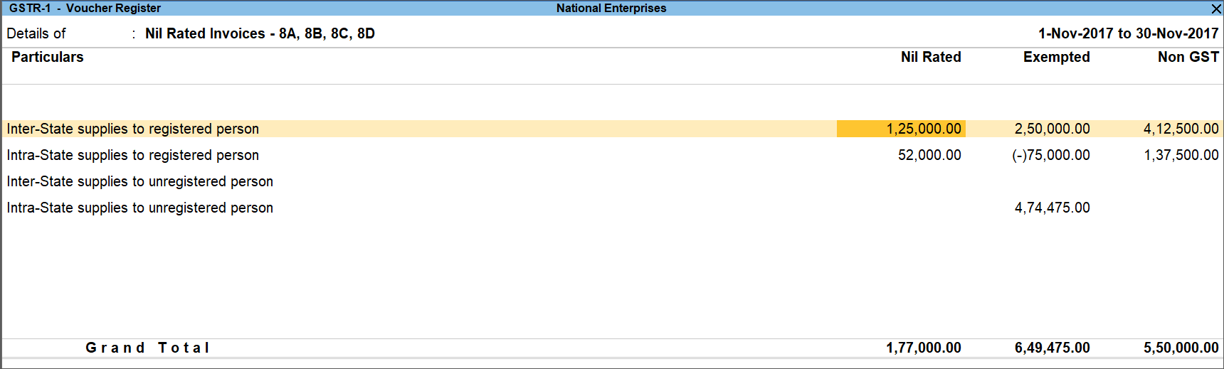

Nil Rated Invoices – 8A, 8B, 8C, 8D
This section will capture all your sales transactions on which GST is not levied. This includes nil-rated, exempt, and non-GST outward supplies made to registered and unregistered dealers.
You can drill down from this section to view the net and total values of Nil Rated, Exempted, and Non-GST sales.
What’s more, you can scroll to each of the above three columns and drill down further to view the full list of transactions with the relevant details.

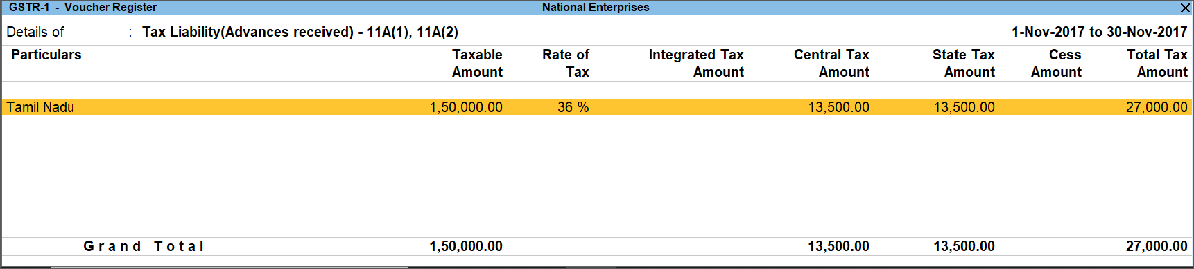

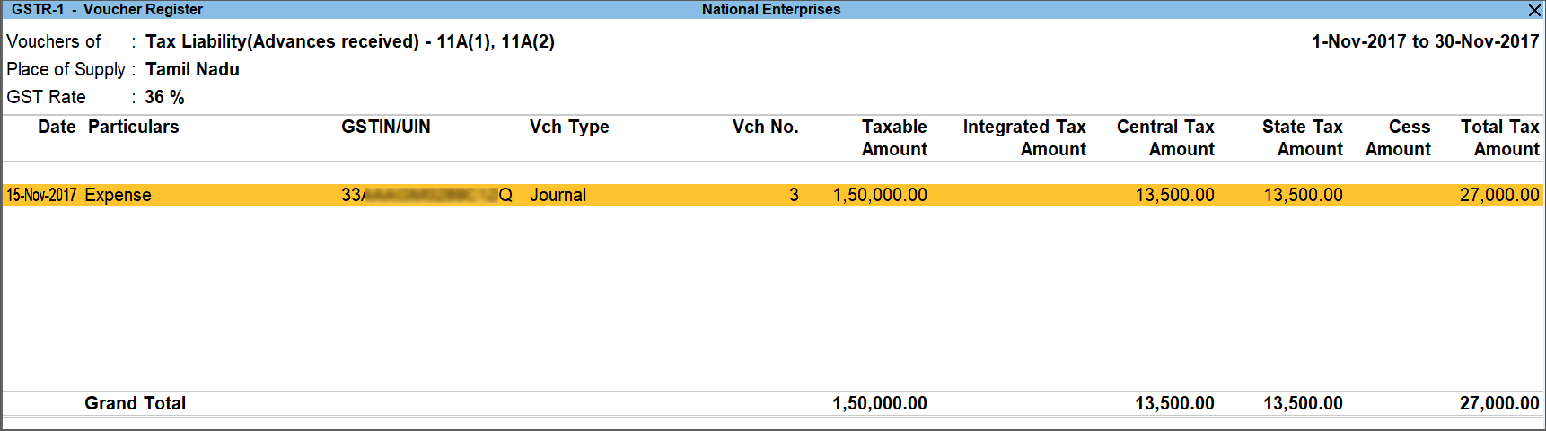

Tax Liability (Advances Received) – 11A(1), 11A(2)
This section will capture all your taxable sales for which you had received advances from your party, but you are yet to record an invoice. You would have recorded the credit values of tax using a journal voucher.
You can drill down further to view the full list of journal vouchers along with the break-up of the advanced received during the period.

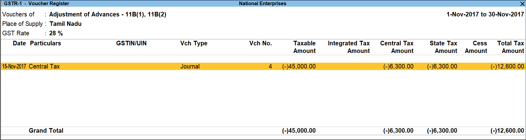

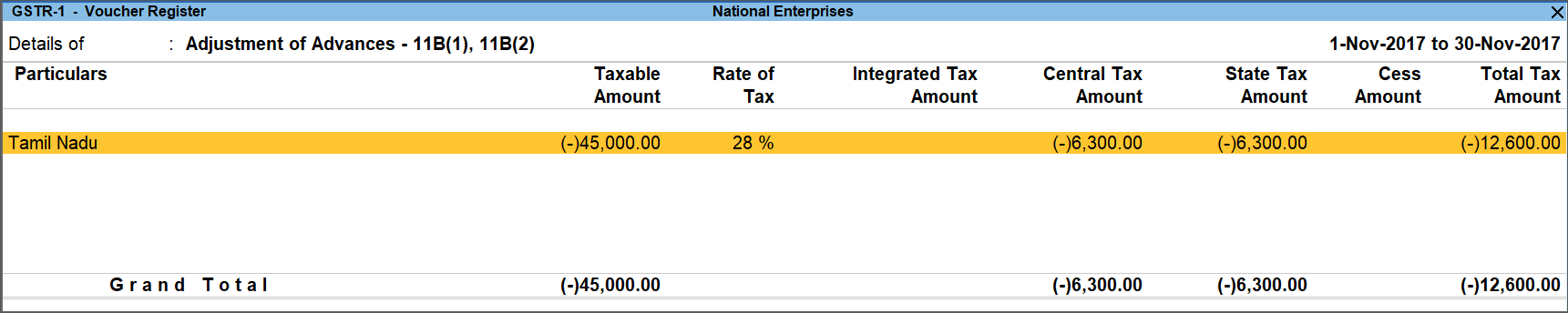

Adjustment of Advances – 11B(1), 11B(2)
This section will capture all the invoices for which you had received advances and already paid taxes in an earlier month. You would have recorded the debit values of tax using a journal voucher.
You can drill down further to view the full list of journal vouchers along with the break-up of the advanced adjusted from an earlier period.

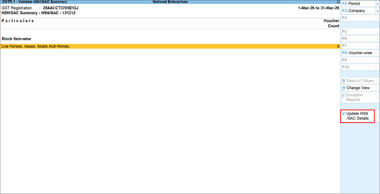

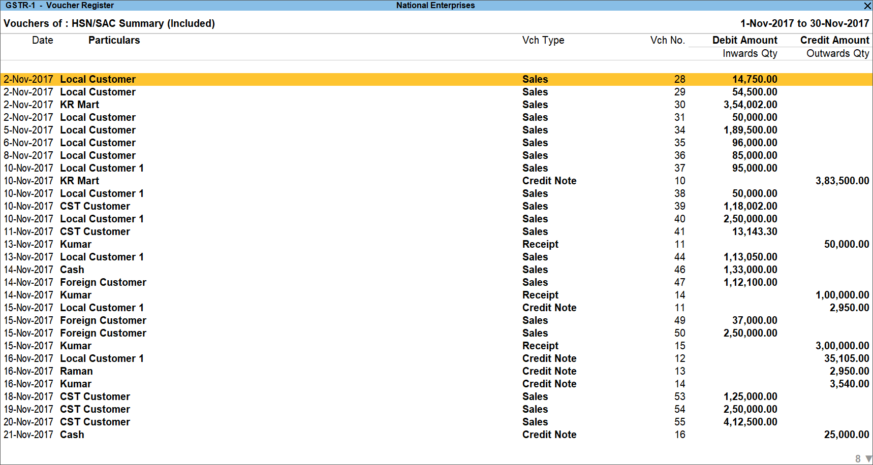

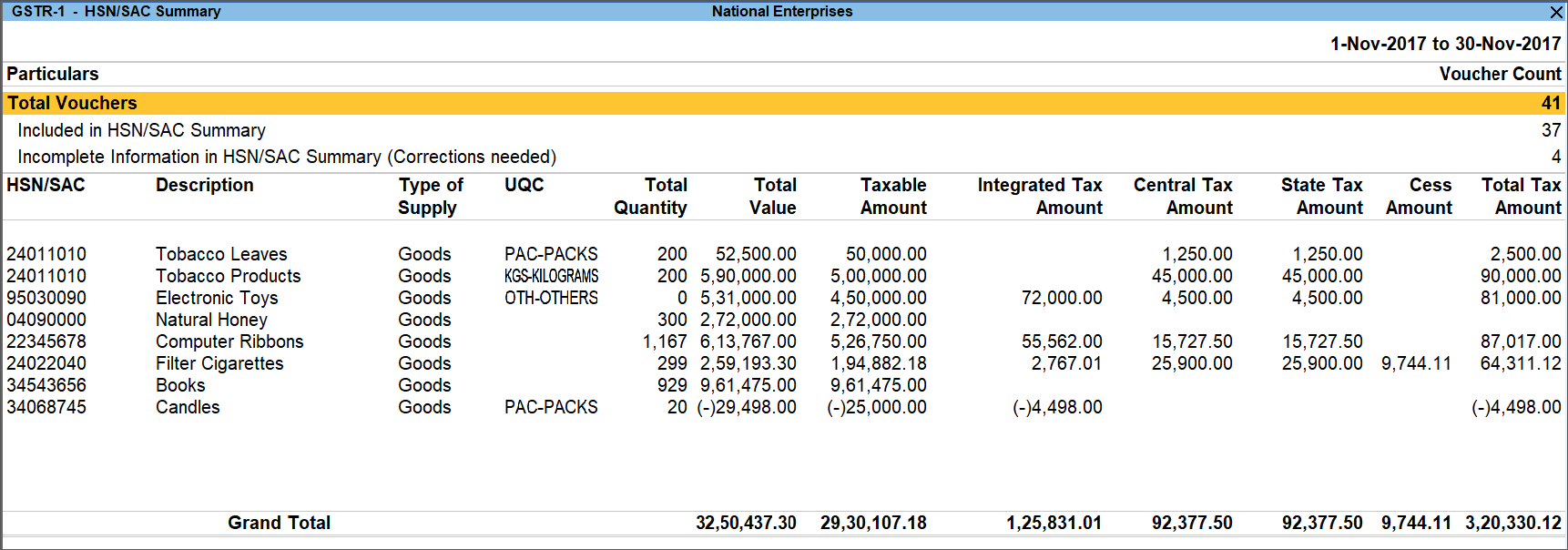

HSN Summary – 12
The HSN/SAC Summary report captures the tax details for all the HSNs/SACs used in your transactions. The best part is that these details will be neatly captured against each of your GST registrations. You can also view the details only for a specific registration by pressing F3 (Company/Tax Registration) and selecting the required registration.
You can drill down from each registration to view all the HSNs/SACs used in your transactions in the selected period.
What’s more, you can further drill down from each HSN/SAC to view all the corresponding transactions, along with relevant details such as UQC, tax amount, and taxable amount.

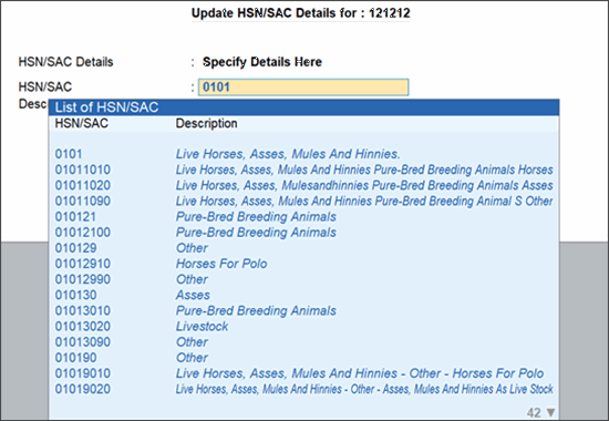

What’s more, you can also easily make alterations to the HSN Summary (by pressing Alt+V (Alter Summary)) before exporting it to the portal.

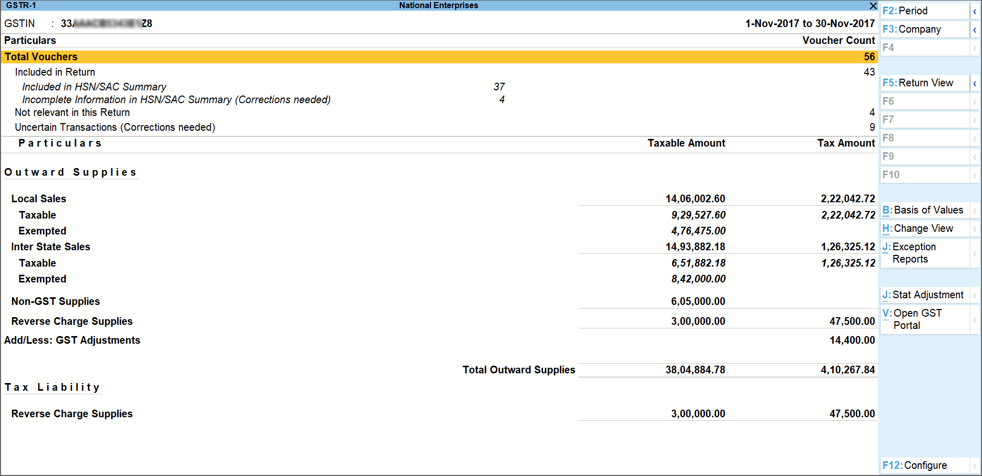

Nature View | View GST Details as per Company Books
Within the context of the GSTR-1 report, TallyPrime provides you with a quick and easy way to compare your return data with the data in your company books. To view these details, you simply have to change the view from Return View to Nature View. The Nature View section provides a general categorisation of your GST sales, based on the nature of the transaction. You can view essential GST groups such as Local Supplies, Interstate Supplies, Exports, SEZ, and so on, with a breakup of taxable, exempt, nil-rated, and non-GST supplies.
Using the Nature View, you can quickly compare the GST details with the details in your company books, that is, in the Profit & Loss report, Sales Register, or Chart of Accounts. This will help you greatly in identifying and resolving any errors in your data before you can finalise the return.
In the Nature View section, you will find that all your outward supplies are conveniently categorised into the following four groups, based on your transactions during the period.

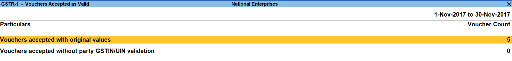

View Transactions Accepted as Valid
While verifying the uncertain transactions, you might have accepted a few transactions details as valid. However, before finalising your return, you may want to cross-check such transactions to ensure that the details are indeed correct. The Transactions Accepted as Valid report will help you greatly in this regard by listing all such transactions that were accepted as is.
From TallyPrime Release 5.1, any transaction that you have accepted as is, will continue to appear under Included in Return in GSTR-1 report. If you have made any changes related to GST and then resaved the voucher, in such case the voucher will appear under Uncertain Transactions in GSTR-1 report.
To view the Transactions Accepted as Valid report in GSTR-1, press Ctrl+J (Exception Reports) > Transactions Accepted as Valid. You will find that the transactions have been neatly grouped into three categories:
  • Mismatch between Expected and Modified Tax Amounts in transaction
  • Transactions accepted as is (Format)
You can drill down from one of the above categories to view the full list of such transactions recorded in the selected period. If you think that certain details were incorrectly accepted as valid, then you can select the required entry and press Alt + J (Undo Accept As Is) to undo the accepted details. The transaction will now be moved back to the Uncertain transactions section.
Export GSTR-1
Once you have verified your GSTR-1, you can easily share these details with the tax department. You only have to export the details in the required format, and upload it to the portal. All your GST data from TallyPrime will appear seamlessly on the portal.
  1. In the GSTR-1 report, press Alt + E (Export) > GST Returns. The Export GSTR-1 screen will open, where you can select the required period, company, or tax registration. You also have the option to switch to GSTR-3B, if needed.
  2. Press F8 (Include Uploaded/Exclude Uploaded) to include or exclude the exported transactions while viewing the report.
    This is applicable from TallyPrime Release 5.0 onwards.
  3. Explore and set the required options in Ctrl + B (Basis of Values):
  4. Explore and set the required options in F12 (Configure):
  5. Select the transactions and/or summaries that you want to export to the portal for filing, and press X (Export).
    The Export screen will appear as shown below:
  6. Configure the options for File Format, section-wise export, and Folder Path, if needed.
  7. Press E (Send) to export.
The exported file will be saved in the selected Folder Path, which will be automatically opened by TallyPrime. Now you can proceed to upload the file on the GSTR-1 portal.
Similarly, you can also print or e-mail your return from the GSTR-1 report, if needed.
Export GSTR-1 for multiple periods in one Excel file
From TallyPrime Release 5.1, you can now export the GSTR-1 data for multiple periods into one Excel file. You do not have to export month-wise data and consolidate them to share with your auditor. If you have multiple registrations, and you want to export data for a single registration, then in the GSTR-1 report, press F3 and select the required registration and export. You can also export the data for all registrations to the Excel file.
Export-GSTR-1-for-multilple-period
  1. Open the GSTR-1 report.
    1. Press Alt+G (Go To) and type or select GSTR-1.
    2. Press F2 (Period) and enter the period.
      You can see the data for the selected period.
  2. Export the GSTR-1 data.
    1. Press Alt+E (Export) > Current > press C (Configure).
    2. In the File Format, select Excel (Spreadsheet).
      The Export Settings screen appears.
      export-setting
    3. Set Export the Return in a single file to Yes.
    4. Press Ctrl+A to save the Export Settings screen.
    5. Press E (Export).
In the Excel file, each section of GSTR-1 report is on a different worksheet. You can see your data for the entire period in the relevant worksheet.

In the GSTR-1 report, you get the summary section that gives you a summary of the vouchers in your books, and the return details. You can view the return details in two formats – Return Format and Summary Format.
  1. Gateway of Tally > Display More Reports > Statutory Reports > GST > GSTR–1. The report displays the data for a month or quarter depending on the Periodicity of GSTR-1 set in the Company GST Details screen.
    Alternatively, Alt+G (Go To) > type or search GSTR-1 or Returns or GST > select and press Enter.
  2. Press F5 to switch between Return View and Nature View.
    Alternatively, press Ctrl+H (Change View) and select Nature View or Return View.
The F5 button is used to change between multiple views across the reports or returns. You can quickly access other formats in which the report can be presented using this button.

The Particulars section at the top of the report provides an overview of your transactions in the selected return period. You can view the transactions that were considered or excluded from returns, and resolve uncertain transactions.
This section consists of the following:
  • Total Vouchers : Drill-down shows the Statistics report, listing the vouchers participating in the GST return.
  • Included in Return: Drill down from this row to view the Summary of Included Vouchers report, with the list of voucher-types with voucher count.
    • Included in HSN/SAC Summary: Drill down from this row to view the transactions included in HSN/SAC summary.
    • Incomplete Information in HSN/SAC Summary (Corrections needed): Drill down from this row to view the transactions that are included in returns but are not in HSN/SAC Summary.
  • Not relevant for returns: Drill down from this row to view the Summary of Excluded Vouchers report, with the transaction type-wise voucher count.
    Other transaction types that can appear under excluded vouchers:
  • Excluded by User: Manually excluded by you from the list of included or uncertain transactions. Drill down and use H: Include Vouchers, if required. Based on the information in the voucher it will move to either included or uncertain.
  • Contra Vouchers: The count of contra entries which involve only bank and cash ledgers.
  • Order Vouchers: The count of sales order, purchase order, job work in order, and job work out order vouchers.
  • Inventory Vouchers: The count of receipt note, stock journal, delivery note, material in, material out, rejections in, rejections out, and physical stock vouchers as they are purely inventory in nature and do not attract GST.
  • Payroll Vouchers: The count of transactions recorded using payroll and attendance vouchers. GST does not apply to these transactions.
  • No GST Implications: The count of receipts, payments, and journal vouchers that do not have any GST implication.
  • Other voucher: The count of memorandum and reversing journal vouchers.
  • Non GSTR-1 Transactions: The transactions which are part of other returns, for example: GSTR – 3B, and hence will not have any implication on GSTR–1.

The values computed for the periodic return can be viewed in two formats – Return View and Nature View.
In the Return View, you can view the details of your outward supplies in the table-wise format of GSTR-1 as prescribed by the department. The outward supplies include B2B/B2C invoices, exports, adjustments of advances, and so on are presented in respective tables.
In the Nature View, you can get a general overview of your local and interstate transactions, along with a clear view of the non-GST and reverse charge supplies. To return to the Return View, you only have to press Alt+V.
In this section
Return View
The GSTR-1 report displays the data for a month or a quarter depending on the Periodicity of GSTR-1 set in the Company GST Details screen.
As per the department requirements, you can see the following sections in the Return format. You can drill down to view the list of transactions under each of these sections.
1 B2B Invoices – 4A, 4B, 4C, 6B, 6C
Taxable sales made to regular and composite dealers are captured here. If your tax invoice had exempt and nil rated items along with taxable items, then the total invoice value is captured here.
If you want to capture the values of only the taxable items as a B2B invoice, as per GST rules record separate invoices for taxable items. Use separate invoices (bill of supply) for sales of exempt/nil rated items.
Nature of transaction
Taxability
Registration type
Sales Taxable
Interstate Sales Taxable
Sales Exempt
Interstate Sales Exempt
Interstate Sales to Embassy/UN Body Exempt
Interstate Sales to Embassy/UN Body Nil Rated
Interstate Sales to Embassy/UN Body Taxable
Sales Nil Rated
Interstate Sales Nil Rated
Sales to SEZ – Exempt
Sales to SEZ – LUT/Bond
Sales to SEZ – Taxable
Deemed Exports Exempt
Deemed Exports Taxable
Deemed Exports Nil Rated
Intrastate Deemed Exports Taxable
Intrastate Deemed Exports Exempt
Intrastate Deemed Exports Nil Rated
Taxable
Exempt
Nil Rated
Regular
Composite
The party-wise drill down report appears as shown below:
The transaction-wise drill-down report for each party appears as shown below:
2 B2C(Large) Invoices – 5A, 5B
  • Unregistered party selected in the Party Details screen for sales made by selecting e-commerce operator in the Party’s A/c Name field.
  • When a taxable stock item is selected along with exempted or nil-rated goods, then the values are captured here. If only exempted or nil rated goods are selected, it will appear under the Nil Rated Invoices table of GSTR-1 report.
  • Interstate sales of more than Rs. 2,50,000 to unregistered dealers and consumers are captured here.
Registration type
Unregistered
Consumer
The Voucher Register appears as shown below:
3 B2C(Small) Invoices – 7
Displays the net value of sales.
  • Interstate sales of equal to or less than Rs. 2,50,000 to unregistered dealers and consumers are captured here.
Taxability
Registration type
Sales Taxable
Sales to Consumer – Taxable
Sales to Consumer – Exempt
Sales Nil Rated
Sales Exempt
Taxable
Exempt
Nil Rated
Unregistered
Consumer
The Voucher Register based on place of supply, appears as shown below:
The transaction-wise drill-down report for each place of supply, appears as shown below:
4 Credit/Debit Notes (Registered) – 9B
Displays the values of credit and debit notes, recorded in the reporting period.

5 Credit/Debit Notes (Unregistered) – 9B
Displays the values of credit and debit notes, recorded in the reporting period with the following details:
Nature of transaction as:
  • Interstate Sales Taxable and Interstate Sales Exempt – sales returns made against 2 B2C(Large) Invoices – 5A, 5B table
  • Exports Taxable
  • Exports LUT/Bond
  • Exports Exempt
  • Exports Nil Rated
Journal voucher recorded by debiting GST ledgers, with:
  • Nature of Adjustment – Decrease of Tax Liability
  • Additional Details – Cancellation of Advance Receipts or Cancellation of Advance Receipts for Exports/SEZ sales
6 Exports Invoices – 6A
Displays the values of export sales recorded in the reporting period with the following details:
  • Exports Taxable
  • Exports – LUT/Bond
  • Exports Exempt
  • Exports Nil Rated
The Voucher Register of Export Invoices – 6A appears with details of shipping number, shipping date and port code.
7 Tax Liability (Advances received) – 11A(1), 11A(2)
Displays the credit values of tax entered in journal vouchers recorded with the following details:
Nature of Adjustment – Increase of Tax Liability
Additional Details
  • On Account of Advance Receipts
  • Advance Receipts for Export/SEZ sales
The requirement to pay tax on advance receipts from customers for supply of goods has been withdrawn. However, tax on advance for supply of services is applicable.
The value from transactions recorded for tax liability on advance receipt from customers will not be included in the GSTR-1 returns by default. Such transactions will be under Not relevant for returns in the GSTR-1 report. The businesses supplying services can enable the same by setting the option Enable tax liability on advance receipts to Yes in the Company GST Details screen.
The voucher register based on place of supply appears as shown:
The transaction-wise drill down report for each place of supply appears as shown:
8 Adjustment of Advances – 11B(1), 11B(2)
Displays the debit values of tax entered in journal vouchers recorded with the following details:
Additional Details
  • Sales against Advance Receipts
  • Sales against Advance Receipts for Export/SEZ sales
9 Nil Rated Invoices
Displays the net values of nil rated, exempt, and non-GST outward supplies made to registered and unregistered dealers, within and outside the state.
HSN/SAC Summary – 12
HSN/SAC Summary report contains the details of HSN/SAC-wise taxable value and tax amount.

Nature View
The Summary Format displays the local and interstate transactions based on GST and non-GST outward supplies.
  • Press F5 to change view from Return View to Nature View and vice versa.
  • Press Alt+F5: Detailed to view the breakup of sales based on tax rates.
Outward Supplies
The total local and interstate sales are divided into Taxable and Exempted. To view all the sales transactions,
  1. Click Alt+F5: Detailed to display the report in detailed mode.
  2. Select any of the rows displayed in italics, under Local Sales or Interstate Sales.
  3. Press Enter to display the Voucher Register screen.
  4. Click V: Voucher-wise.
You can view this report ledger wise or commodity wise by clicking Alt+F8: Ledger-wise or Ctrl+F8: Stock item-wise, and F8: Party-wise respectively.
Vouchers Accepted As Valid
In the GSTR-1 report, press Ctrl+A to view the list of vouchers that were accepted as valid and included in the returns.
Alternatively, press Ctrl+J (Exception Reports) and select Vouchers Accepted as Valid.
Vouchers accepted with original values: The vouchers accepted as valid from the following exceptions, appear here:
  • Nature of transaction, Taxable value, rate of tax modified in voucher.
  • Mismatch due to tax amount modified in voucher.
Press Enter to view the vouchers. To move the vouchers out of this list and make the required corrections, click Alt+J: Remove Accept As Is and press Enter. The voucher moves to the relevant exceptions.
Vouchers accepted without party GSTIN/UIN validation: The vouchers that were accepted by clicking C: Accept GSTIN/UIN in the Information required for generating table-wise details not provided exception of GSTR-1, appears here. Press Enter to view the vouchers.
  • Click  Alt+V: Validate GSTIN/UIN.
  • Press Enter.
The voucher moves to the exception Mismatch due to tax amount modified in the voucher.
Generate Returns
Once you are satisfied with the details of your transactions, you can generate a return file in the JSON or MS Excel format.
  1. Go to Gateway of Tally > Display > Statutory Reports > GST > GSTR-1.
  2. F2: Period: Select the period for which returns need to be filed.
  3. F12: Configure: To view the export options for HSN/SAC details, enable Show HSN/SAC Summary?
  4. Press Alt+E and select E-Return.
  5. Select JSON (Data Interchange) as the File Format to directly upload the generated file in GST portal. Select Excel (Spreadsheet) or CSV (Comma delimited) as the Format to use the offline tool to generate JSON file.
  6. Specify the Folder path.
  7. Allow Export of:
    • All Vouchers: Select this option to export all the transactions that have been already filed on the GST portal.
    • Only New Vouchers: Select this option to export the transactions that are not filed on GSTN portal.
  8. Press Enter to export.
Upload the JSON file generated from TallyPrime to the portal for filing returns. If you have selected the CSV format, TallyPrime will create separate CSV files for each table in GSTR-1. These files need to be imported into the GST Offline Tool.
If $ symbol appears in the data exported to MS Excel, generate your data in the CSV format. If you want to continue in the MS Excel format, go to the Trust Center Settings in MS Excel, and add the location where TallyPrime is installed on your computer. Click here for more information.

Configuration
Show tax types in separate columns?: Enable this option to view all GST tax types in separate columns. This option is enabled by default. When this option is displayed, tax amount is displayed in a single column without the Central Tax, state tax and integrated tax break-up.
Show break-up of nett values?: Enable this option to display Gross Value, Returns, and Addition/Deduction values in detailed mode of the report. This option is disabled by default.

  1. Press Alt+G (Go To) > GSTR-1.
    gstr1-changeview
  2. Press Ctrl+H (Change View) and select e-Commerce Summary under Related Reports.
    goto-changeview
    The e-Commerce Summary will appear, as shown below:e-com-parties
  3. Press F12 (Configure) to enable the Show breakup of Tax amount option.
    e-com-configuration
    Ensure that the other options are disabled in the Configuration screen. This will help you to refer the details of e-Tin, taxable amount and breakup of tax (IGST, CGST, SGST & Cess) easily in the report.
    e-com-parties
  4. Select an e-TIN under Particulars and press Enter to drill down.
    You can view the
    e-Commerce Voucher Register for a particular e-Commerce operator, along with the transactions details, voucher type, and voucher number.
    e-com-vouchers
Now, by referring to this report, you can easily enter the relevant details on the GST portal.
