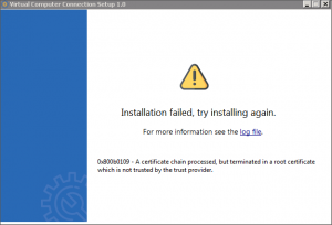

Error 0x800b0109 – Installation failed, try installing again
Cause:
The error occurs when there is an issue with the root certificate.
Solution:
  1. Update the Windows Root Certificate Program.
  2. Ensure that Microsoft .NET version is upgraded to 4.6.2, and the Microsoft Visual C++ 14.29 is installed.
  3. Install Virtual Computer Connection client.

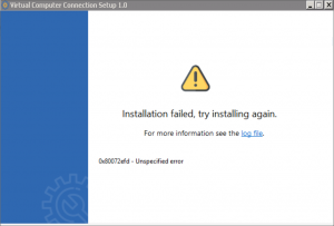

Error 0x80072efd – Installation failed, try installing again
Cause:
This error occurs, if:
  1. The installation of Microsoft.NET version 4.6.2 and Microsoft Visual C++ 14.29 fails.
  2. The Windows update are not up to date.
Solution:
  1. Ensure that the Windows Update service is running.
    • Go to Run > type Services.msc > check the status of the Windows Update.
  2. In case the Windows Update is missing from Services, then click the link below:
    https://social.msdn.microsoft.com/Forums/en-US/7e53eb53-a613-4fad-b62c-8706051b11d8/error-0x80070424-troubleshooter-says-quotsome-security-settings-are-missing-or-have-been?forum=vssetup
  3. Install Virtual Computer Connection client Full installer (Offline installer).

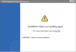

Error 0x80070643 – Installation failed, try installing again
Cause:
This error occurs when there is a problem with Windows updates.
Solution:
  1. If you are using Windows 7, update to the latest Service Pack 1 (SP1) and then proceed with installing the Virtual Computer Connection client.
  2. In the case that SP1 is already installed in Windows 7 and the issue persists, update Windows and install the Virtual Computer Connection client Full installer (Offline installer).
