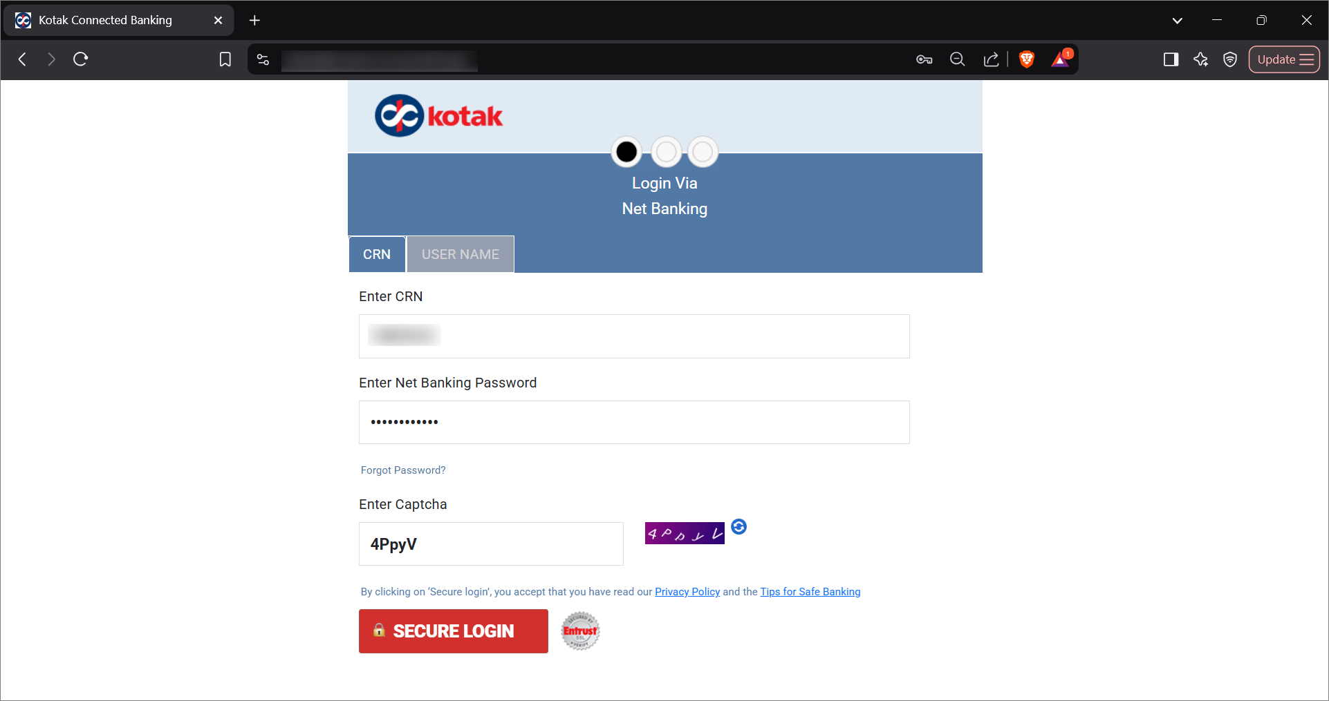

After you initiate connection from TallyPrime, you will need to use your CRN in order to login on the Kotak Mahindra Bank portal.
Do not use the personal ID names provided by the bank separately.

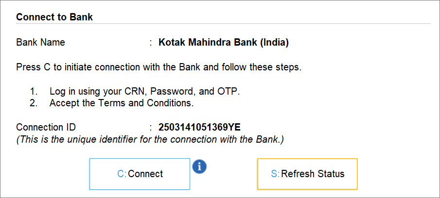

- Select Kotak Mahindra Bank.
A connection ID gets generated. - Press C (Connect) in the Connect to Bank screen.

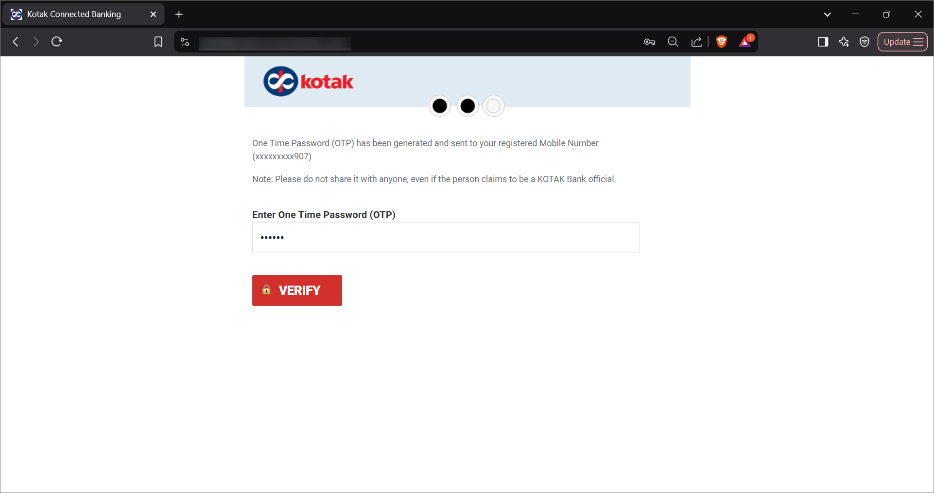

Consequently, you get redirected to the bank portal. - Log in to the Kotak Mahindra Bank portal.
- Enter the OTP received on the mobile number, which is registered with the bank.

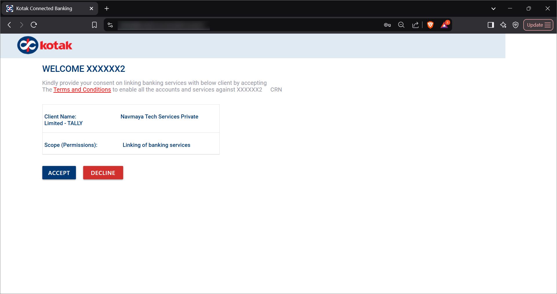

- Click ACCEPT to establish the connection.
The connection gets established.
- Switch to TallyPrime and in the in the Connect to Bank screen, press S (Refresh Status).
The status of the connection with the bank is Connected. The screen also displays the validity and the linked account numbers.

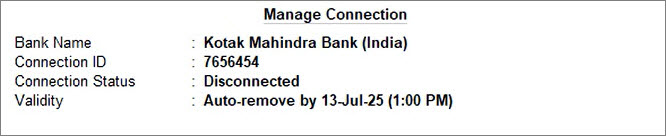

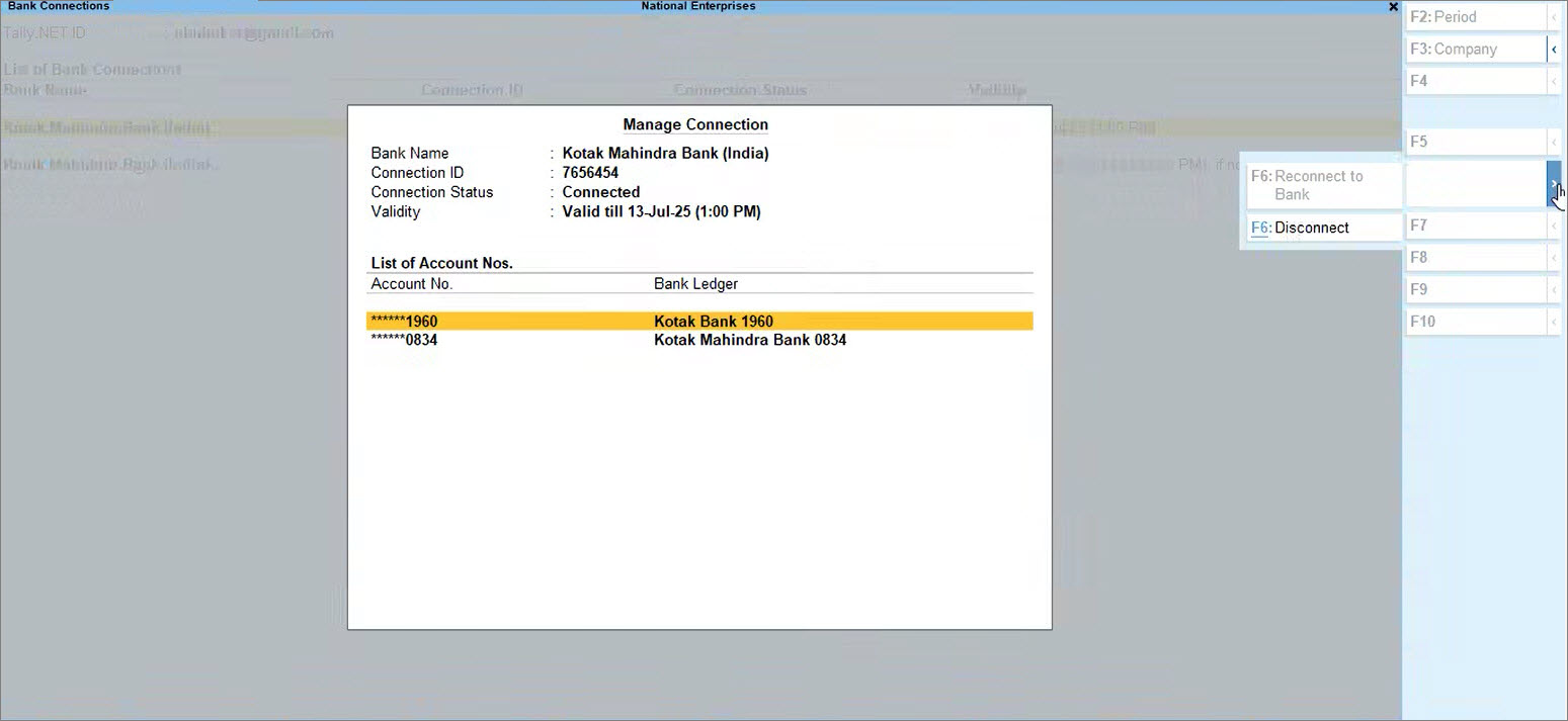

- Select the connection, and press Enter or press F7 (Manage Connection).
- In the Manage Connection screen, press F6 (Reconnect to Bank).

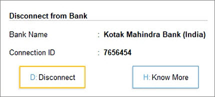

Disconnect Your Kotak Mahindra Bank Accounts
One or more bank accounts belonging to a bank might be dormant. You might want not want to use the bank accounts through Connected Banking. When you do not want to use bank accounts of a specific bank, you can disconnect from the bank.
- In the Manage Connection screen, press Alt+F6 (Disconnect).
- In the Disconnect from Bank screen, press D (Disconnect).

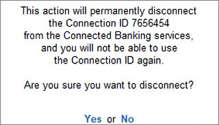

- Press Y to confirm.
The Kotak Mahindra Bank accounts get disconnected.
