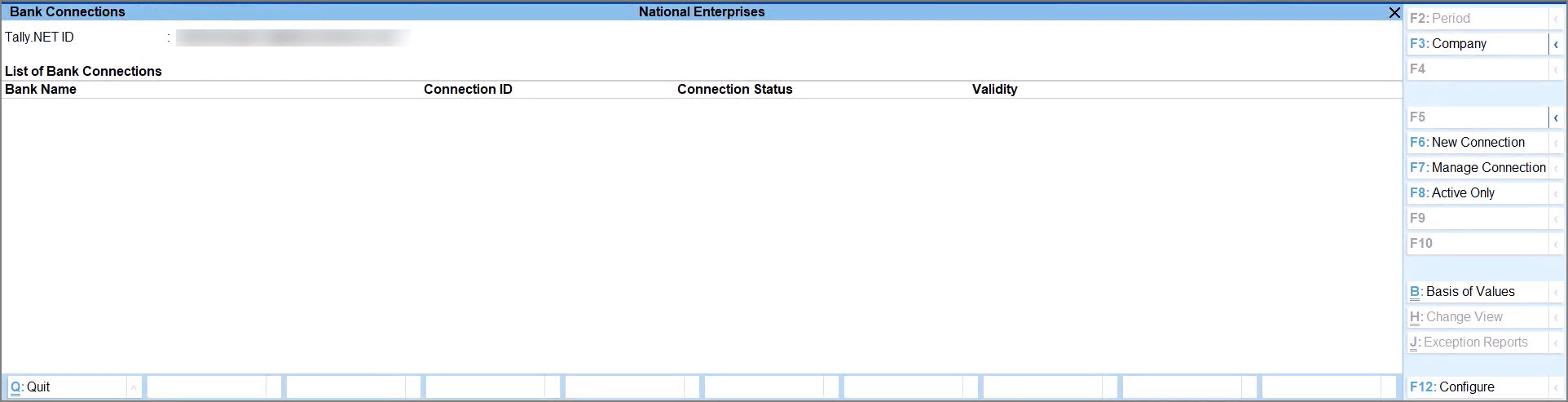

Connect Bank Accounts
When you connect to a specific Bank, a Connection ID gets generated. This is the reference ID for the connection initiated with the Bank.
Once the connection is successful, you get a list of account numbers with the matching Bank ledgers.
  1. Press Alt+Z (Exchange) > All Banking Options > Bank Connections.
    If you have not logged in to Connected Banking already, then you will need to log in.

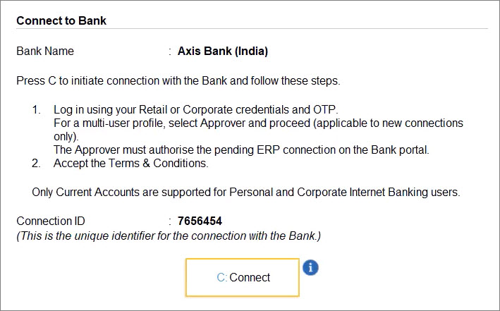

  2. Press F6 (New Connection).
  3. Select the relevant bank.
    A connection ID gets generated.
    If there are connections pending for approval for the bank, then you will get a message.
    In that case, you can press Y to proceed.

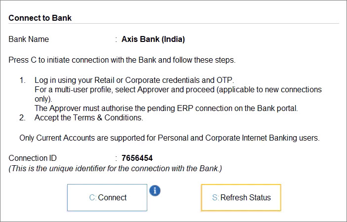

  4. In the Connect to Bank screen, press C (Connect).
    Initiating Connection with Bank in TallyPrime
  5. Consequently, you get redirected to the respective bank portal.
    Once you establish the connection with the bank on the portal, you can refresh the status.
  6. Press R (Refresh Status).
    Refresh Bank Connection with TallyPrime

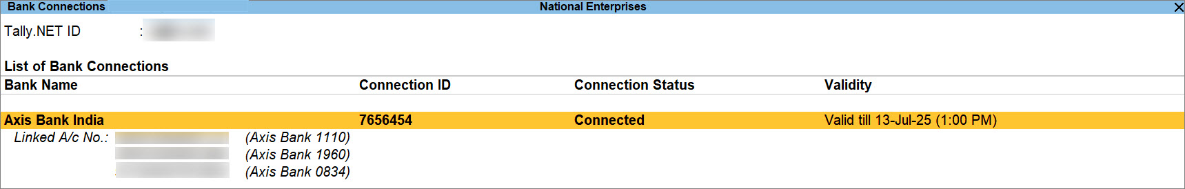

The status of the connection gets displayed in the Bank Connections report as Connected.
Once you establish the connection with the bank, the bank accounts get linked. If there are ledgers matching the bank accounts, then the ledgers also get displayed.
  • To view the linked bank accounts, press Shift+Enter on the relevant Bank row.
    Bank Connections with Linked Account Numbers to be Used for Connected Banking

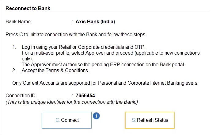

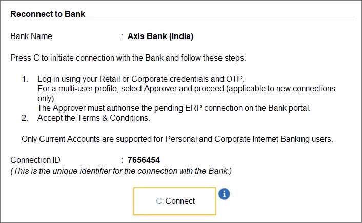

Reconnect Bank Accounts
You can reconnect to the bank using an existing Connection ID in the following scenarios:
  • The connection is still in progress.
  • The connection has expired when:
    • The connection has crossed its validity.
    • The mobile number has been changed.

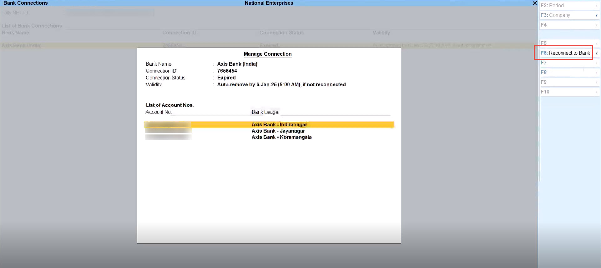

  1. Select the bank connection, and press Enter or F7 (Manage Connection).
  2. Press F6 (Reconnect to Bank).
    Reconnect to Bank Button in TallyPrime
  3. In the Reconnect to Bank screen, press C (Connect).
    Reconnect to Bank in TallyPrime
    Consequently, you get redirected to the bank portal.
    Refer to Reconnect with Axis Bank or Reconnect with Kotak Mahindra Bank to know more.
  4. Press R (Refresh Status).
    Refresh to Reconnect Bank to TallyPrime
    The Bank Accounts get connected.
    Bank Accounts Get Conected

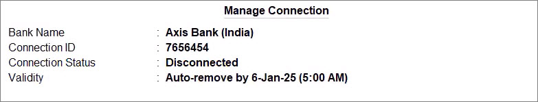

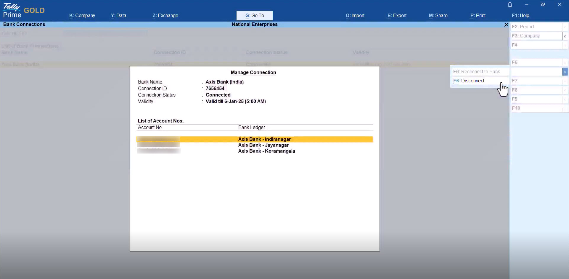

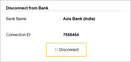

Disconnect Bank Accounts
Some of your bank accounts might be dormant. So, you might not want to use the bank accounts through Connected Banking. When you do not want to use bank accounts of a specific bank, you can disconnect from the bank.
  1. In the Manage Connection screen, press Alt+F6 (Disconnect).
    Disconnect from Bank Button in TallyPrime
  2. In the Disconnect from Bank screen, press D (Disconnect).

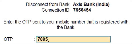

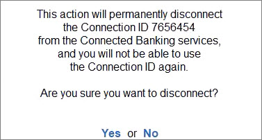

  3. Press Y to disconnect from the bank.
    Message for Disconnect from Bank
    In the case of Axis Bank, you will need to enter the OTP received on the mobile number registered with the Bank.
    However, in the case of Kotak Mahindra Bank, the OTP is not required.
The Bank Accounts get disconnected.
Bank Accounts Get Disconnected

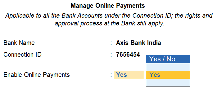

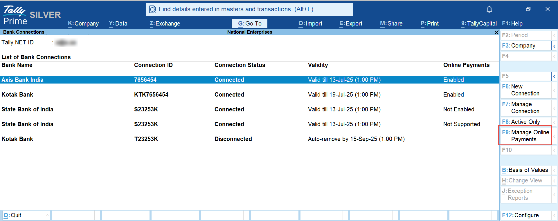

Enable Online Payments for Bank Connection
To start sending payments online using Connected Banking, you need to enable online payments for a specific Bank Connection.
Before you enable online payments, it is important to note the following:
  • Online payments can be enabled only by the user who initiated the Bank Connection.
  • Once you enable online payments:
    • Online payments get enabled for all the bank accounts under the Bank Connection.
    • All the users using the Bank Connection can send payments online using Connected Banking.
  • While you enable online payments in TallyPrime, the restriction, approval process, and regulations by the bank remain unchanged on the bank portal.
  1. Press Alt+Z (Exchange) > All Banking Options > Bank Connections, and select the Bank Connection.
  2. Press F9 (Manage Online Payments).

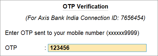

  3. Enable Online Payments: Yes.
  4. Enter the OTP sent to your mobile number that is linked to your  Tally.NET ID.
    The online payments get enabled.

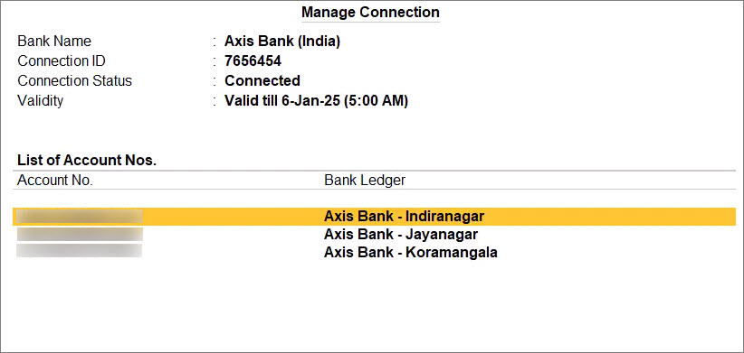

  1. In the Bank Connections report, select the bank connection and press Enter or F7 (Manage Connection).
  2. Select the bank account using Spacebar and press Alt+L (Manage Limits).
  3. Enter the Daily Limit, which applies to all the transactions sent in a day.
  4. Enter the Transaction Limit, which applies to a single transaction.
    The limits entered by you should be under the maximum limit displayed on the screen.
  5. Enter the OTP.
    The Transaction Limits will get applicable.

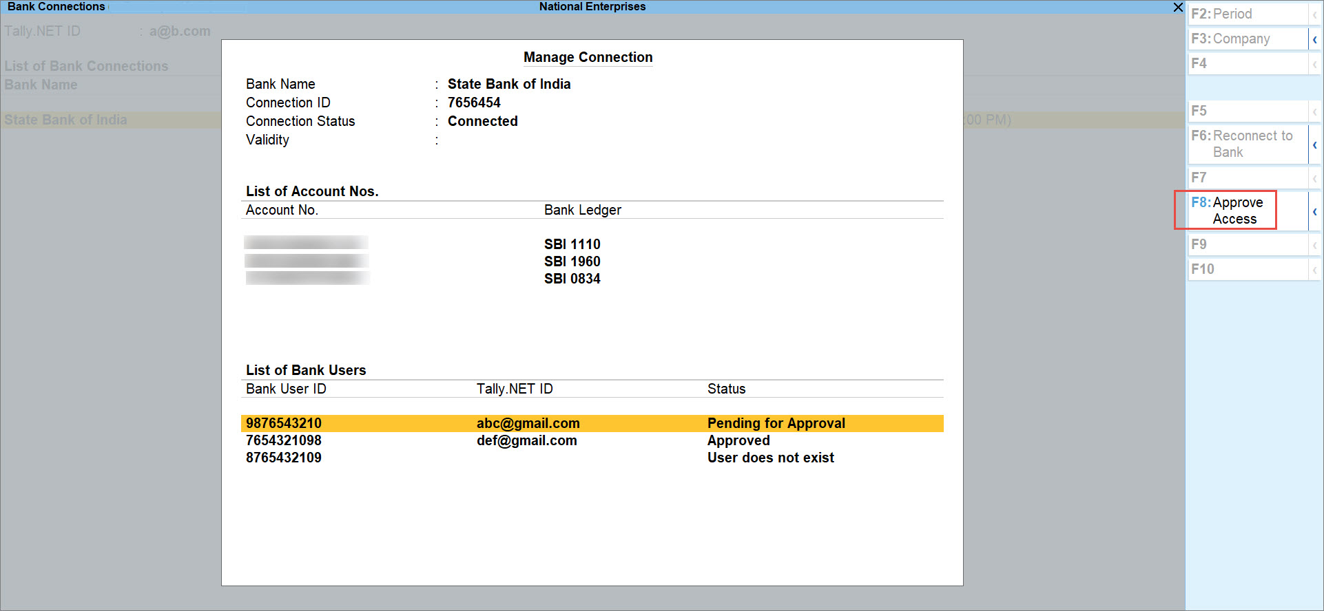

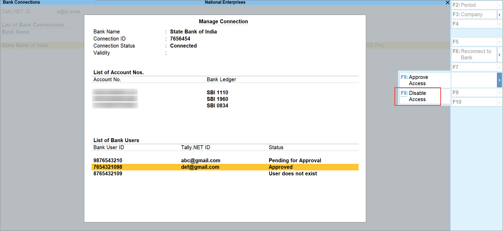

Manage User Access to Bank Accounts
If there are multiple users in a bank and your bank follows the system of approval, then you will see the list of users in the Manage Connection screen. You will need to approve user access to bank accounts.
However, in the list of users, a user might have the status as User does not exist when:
  • The user has not linked the mobile number.
  • The user does not have a Tally.NET ID.
Approve User
You can approve access for the users for whom approval is pending.
  1. In the Bank Connections report, press F7 (Manage Connection).
  2. Select the user, and press F8 (Approve Access).
    User Pending for Approval
  3. Press Y to confirm.
    The user will be able to access the Connected Banking services.
Disable User Access
If you want to disable bank access for a few users, then you can easily do so.
  2. Select the user and press Alt+F8 (Disable Access).
    Disable User Access to Connected Banking
    The user will no longer be able to access the Connected Banking services.
