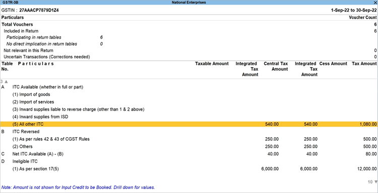

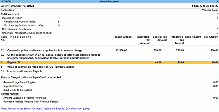

  1. Press Alt+G (Go To) > GSTR-3B, and drill down from section 4 Eligible ITC.
  2. Press Enter on section 4D (Ineligible ITC).
  3. Note down the GST details in sub-section (1) As per section 17(5).
  4. Open form GSTR-3B on the portal or the offline tool, and add the relevant details in section 4B.1 (ITC Reversed).
The relevant details from your books will now be available on the portal or the offline tool for filing GSTR-3B.

  1. Press Alt+G (Go To) > GSTR-3B, and drill down from section 4 Eligible ITC. Section 4A will appear along with sub-sections 1 to 5.
  2. Drill down from sub-section 4 A(5) (All Other ITC), and drill down again to open the relevant journal voucher that was used to reclaim ITC reversal.
  3. Note down the Amount recorded in the journal voucher.
  4. Open form GSTR-3B on the portal or the offline tool, and add the relevant details in section 4D.1 (ITC Reclaimed).

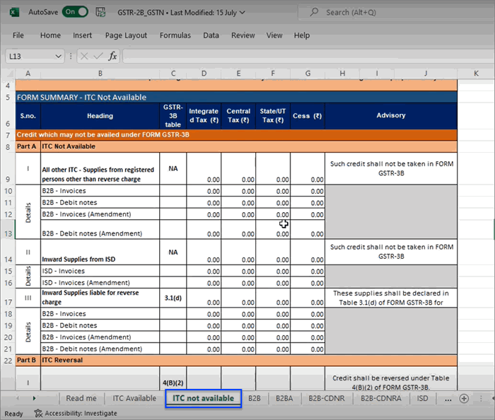

A new section 4D.2 has been introduced in form GSTR-3B on the portal and the offline tool, where you have to report the value of transactions where there was a mismatch in place of supply. Additionally, you also have to report the transactions that were reported by your suppliers after the filing of Annual Return or the September return of the next financial year, whichever is earlier. To comply with this change, you have to download return GSTR-2B from the portal, check the relevant details in the ITC Not Available sheet, and add them to section 4D.2 in form GSTR-3B on the portal or the offline tool.
  1. Download return GSTR-2B from the portal.
  2. Open the downloaded file and go to the ITC Not Available sheet.
  3. Note down the relevant GST details.
  4. Open form GSTR-3B on the portal or the offline tool, and add the relevant details in section 4D.2.
The details from return GSTR-2B will now be available on the portal or the offline tool for filing GSTR-3B.
