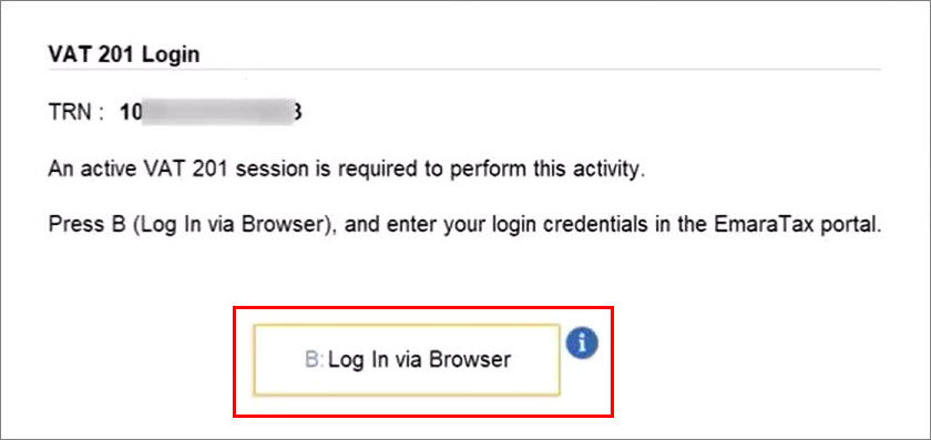

    The VAT 201 Login screen appears.
  2. Press B (Log In via Browser).

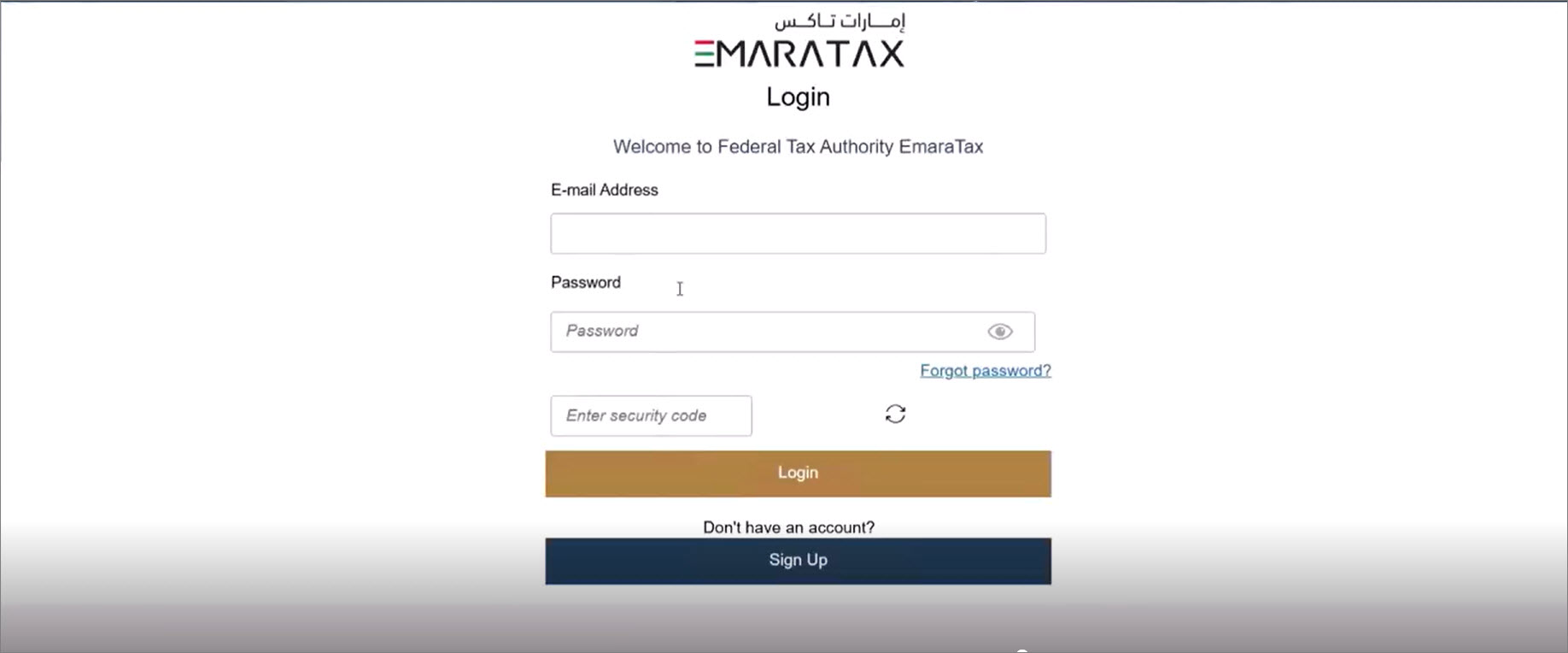

    You will be redirected to the official EmaraTax portal via your default web browser.
  3. Enter the E-mail Address and Password registered with the FTA.
    emara-tax-login
  4. Click Login.
    • On successful login, a confirmation message appears on the browser.

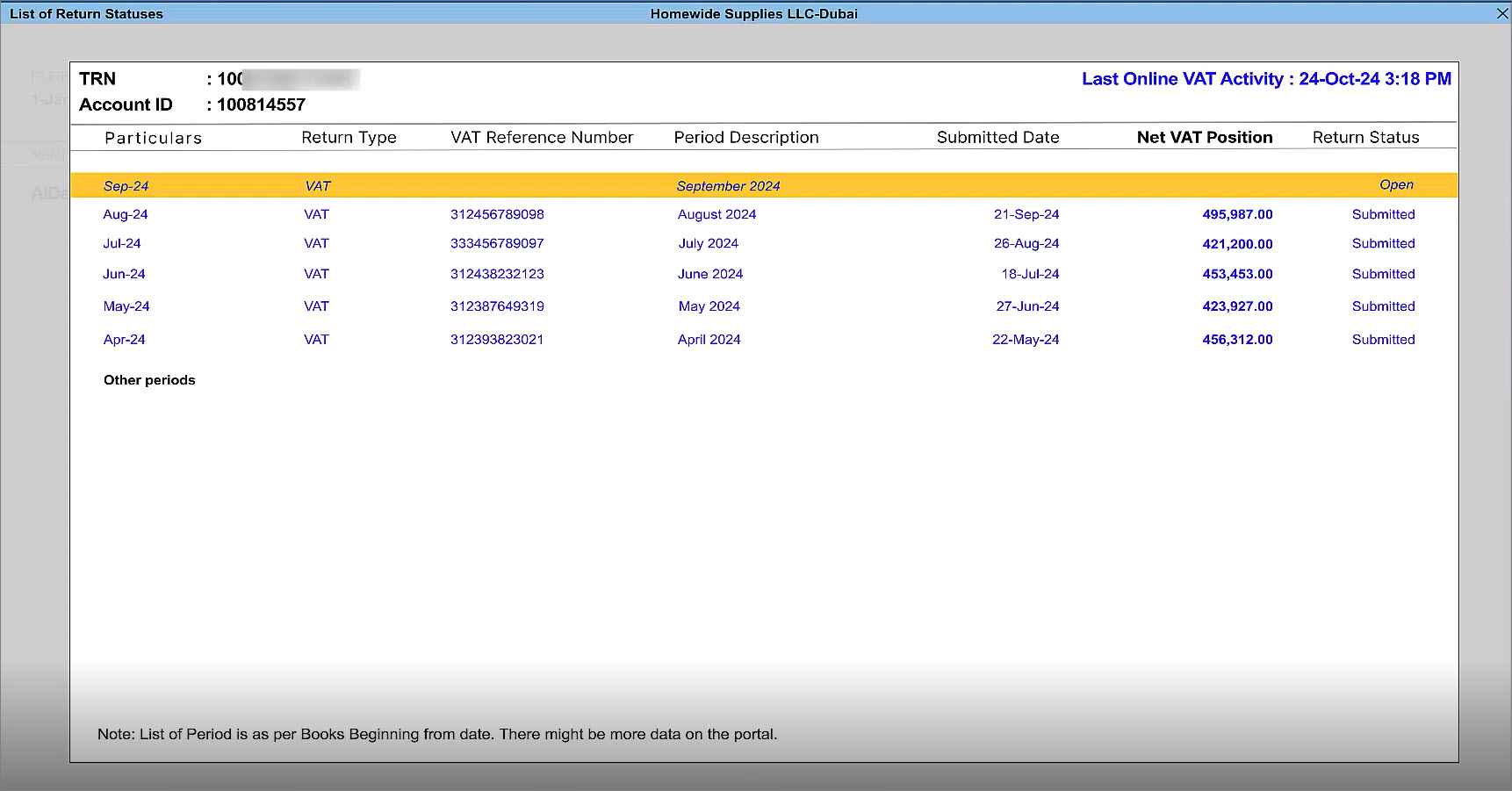

Once you have successfully logged in and started the VAT session, the List of Return Statuses screen appears, displaying the return periods available on the EmaraTax portal.
list-of-return-statuses
You can review the return details for each period:
  • Return Type
  • VAT Reference Number
  • Period Description
  • Submitted Date
  • Net VAT Position
  • Status
The values fetched from the EmaraTax portal will appear in blue.

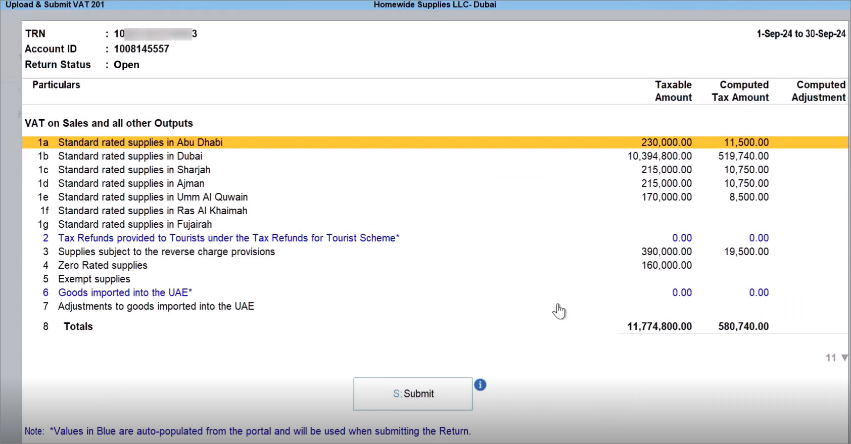

  1. Select the period for which you want to upload the return.
    If there are overdue periods, you must first file the oldest overdue return.
    The Upload & Submit VAT 201 screen appears, displaying the return preview.
    upload-submit-vat-201
    The following columns appear by default:
    1. Taxable Amount
    2. Computed Tax Amount
    3. Computed Adjustment
    These columns appear when filing the return for the first time from TallyPrime.

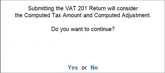

  2. Press S (Submit) to submit the return.

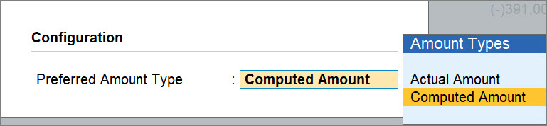

    A confirmation message appears based on the selected amount type.
    submit-confirmation
  3. Select Yes to proceed.
Once the return is uploaded successfully, you will get a confirmation message with the VAT Reference Number.

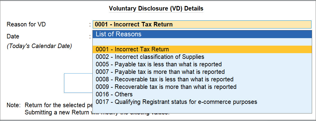

Submit Voluntary Disclosure, if applicable
If the return for the selected period has already been submitted, the action is treated as a Voluntary Disclosure (VD).
The VD Details screen appears.
  1. Enter the following:
    • Reason for VD from the List of Reasons.
      list-of-vd
    • Date of Disclosure.
  2. Press C (Continue) to proceed.
    Once the upload is successful, you will get a confirmation message.

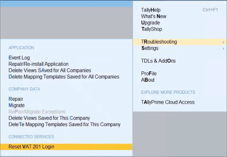

  1. Press F1 (Help) > Troubleshooting > Connected Services > Reset VAT 201 Login.
    reset-vat-login
    A confirmation message appears indicating that the login details for the current TRN and User will be cleared.
  2. Select Yes to confirm.
    Once reset, you will need to log in again using the Log In via Browser option.
