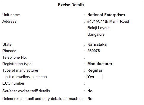

  3. In the Excise Registration Details screen, excise details like Unit Name, Address, State, Pincode and, Telephone No. will be displayed as entered in the Company Creation screen. These details can be altered, if required.
  4. Select Manufacturer as the Type of Registration.
  5. Select the Type of Manufacturer, as required.
  6. Enter ECC number.
    ECC number
    is PAN based, and has 15 digits. The format of ECC no. is ABCDE1234HXM001.

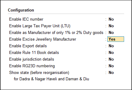

    Note: For jewellery business, press F12 (Configure). Set the option Enable Excise Jewellery Manufacturer to Yes, to display the option Is it a jewellery business in the Excise Registration Details screen.
    Press Ctrl+A to accept. In the Excise Registration Details screen, set the option Is it a jewellery business to Yes.
  7. Enable the option Set/alter excise tariff details to Yes, to record tariff details.

Configuration Options
In the Excise Registration Details screen, press F12 (Configure), and set the options as needed.
  • Enable IEC Code: Enable this option to enter the 10-digit Import Export Code (IEC) in the Excise Registration Details screen.
  • Enable Large Taxpayer Unit (LTU): Enable this option if the excise unit has to be marked as a Large Tax Payer Unit in Excise Registration Details screen.
  • Enable as Manufacturer of only 1% or 2% Duty goods: Enable this option if the manufacturer is registered as Regular or SSI unit falls under the purview of sixth provison to rule 12(1) and has to file Form ER-8.
  • Enable Export details: Enable this option to define the applicability of ARE Forms and ARE Form serial numbers.
  • Enable Rule 11 Book details: Enable this option to create excise book.
  • Enable jurisdiction details: Enable this option to provide details of the jurisdiction in which the excise unit is registered.
