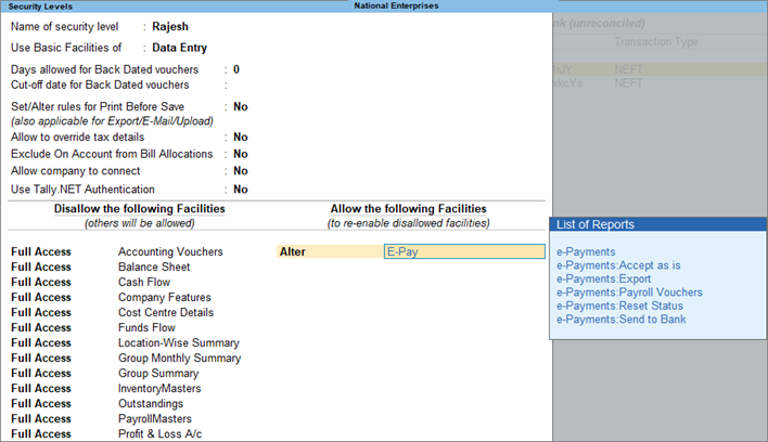

Security for e-Payments
You can use the Security Control feature to set up the required security levels. For example, you can allow full access or access to:
  • e-Payments report for a data entry operator.
  • All types of payments, including payroll, for an accountant.
  1. Press Alt+K (Company) > User Roles.
  2. Select the security level (for example, Data Entry) from the List of Security Levels, and press Enter.
    • Under Allow the following Facilities, select e-Payments from the List of Reports.
      epayment-security-levels
  3. Accept the security settings. As always, you can press Ctrl+A to save the screen.
Refer to the Manage Users article for more information on Security Control.
