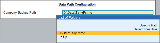

TallyPrime Server provides you with the flexibility to set the default paths for backup, and change it whenever required. The path will be set as default for all the companies backup file.
Press Alt+Y (Data) > Data Path. Select the Company Backup Path.

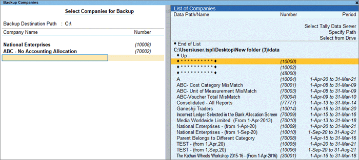

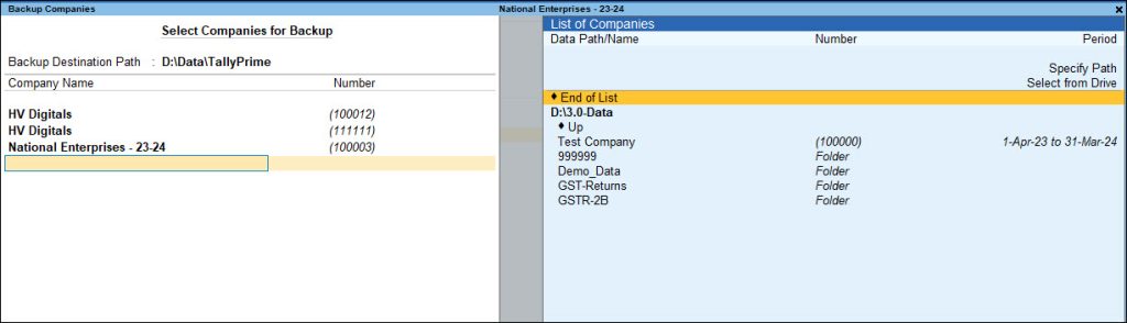

  1. Press Alt+Y (Data) > Backup, to open the Backup Companies screen.
    Backup Destination Path – This is the location where your companies backup will be saved.
  2. Select the required company, or select All Items to back up all the companies.
  3. Press Enter to proceed.
The backup file will be stored in the Backup Path as TBK900_10000.001. If there is any conflict of data in the selected folder, you will have the option to either overwrite the older version or choose a different location or filename.

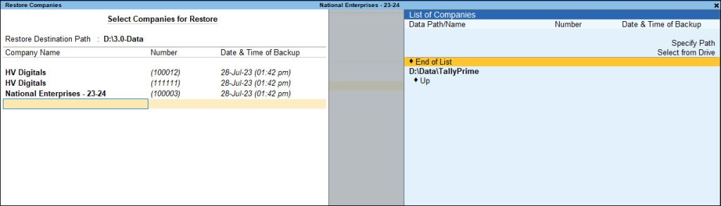

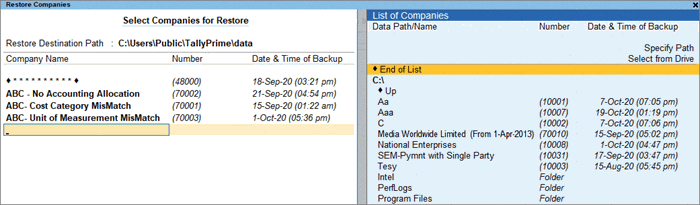

  1. Press Alt+Y (Data) > Restore, to open the Restore Companies screen.
    Restore Destination Path – This is the location where your company data will be restored.
  2. Select the required company, or select All Items to restore all the companies.
