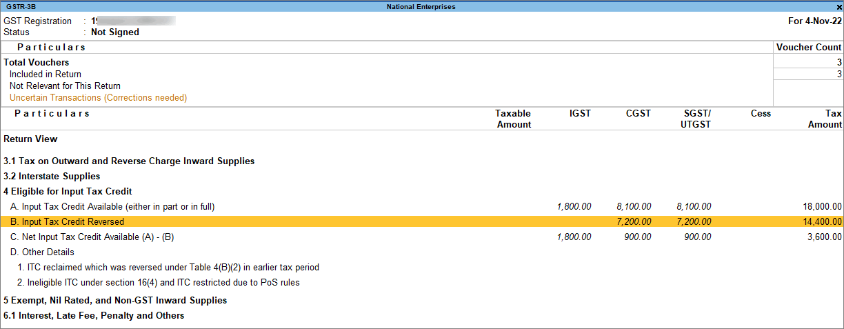

Let us consider a Purchase voucher with Supplier Invoice No. LPG-01 and Date: 1-Nov-22. Taxable value is Rs. 8,00,000/- with GST of Rs. 1,44,000/- recorded on 2-Nov-22. Now, if you had to return a few of the stock items due to reasons like a defect in the product or change in place of supply, you can record a Debit Note. Local Purchase TallyPrime
Shown below is a Debit Note voucher recorded on 4-Nov-22.
Debit Note
You can see the impact of the Debit Note on your Input Tax Credit Reversed, in GSTR-3B for Nov-22.
Press Alt+G (Go To) > GSTR-3B > press Enter.
Alternatively, Gateway of Tally > Display More Reports > GST Reports > GSTR-3B > press Enter.
Debit Note GSTR3B TallyPrime

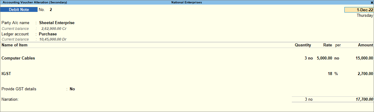

Purchase returns can also happen after a few weeks or months of purchase, especially after you have filed your returns for the month of purchase. In such cases, you will need to record a Debit Note against the purchase voucher in the subsequent GST return period of that voucher. You can then view the Input Tax Credit Reversed in GSTR-3B of the subsequent GST Return Period.
To learn how to record a debit note, refer to Record a Debit Note for Purchase Returns.
Let us consider a Purchase voucher with Supplier Invoice No. LPG-01 and Date: 1-Nov-22. Taxable value is Rs. 8,00,000/- with GST of Rs. 1,44,000/- recorded on 2-Nov-22. Now, if you had to return a few of the stock items due to any reason like a defect in the product or change in place of supply, you can record a Debit Note. If you record a debit note against this on 01-12-2022, then the Input Tax Credit Reversed for that voucher will be visible in the GSTR-3B report of Dec 2022.
Local Purchase TallyPrimeShown below is a Debit Note voucher recorded on 1-Dec-22.
You can see the impact of Debit Note under Input Tax Credit Reversed in GSTR-3B for Dec-22.
