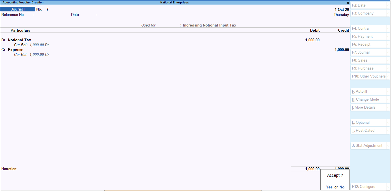

    The journal voucher appears as shown below:
  5. Accept the screen. As always, you can press Ctrl+A to save.
