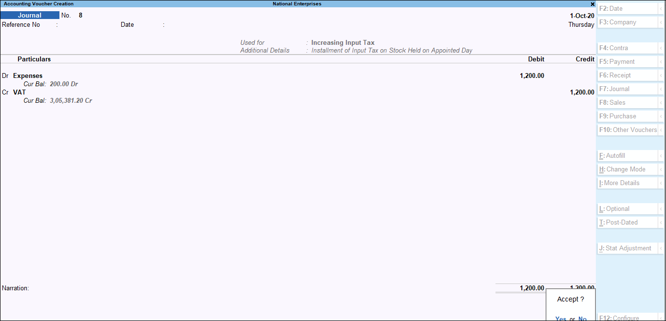

Increase in Input Tax (VAT)
You can record a transaction for increase in input tax in journal voucher.
  1. Gateway of Tally > Vouchers > press F7 (Journal).
    Alternatively, press Alt+G (Go To) > Create Voucher > press F7 (Journal).
    Note: You can create a journal voucher from Gateway of Tally > Display More Display > VAT Reports > select the VAT or CST form.
  2. Press Alt+J (Stat Adjustment). In the Stat Adjustment Details screen,
    • Select Type of duty/tax as VAT.
    • Select Increasing Input Tax, as the Nature of adjustment.
      Note: Based on the selection made for Nature of Adjustments, the Additional Details option either appears or disappears.
    • Press Ctrl+A to return to the voucher.
  3. Debit the expense ledger and enter the amount.
  4. Credit the input VAT ledger. Enter the tax Rate and Assessable Value in VAT Details screen. The journal voucher appears as shown below:
  5. Accept the screen. As always, you can press Ctrl+A to save.
