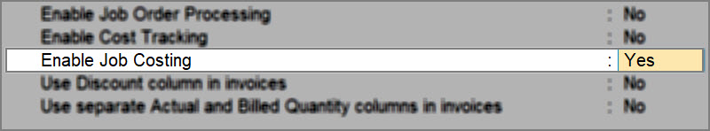

  1. Enable Job Costing.
    1. Press F11 > set Enable Job Costing to Yes.
      In case you do not see this option, set Show more features to Yes.
      Enable-Job-Costing
    2. Accept the screen. As always, you can press Ctrl+A to save.

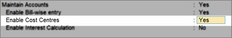

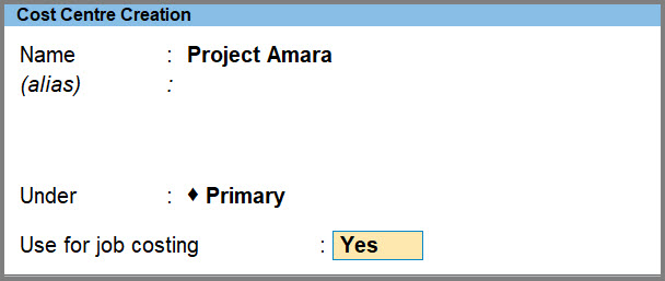

  2. Enable and create Cost Centres.
    1. Press F11 > set Enable Cost Centres to Yes.
      Enable-Cost-Centres
    2. Create Cost Centres.
      • Press F12 (Configure) > enable the option Set Job Costing for Cost Centres.
    3. Set the option Use for job costing to Yes.
      The Cost Centre Creation screen appears, as shown below:
      Cost-Centre-Creation
    4. Accept the screen. As always, you can press Ctrl+A to save.
      To know more about creating Cost Centres, refer to the Cost Centre Allocation topic.

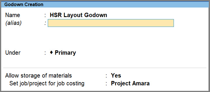

  3. Create Godowns.
    When you create a Godown/Location in TallyPrime for the first time, you are prompted to alter the existing internal godown (Main Location), where all your inventory is stored by default.
    1. Press C (Create New) and start creating the Godowns.
    2. Fill in the details in the Godown Creation screen.
      • Select a cost centre under Set job/project for job costing.
        If you do not see this option, press F12 (Configure) > Allow storage of materials as Yes > Set Job Costing details as Yes.
        The Godown Creation screen appears, as shown below:
        Create-Godowns
    3. Accept the screen. As always, you can press Ctrl+A to save.
      To know more about creating godowns, refer to the Create Godown topic.

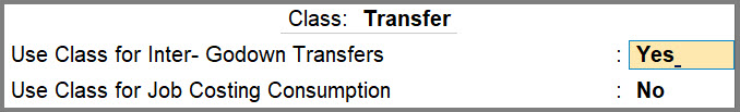

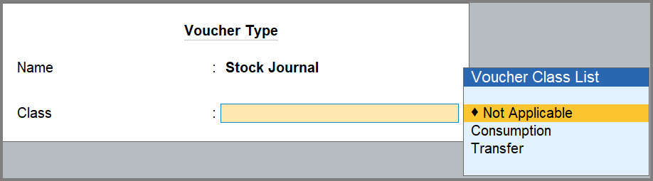

  4. Define Stock Journal Voucher Class for Transfer or Consumption.
    1. If you want to transfer the materials from one godown to the other, follow the steps below,
      1. Press Alt+G (Go To) > Alter Master > Voucher Types > type or select Stock Journal and press Enter.
      2. Enter the Name of Class, for example, Transfer, and press Enter to view the Voucher Type Class screen.
      3. Set the option Use Class for Inter-Godown Transfers to Yes and press Enter.
        Enable this option if the Material Movement involves only transfer of materials.
        Transfer

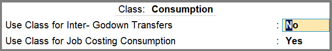

    2. If the materials are getting consumed in the godowns, follow the steps below,
      2. Enter the Name of Class, for example, Consumption, and press Enter to view the Voucher Type Class screen.
      3. Set the option Use Class for Job Costing Consumption to Yes and press Enter.
        Enable this option if the Material Movement involves only consumption of materials.
        Consumption
To know more about working with voucher classes, refer to the Voucher Class section in the Voucher Types topic.

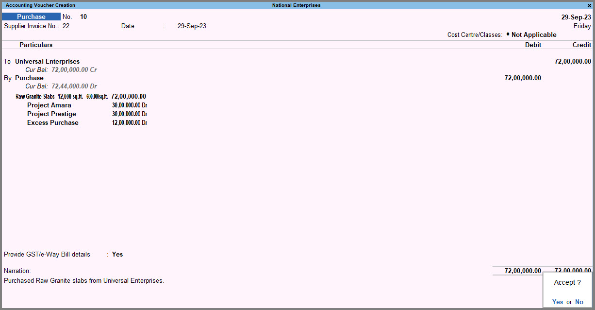

You can record the purchase transaction in the following manner:
  1. Open Purchase voucher in As Voucher mode.
    1. Press Alt+G (Go To) > Create Voucher > press F9 (Purchase).
      Alternatively, Gateway of Tally > Vouchers > press F9 (Purchase).
    2. Press Ctrl+H (Change Mode) and select As Voucher.

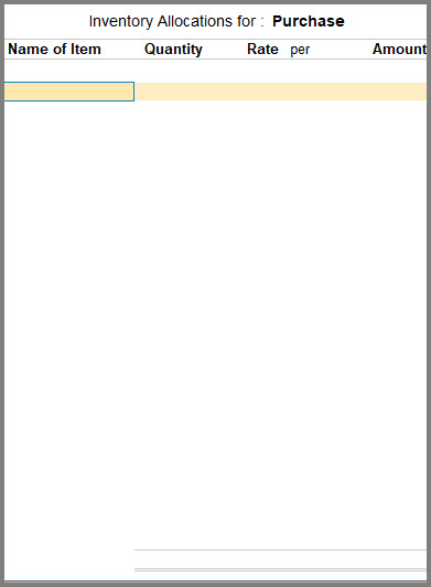

  2. Record the purchase transaction and allocate to different projects.
    1. Credit the Party Ledger.
    2. Select the Purchase ledger.
      The Inventory Allocations screen appears, as shown below:
      Inventory-Allocation
    3. Enter the Name of Item that you wish to purchase.

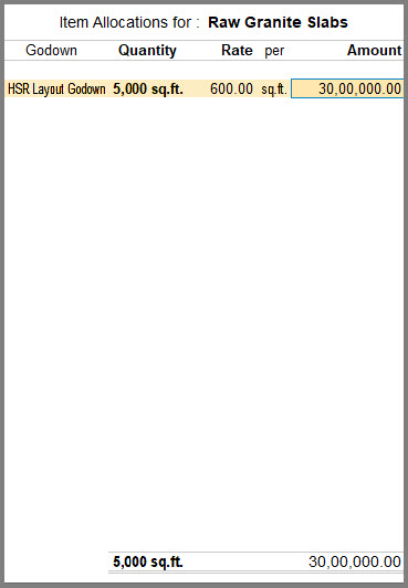

      The Item Allocations screen appears.
    4. Select the Godown, Quantity and Rate of the stock item.
      The Item Allocations screen appears, as shown below:
      Item-Allocation
      The Inventory Allocations screen appears.
    5. Select the stock item.

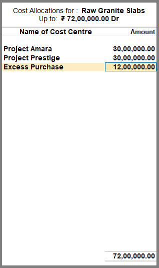

      The Cost Centre Allocations screen for the purchase of the stock item appears.
    6. Select the project name under Name of Cost Centre.
      If you are purchasing for multiple projects at one go, select the stock item multiple times and allocate it to the specific projects.
      The Cost Centre Allocations screen appears, as shown below:
      Cost-Centre-Allocation
      Note: If you are purchasing for a single project, continue in Item Invoice mode and specify the Project Name under Cost Centre/Classes.
      The Accounting Voucher Creation screen appears, as shown below:
      Enable-Cost-Centres
To know more about how to record purchase entries, refer to the Record Purchase Order topic.

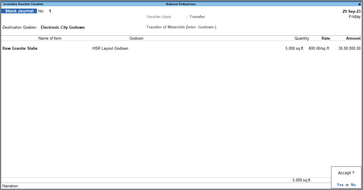

Record Inter-Godown Transfer of Materials
For Project Amara, when you are shipping the huge uncut raw granite slabs from HSR Godown to Electronic City Godown, there is transfer of material taking place. Therefore, you select Transfer as the voucher class and Electronic City Godown as the destination location to record the Inter-Godown Transfer of the uncut granite slabs.
To record the transfer of material,
  1. Press Alt+G (Go To) > Create Voucher > Vouchers > press F10 (Other Vouchers) > type or select Stock Journal and press Enter.
    Alternatively, Gateway of Tally > Vouchers > press F10 (Other Vouchers) > type or select Stock Journal and press Enter.
  2. Select a Voucher Class, for example, Transfer.
    Voucher-Type-Transfer
  3. Record the Stock Journal Voucher for the transfer of material.
    1. Enter the Destination Godown, where the material will be shipped, in this case, Electronic City Godown.
    2. Enter the Name of Item being transferred.
    3. Select the Godown from where the material is being shipped, in this case, HSR Godown.
    4. Enter the Quantity, Rate and Amount of the item that is to be transferred.
      The Inventory Voucher Creation screen appears, as shown below:
      Transfer-Materials
You can easily record the inter-location transfer of materials after specifying the Voucher class as Transfer and track the material movement.

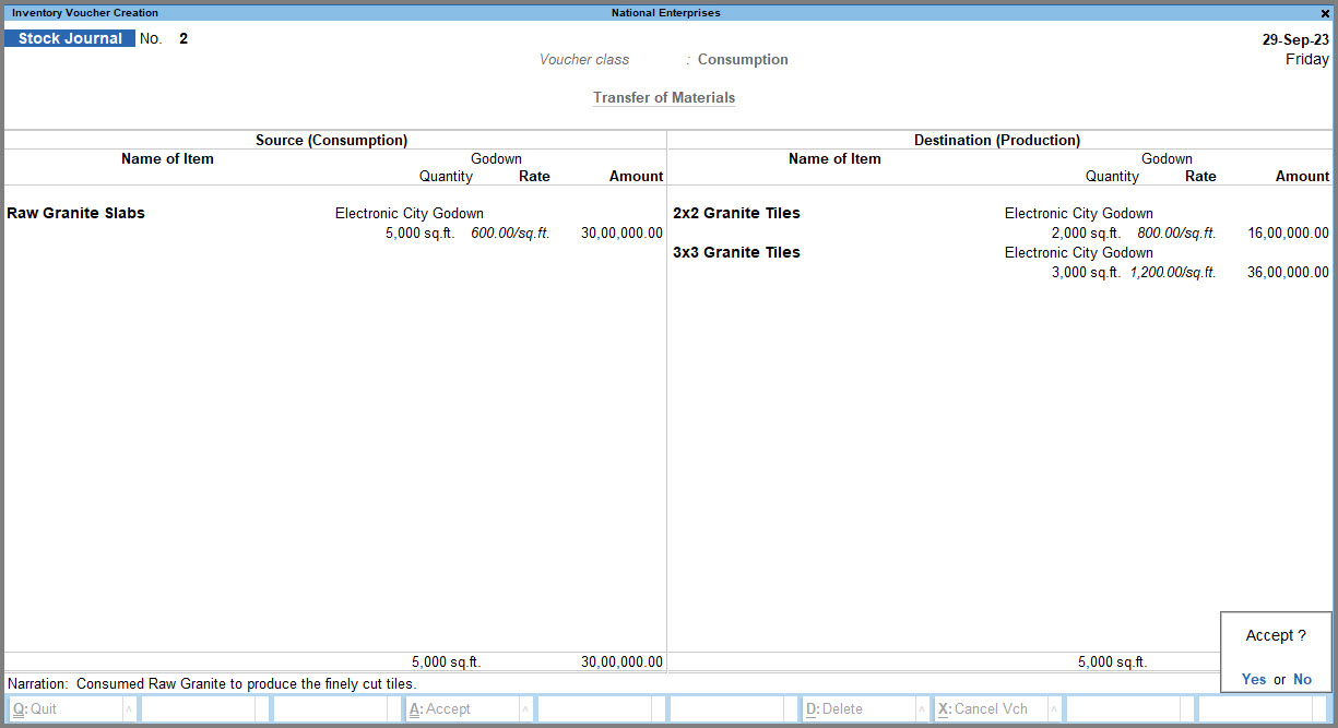

Record Consumption of Materials
After transferring the slabs to the Electronic City Godown, the huge granite slabs are consumed. Here the uncut granite slabs are consumed to produce finely cut and polished 2×2 and 3×3 tiles which will be finally sold off to the clients. On selecting Consumption as the voucher class, you will derive the entire overview of the consumption of raw materials and the production of finished goods in the Electronic City Godown including the specific quantities, rates and amount of the materials consumed and produced at both ends.
To record the consumption of materials,
  2. Select a Voucher Class, for example, Consumption.
  3. Record the Stock Journal for the consumption of material.
    1. Under Source (Consumption), enter the Name of Item, Godown (Electronic City Godown), Quantity, Rate, Amount of the goods that is consumed in the production process.
    2. Similarly, under Destination (Production), enter the Name of Item, Godown (Electronic City Godown), Quantity, Rate, Amount of the produced goods.
      Consumption-Material
You can easily record the consumption of materials after specifying the Voucher class as Consumption and track the material usage.

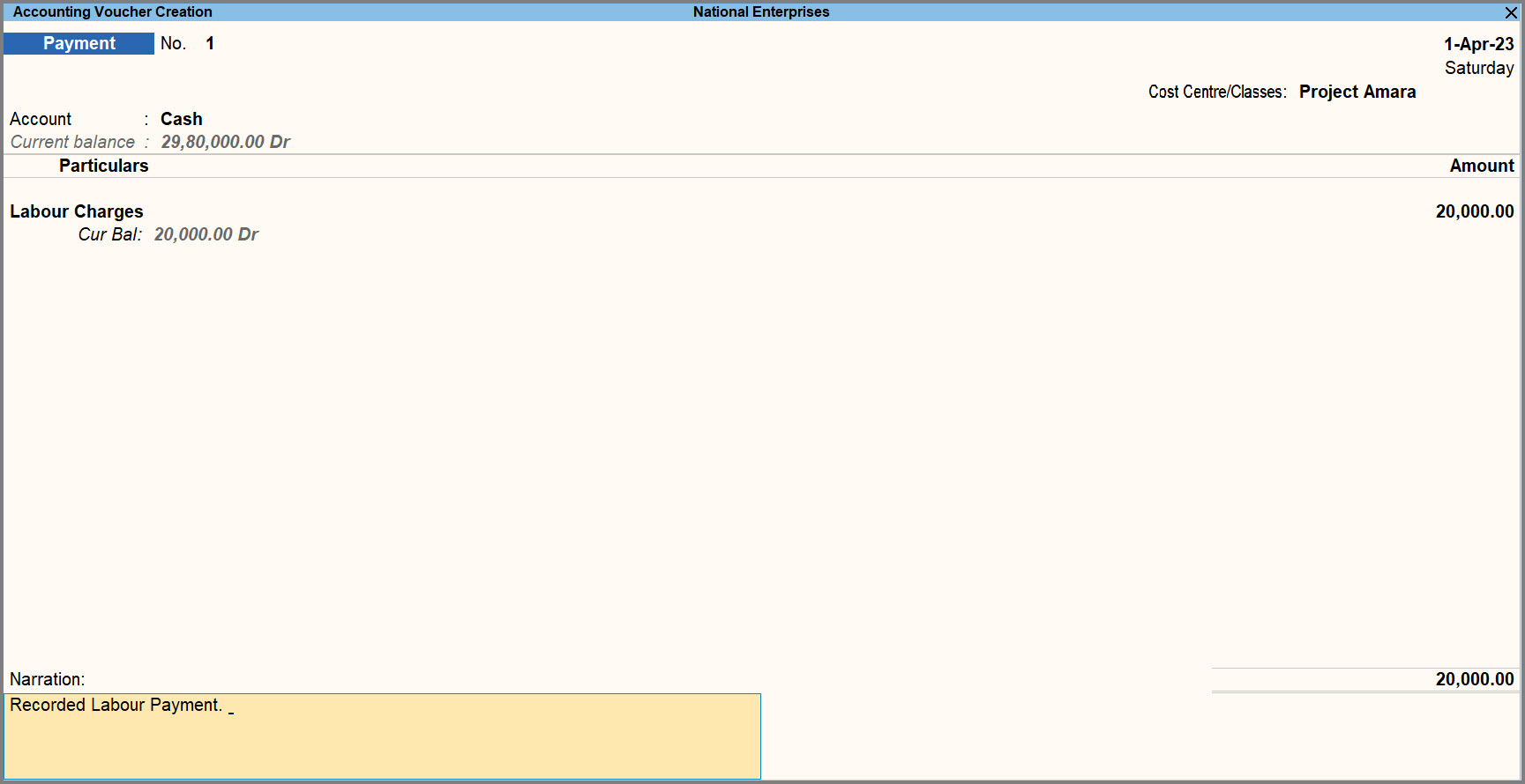

Record Payments for Expenses
Any expenses made immediately after purchasing the materials during a project, or a job can be allotted to it by recording Payment Vouchers. You pay the workers for cutting the edges of the marbles, polishing and loading/unloading materials. The labour payments you make count as direct expenses in your project, and you can record the payment voucher in the following manner:
  1. Press Alt+G (Go To) > Create Voucher > press F5 (Payment).
    Alternatively, Gateway of Tally > Vouchers > press F5 (Payment).
  2. Record the payment voucher.
    1. Select the Cost Centre/Classes and enter the respective amounts.
    2. Select the bank/cash ledger and the expense ledger.
    3. Enter the Amount.
      Payment-Voucher
  3. Accept the screen. As always, you can press Ctrl+A to save the voucher.
This is how you record the payment and allocate it to the undertaken project or job.

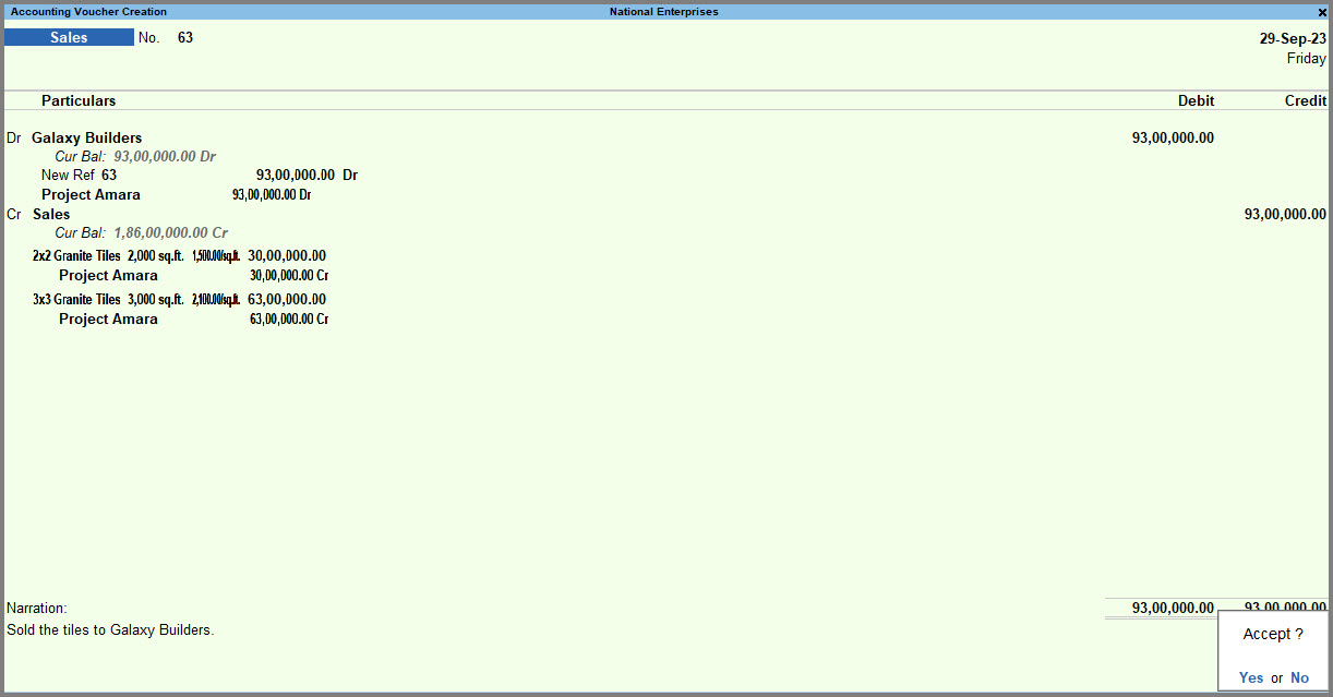

Record Sales for Revenue
You can record the sales transaction of the tiles and allocate the revenue to the project.
  1. Open Sales Voucher in As Voucher mode.
    1. Press Alt+G (Go To) > Create Voucher > press F8 (Sales).
      Alternatively, Gateway of Tally > Vouchers > press F8 (Sales).
  2. Record the sales transaction.
    1. Debit the Party ledger, for example Galaxy Builders.
      The Cost Allocation screen appears.
    2. Select the project name under Cost Centre.
    3. Credit the Sales ledger.

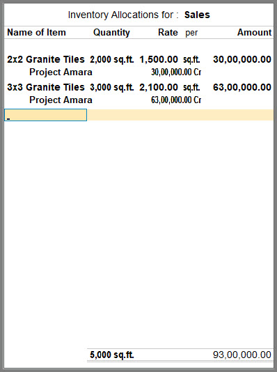

      The Inventory Allocation screen appears.
    4. Enter the Name of Item that you are selling.
      The Item Allocation screen appears.
    5. Enter the Godown name, Quantity and Rate at which you are selling the items.
    6. Select the project name under Cost Centre.
      The Inventory Allocation screen appears, as shown below:
      Sales-Voucher
    To know more about recording sales transactions, refer to Sales with Cost Centre Allocation topic.

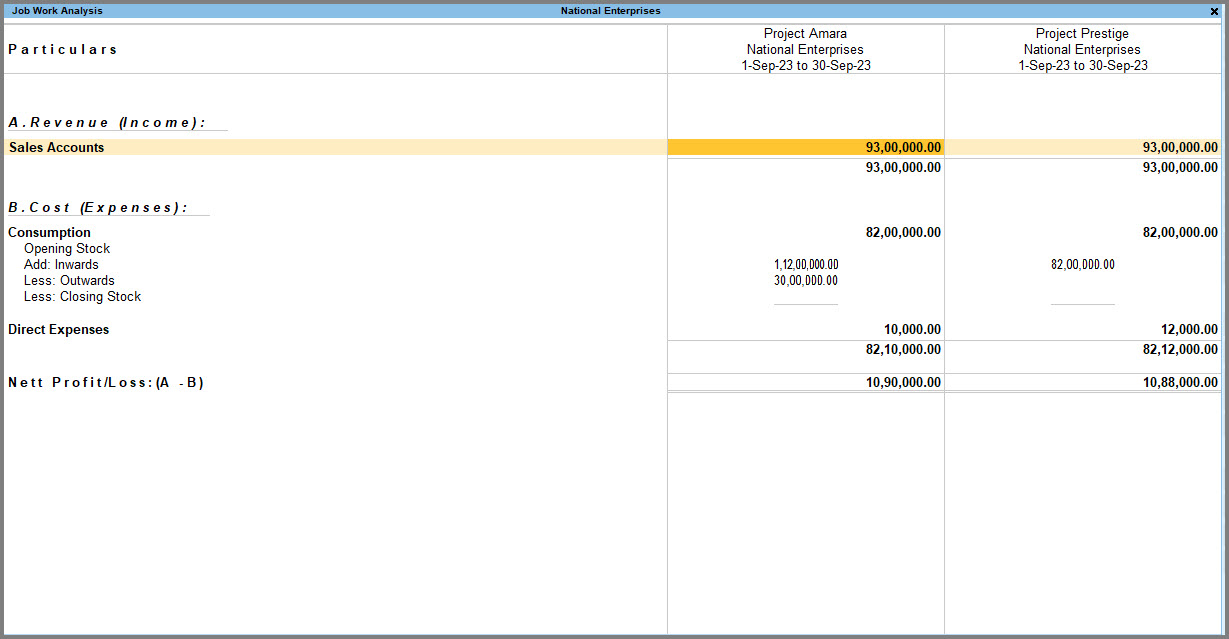

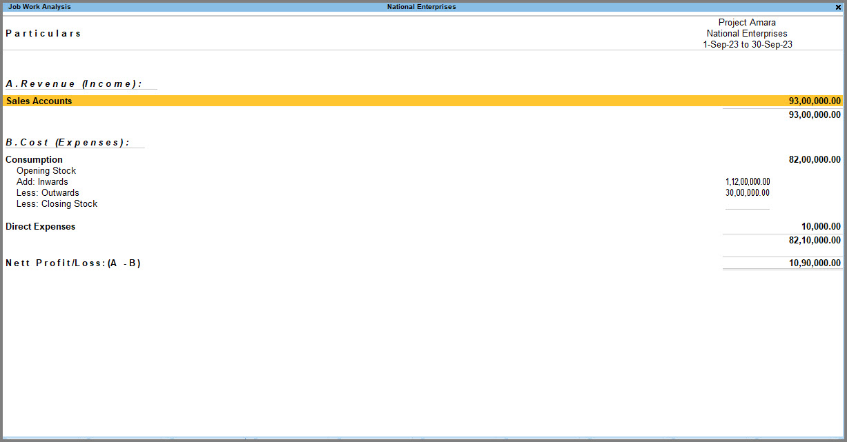

Job Work Analysis Report
Job Work Analysis is a detailed report of the finances involved in the completion of a project which will help you in determining the Nett profit or loss of your business. With this report, you will be able to maintain a proper track of the cash flow and ensure profitability of your business. It will provide you with a detailed breakdown of the costs and revenue associated with the different phases of the job or project. This will ensure that you make informed decisions about allocating your resources and finances in a project.
  1. Press Alt+G (Go To) > Job Work Analysis > press Enter.
    Alternatively, Gateway of Tally > Job Work Analysis > press Enter.
  2. From the List of Jobs/Projects, select the job or project that you wish to analyse, for example Project Amara.
    The Job Work Analysis report appears, as shown below:
    Job-Work-Analysis
Any form of direct or indirect source of income is listed under Revenue (Income).  Similarly, any direct or indirect expenses incurred while completing the project is listed under Cost (Expenses). The Nett Profit/Loss section indicates that this project has generated profit for your business. You can now plan things around each financial aspect and control expenses while the project is still in progress.
Note: Cost centres enabled for job costing will be available for selection in the Job Work Analysis report.
Ctrl+B (Basis of Values): The report is set to appear in the Default Scale Factor. However, you can alter the view of the Amount section by selecting from the List of Scale Factors.
Ctrl+H (Change View): You can view related reports such as Monthly Summary, Breakup of Job/Project and Job/Project Summary in this section.
  • Monthly Summary: The report will display a month-wise summary of the cost and revenue involved in the selected job/project.
  • Breakup of Job/Project: The breakup of the costs and revenue will be displayed according to the Accounting Groups involved in the job/project.
  • Job/Project Summary: An overall summary of costs and income of the job/project will be displayed.
Ctrl+J (Exceptions Report): All the Negative Ledgers can be viewed under this section.
Alt+C (New Column): You can track and compare the Revenue, Expenses and Nett Profit/Loss by defining the columns as per your business requirements. You can press Alt+A (Alter), Alt+D (Delete) and  Alt+N (Auto Column) to set columns on a weekly, monthly and so on, basis as well.
To know which project has garnered more profitability than the other, you can compare the Nett Profit/Loss of both the projects side-by-side. While you are viewing the Job Work Analysis report,
  • Press Alt+C (New Column), enter the From and To dates and select the project or job with which you want to make the comparison, for example Project Prestige.
    Job-Work
The report displays both your projects side-by-side in a columnar format. The comparison indicates that despite selling the same quality of granite tiles to both the clients, at the same rate, Project Amara is a more profitable project than Project Prestige. This can be accounted to the overhead charges levied in the latter. With this information, you will be able to decide that investing in which project turned out to be more profitable to your business and how you can cut costs for upcoming projects.
To know more about reports in TallyPrime, refer to Working with Reports.
